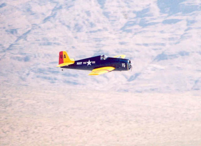

A few pictures of my Hellcat on it's first day of flight.

HELLCAT 716,
That is beautiful. I love that in-flight shot with the mountains in the background.
Did you completely strip and recover then re-paint or did you keep the original covering on and paint over it?
What engine are you using? I see the Pitts muffler, that looks cool.

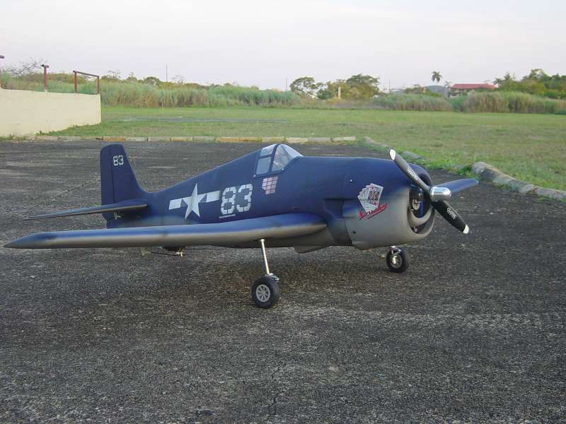

Corsair Jock Saito seems a bit tight for this aircraft, strongly recomend 1.20 you wont regret it..
Specially if you want to go scale with a 3 blade prop..
I am flying mine with a SAITO 1.50 , which is a bit overpower. Thinking on putting a 1.20 and using
1.50 for another project that would need that much power.
Here are some pictures taken on Maiden Flight 3 weeks ago....

I am using Sierra Percision gear. The plane was recovered and sprayed with a flat clear. I am using a YS 120 with a graupner three blade prop.
