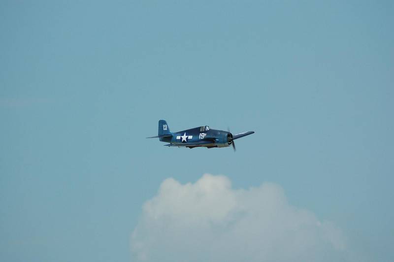

So I've been flying my Hellcat on electric conversion this fall. It's been flying great and even won an award at a Military flyin. However at another flyin yesterday it nosed over on the rough field and my Zollner canopy is now cracked up and missing a chunk.
So does anyone have one they will part with or know of a good alternative other then the stock one I still have? Any help here would be great.
Here are a couple pics of my plane.

Electric conversion! Give up the details man. What motor, batteries, and speed controller did you use?

I'm using a Scorpion 4015-12 motor with a APC 16x8 prop. Power comes from a 8s2p A123 pack. You could use 6s lipos though. I run a Castle Creations 110HV controller as the amps could reach 90 if I moved to a 16x10 prop. I just wanted the overhead in case I get that high. Run times are around 6-8 min when running closer to full throttle. But if I used lipos I would probably double the run time per flight as I'd need two 6s 5000 mah packs to get the balance down. However with the A123 packs I can recharge and be ready to go in 15-20 min.
