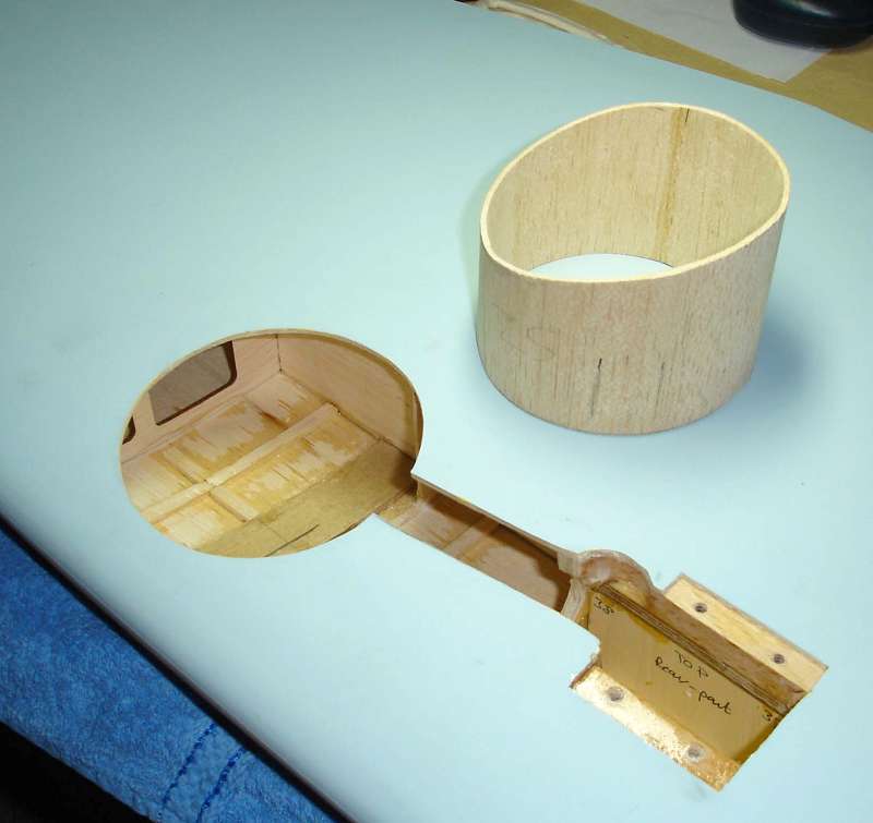

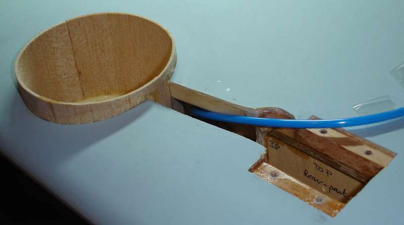

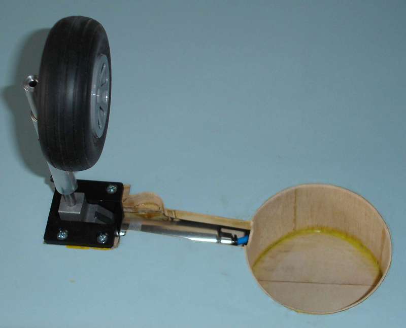

I have been following this thread with great interest since I am in the middle of building this model too. I am now just past the 'which-retracts-to-choose-and-how-to-get-them-in-there' question. I went for Large Eurokit with Unitract struts connected by a 6mm steel rod.
Our field is rough grass, a real retract-killer, so I wanted something fairly sturdy. My opinion is that the stress of a hard landing has to be taken up somewhere, and the steel rod is supposed to be the 'weak' link here - if the surrounding areas are beefed up enough.
I didn't like the looks of the plastic wells and binned them - their fit is too tight, and if they are not cylindrical the wheel can easily get stuck if the setup is bent slightly. With a cylindrical well either it gets in (and can get out again) or doesn't and won't get stuck.
I will try to attach a few pictures, hope it works!
[img][/img] [img][/img] [img][/img] [img][/img]
Henrik.

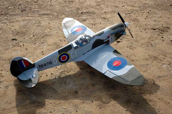

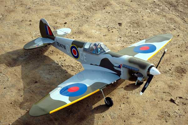

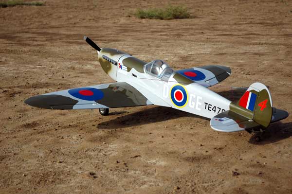

well....at least it looks much better than these horible ARF`s
Y'know, some of them aren't all that bad as the pictures make them out to be. The second picture is a Phoenix .40-.46 size Spit, and its amazing scale except for the undercart with its wheels in. But the hardwood brace is so solid that retrofitting true scale retracts is going to be a breeze. Apart from that, this is one of the most scale looking Spits I've seen in the ARF category. And it helps that its a great flier. I had an OS FL-70 engine in her, which was a lemon (idling at 4000 rpm, dying after a minute of idling, max rpm of 9800, missing in inverted flight, but that's another thread) and I now - temporarily - have an OS 50 SX with a 12x8 APC prop in her (until my YS 63 gets delivered) and she does screaming low passes with immaculate handling. Great takeoffs, great landings.
She's just 5 flights old, and I think it's about time for that ugly landing gear to go. Scale retracts, here we come.
Here are some pictures of how she looks on the ground right now.

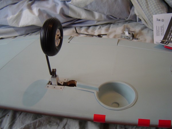

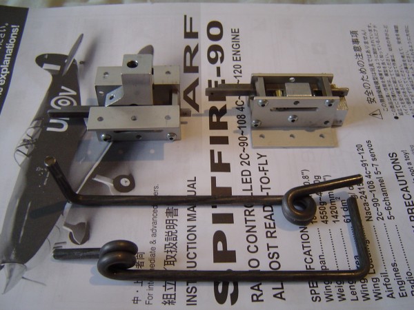

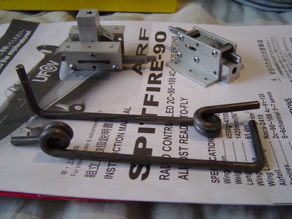

Woohooo.....alomst 4 weeks after I ordered the retracts, and they are here!
Better dust off the spitfire

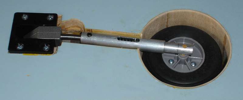

only need`d some slight trimming of the wood to make them fit.

pls. let us know how it goes - strength and all. btw can you pls. re-write the part number as since the site is in Germany I cannot seem to find the part.
regards
Joe

you need two of these: ezf-100mk2 90 euro in total.
But lets se how thay do first
if they can take the weight of the 26cc gas engine, then it should take my 90 size and weight even better......i hope :-)

Wes, no, I did not add the extra wood.
I think im fine, it doesn`t weight that much. If I was installing that huge 26cc gas engine, i would beef them up for sure!
They did not just drop in. You have to cut a hole in the wing rib for the pushrod to go though....like on their pics. Also, I had to remove a bit of wood from the mounts themselves because the screws that assemble the retracts stick out too far. But this is very minor. I also has to remove about 1mm of skin for them to fit properly. The 75mm wheels are a very tight fit in the wheel wells.
My struts where bent very very little too much forward. I just opened up the wheel well a bit more at the front, and slid the plastic well a little forward about 1,5mm Still small stuff :-)
Im pleased with them They look very steady. Time wil tell if they hold up to my grass field
