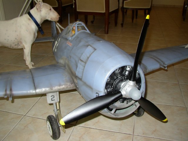

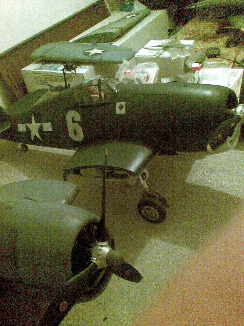

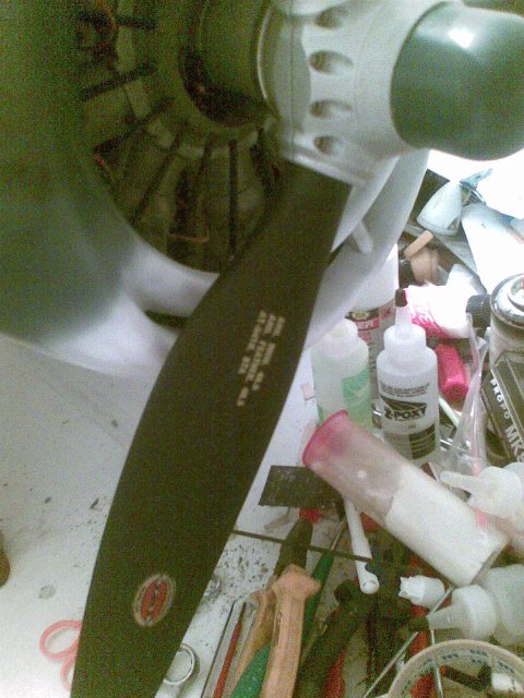

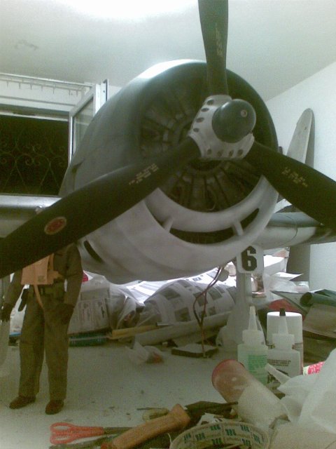

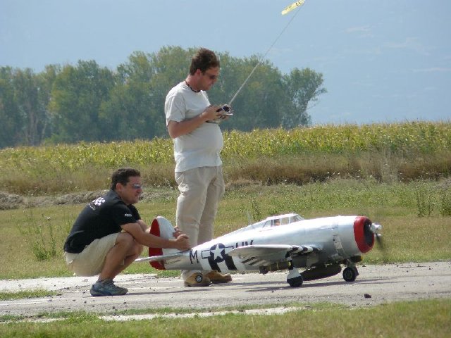

Hey Wayne</p>
</p>

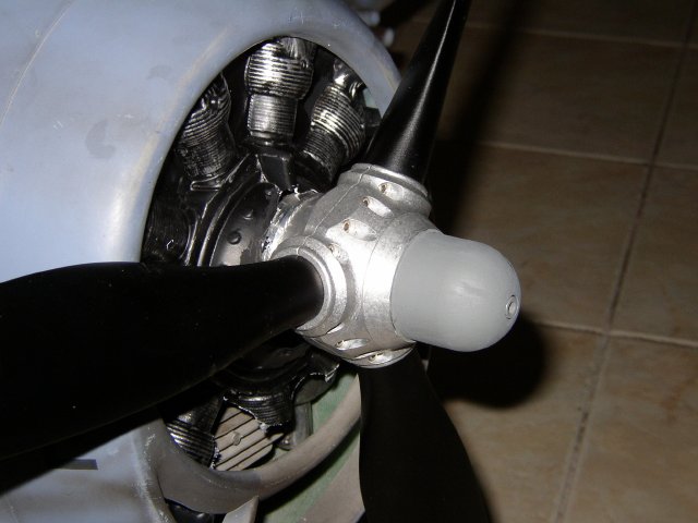

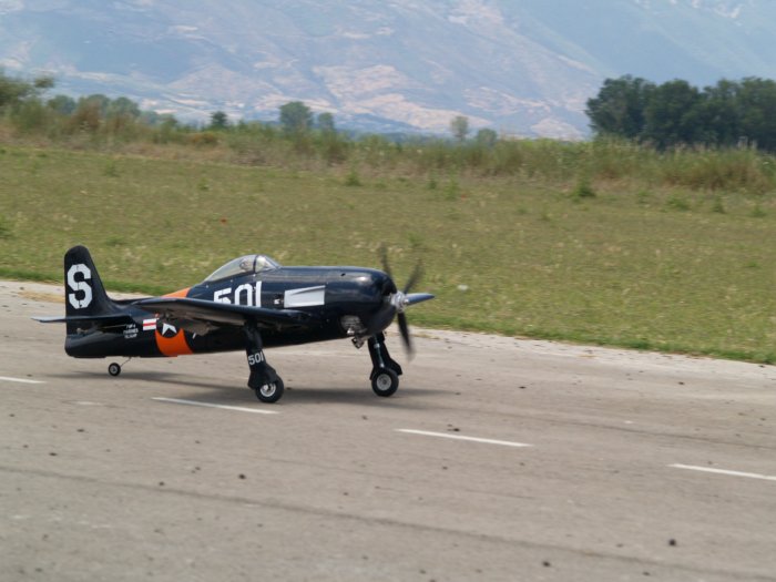

Glad to hear that the solo's have a new home. Welldone mate. Like that I can tell you that you have at least 3 users of soloprops in my field that are definately your customers by now.
I post a few pics of the models that we fly in my field.
I have also a 4 blade square tip (p-51) with hub for my new Fiberclassics P-51 Mustang. Also a 4 blade with hubfor my TFG P-47 Thundrebolt , and 2 more 3 blade props + hubs for my Hellcats.
I will contact you for spare blades since I have to keep some stock here to have the fleet "warworthy"!
All the best to your future endeavours!!
J.R.</p>

Impressive photos JR!
What is the engine you have in the P-47 &amp; the Hellcat?

Thanks Fly2XS for your commpliments.
The P-47 is running a ZDZ-80 cc, while the first Hellcat is running a Zenoah 62 and the second (VF-1) is running a 3W 85cc.

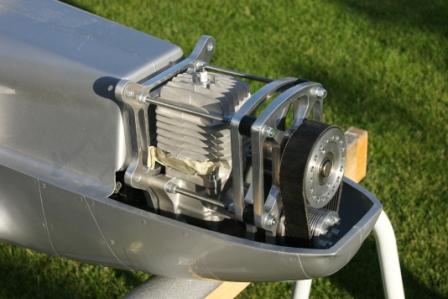

Hi
This is what my reduction unit looks like so far. I am building it for the c-arf p-51, and I am planning to fly with a 4 blade solo 30" p-51 style, It won't be long before I am ready for a test run. I am curently producing the hub between the driven pulley and the prop.
Best Regards
Jan

Jan,
That is a work of art! What a clean & well thought out installation.

What size is the motor? I'd be skeptical of it's ability to turn a 30" 4 blade prop... That takes A LOT of motor. I ran a 24" 3 blade on my G62 with prop drive.... Probably need twice the motor (or more) for 30" 4 blade set up.

Hi
Well, I don’t know if it will work. I have done some calculations with the mvvs power prop calculator, found on the website of mvvs.nl, and in theory it should work.
The engine is a 3W 80 Xi with 8,5 HP. If it can run a 26x12 at about 6000 rpm, it should be possible to reduce it to about 3500 rpm with the reduction unit. The pitch on the 4-blade should be at around 18-22, and that is the beauty about the solo prop, it is ajustble.
Best regards
Jan

I agree with oesterling. You don't need more power to turn a bigger, multi blade prop, you need to reduce the rpm and increase the torque and pitch. I have done this several times with my home made scale props.

Agreed!
In my BT Spit I had a motor capable of four times the power, but that was to reduce the RPM and have enough torque to drive the prop with higher pitch. I could have used a smaller motor combined with a reduction drive.
The current draw, and power consumption, was the same as other 83" electric BT Spitfires.
Stian

You do need more power to turn a [/i]substantially[/i] larger multi blade prop. It may be that the 3w 80 is enough motor if a 26x12 2 blade prop @ 7000 rpm = 30x24 4 blade prop at 3500rpm... but my WAG is that your talking about 3x the prop with a 2x advantage... My Zero above flew about the same as another similar size warbird I had with a direct drive G62. IIRC we flew it with a 22X12 2 blade vs. the 24" 3 blade with (of course) more pitch (can't recall exactly, but I think it was around 20" on the 1.75:1 torquemaster. 26" blade set also worked ok, but 28" was too much prop; couldn't get enough rpm's X pitch. Hope I'm wrong, just being a devils advocate here. You can always go down in dia, say to 28, and it will still look cool!
Currently considering a planitary drive to turn 4 blade props on my electric XP-67 project. Love the cool factor of scale flying props.

Why do you need more power?
The power needed to move the model is given by the models characteristics, and the effiency of the prop..
If you want a given speed on a given model you need a given amount of power, split that power on the efficiency of the prop and you have the needed power from your motor. There is no reason to claim that a bigger prop is less efficient, on the contrary, bigger props can move air more efficient than smaller ones.
What it does require is more torque, both to drive the size of the prop and the higher pitch of the prop. I did this with a larger electric motor, but it might aswell be done with a reduction gear. To try to use fairly the same pitch as the small prop and drive it at the same RPM would make the large one less efficient and you would require more power.
If the power needed would increase with a bigger prop, how come my Spitfire with 4 blade 24" Solo and a Spitfire in Britain with a 2 blade 20" APC have the same current draw in flight? If any difference they where to my advantage..
Stian
