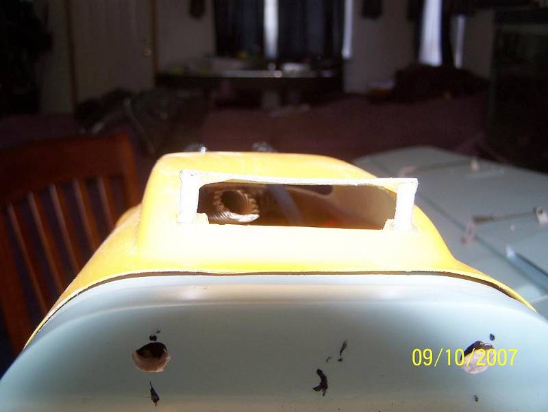

Hellcat56 the CMP comes with an ok plastic spinner, but if you know the scale shape of the spinner it may fall short of the look you are familiar with. The spinner at the backplate is 5.693" dia.
Eric
Just trying to move air around in the engine compartment.
Yes I did drill holes. Can't hurt. If you do the same avoid drilling at the engine mount location. I have done the same on all my other in line engine airframes and my engines don't overheat. I am also going to open the chin scoop oil cooler and drop the flap at the back of the chin cooler as well.

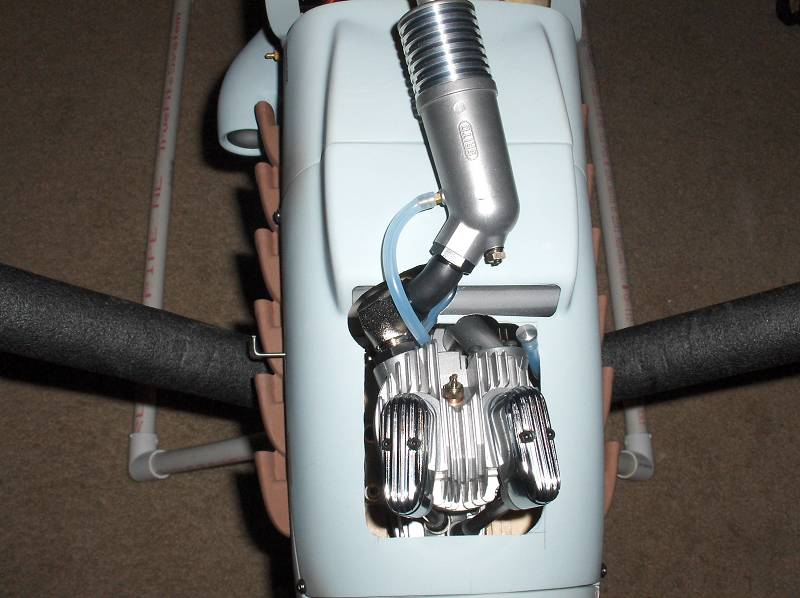

Ok, so here is what I came up with for the engine installation, the only problem is I'll have to remove the muffler before I can open the hatch. I should have the gear here next week. I bolted the engine directly to the wood and reinforced the top and bottom of the engine mount. Soo close...

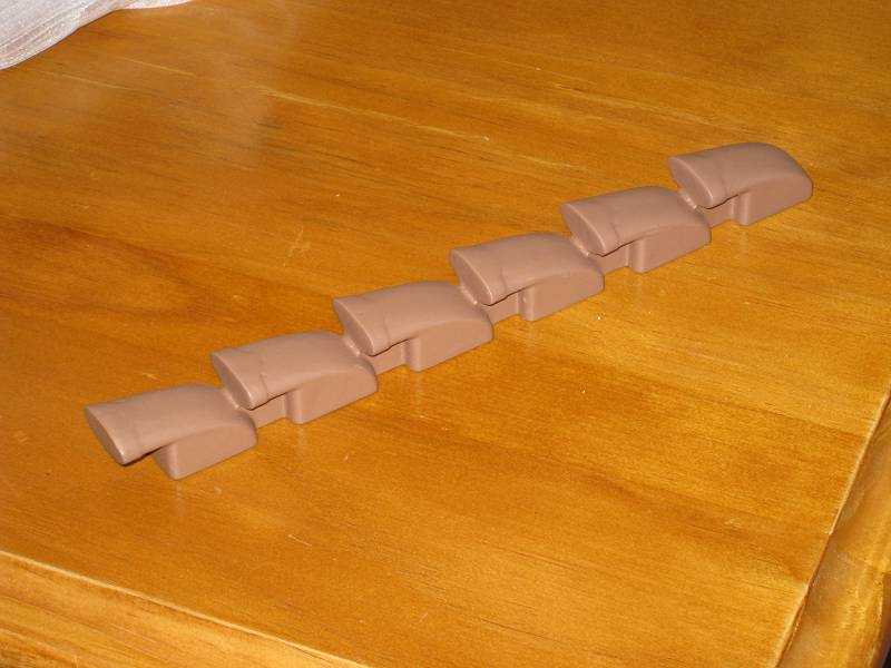

those big exhaust stacks you have to glue on each side of the fuse should give it away!

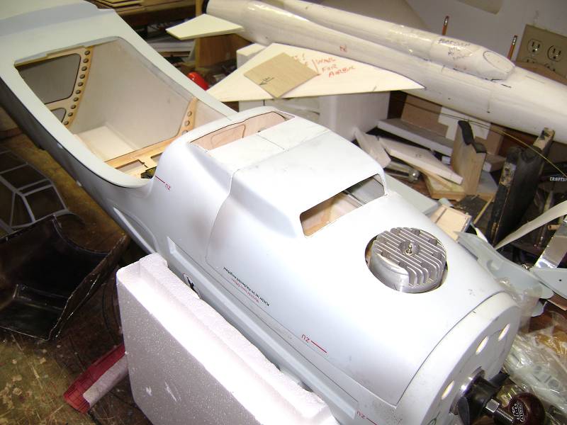

I did what our little 109F has for additional hot air exchange. I cut open the front of the scoop and opened the back. I'll put the scale like rear flap back on the scoop in an open position.
I may get the exhaust to exit at the back of the scoop as well.
May I offer a possible solution to your problem of having to remove your current muffler to remove the chin scoop hatch? Remove the 90 degree right angle adapter as well as the muffler your using.
Instead, use a flex pipe coming directly out the back of the cylinder where the exhaust port is. Route the flex pipe under the "chin scoop" and cut out a rear chin scoop flap.
I did this on the KMP Me-109. This would allow you to remove the chin scoop hatch and fiddle with the needles or do whatever else like changing the glow plug without removing the muffler and it would also clean up the appearance.
Please see pics for reference.
The flex pipe I used had a pressure tap on it so it did pressurize the fuel tank.
That looks good and I had considered this option but with the fire wall being so close behind the engine unlike the KMP kit, I didn't see a good way to make it work, mabey if I had drilled through the wall and ran the muffler through. My option works well I think but you know... It could have been easier... It's all hind site now and it's not like i'm trying to scale this one all out. I kinda just want to see her in the air and what works...works. Thanks though, I bought a second one and I'll do this mod on it.
