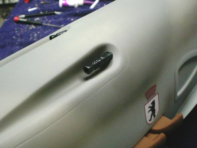

#313
RE: CMP BF109F BUILDING THREAD
Just thought I'd show another little scale mod I made. I took some plastic tube from the Hobby shop and chucked it up in my drill press. Using an Xacto knife and some sandpaper I made myself some scale guns. Here is a photo of the tubes before, and after installation. I used some gunmetal paint to finish them off (not even dry when the photo was taken).
