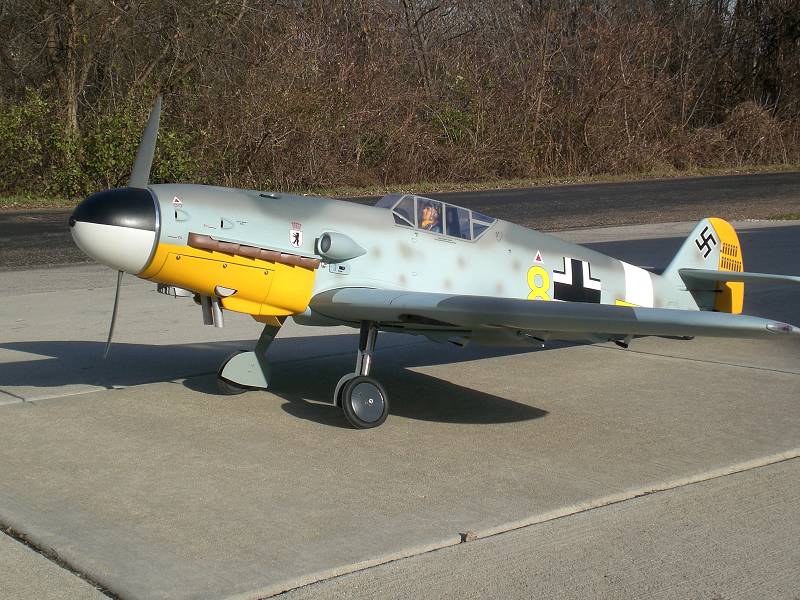

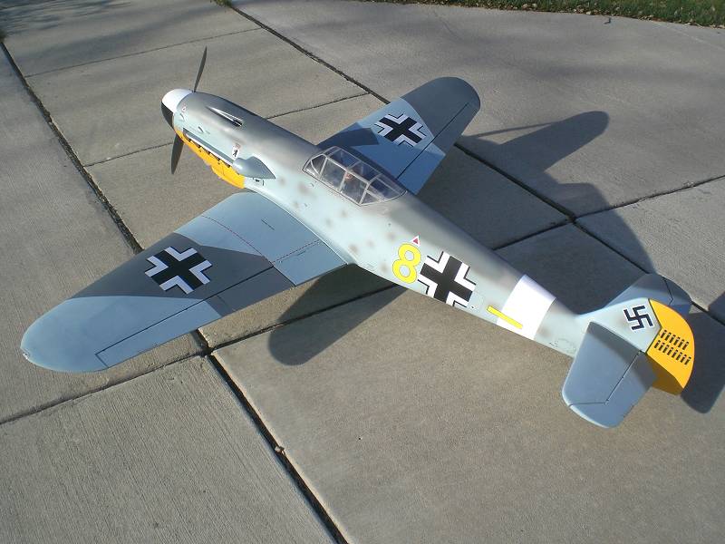

Had a nice enough day to get the 109 outside for some photos. Doesn't look too bad, considering it is not in the air yet. Notice the photo showing the flaps fully engaged. I don't know if I'll need that much drag, but it is available if I want it. It is on a variable knob so I can bring in as much as I need and make adjustments later. I should have moved the flap hinge line out a bit because they don't go down too far before they bind up.

Here are a couple more shots. I still have to move the battery back to balance it, but right now it weighs a bit over 14lbs.
I don't think it would be easy to remove the stock graphics without going into the paint. Can't say I tried it though. I have repainted CMP planes before, just sanded them a bit and painted right over with Testors cans, then coated the whole thing in Polyurethane. Very durable. My wing decals on the 109 are painted over with polyurethane, and you can't even see the difference between them and the stock flat paint. I also painted the yellow with testors, then coated with minwax polyurethane in the spray can (only use the oil base in the gold can).

I may have to try the Acetone to remove the decals. Those "8"s on the side just don't look right. Too light, too close to the cross. I think the white band is paint, so I should be able to get the yellow dash off without affecting it.
