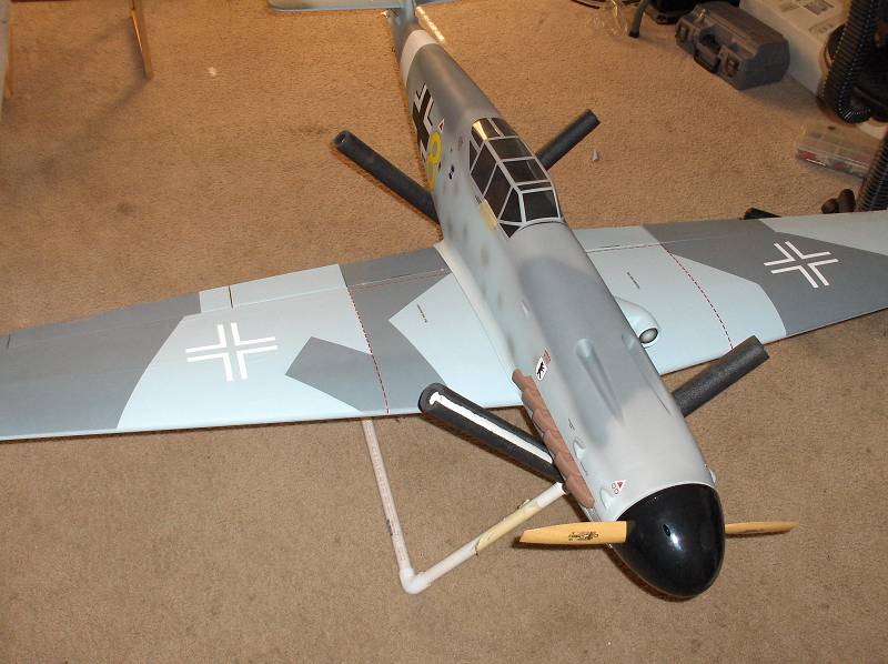

I've got my kit mostly built without the gear and the muffler which will be here wednesday
. It's a heavy beast which concerns me a little for those of you wanting to go smaller than a 1.6. I have the 120AX and I don't think it will be enough to enjoy this kit. I've ordered another to scale up and Im placing a Moki 2.10 in it.

The 120AX will pull it around but it may be a bit weak on reserve power. It's tuned for torque and not much of a revver (I have one). I'm putting an OS 1.60 with the inverted muffler in my BF-109 and I know it will have plenty of power. I have the same set up in my 86" Kawasaki Ki-61 that weighs 20 lb, and it pulls it around very well. Used a gun on it the other day and with a 17X8 prop it hit 111 mph. I'm thinking the 109 will be a bit fast for the 17X8, so I will be using a 17X10 to keep the engine from revving over 10K in flight. A Moki 2.10 may be a bit more than you really need, but you should have reserve power a' plenty!
Photo of the Ki-61
Photo of the Ki-61

The shock mount hardware that is included with the ARF is to small for the hole pattern on the OS 1.60.
I was considering cutting the top and bottom plates in half, ain't done it yet, just considering it. The holes are about 3/16" to narrow, plus the bottom plate has a recess for the screws,
Your thoughts?
THanks,
Bob Q.
Oh Omnipotent One,

I have access to a lathe, I plan to install the 4 screws and chuck it up by the base plate. Center drill and then drill a 3/16" hole ( for the scale 20MM canon), in the nose . Remove the spinner, and use your prop balancer. Achive proper balance by spinning the spinner, and when it stops, marking the the bottom, (AKA), heavy portion of the spinner. Then drill SMALL holes in the back plate until, when you rotate the spinner, so the holes are 90 degrees from vertical, and release it, the spinner does not move when released. Now do the same thing with the prop, only don't drill holes. Add small amounts of epoxy to the tip opposite the heavy blade. The other option is to rent one of the spin balancers , from Hughes Aerospace, that they use to spin balance satelites. They can balance down to a gnats eyelash. It shouldn't cost more than a new car.
Bob Q.
Bob Q.

I just ordered one of the BF-109 spinners from Dave Platt. It has an aluminum backplate. I have a friend who has one, and it is the same exact size as the one provided by CMP. If the one from Dave is truly the same as his I will be in good shape. Some type of very long spinner nut will be needed to keep that large cone centered. Dave does not provide the adapter with the spinner. The spinner costs $50 + shipping.
BQuartucy: I noticed also that the vibe mount does not work on the OS 1.60. I believe by just putting the rubber provided between the engine and the wood mount it will center the engine shaft in the cowl opening. The two stroke does not vibrate quite as much as those big 4-strokes, so I don't think a full isolation mount is really needed.

I have decided to put my OS 108 in this model. I have seen larger models fly well with this engine.
On the Os 160 and the rubber mounts. In regards to the alum flat stock mounts. I figure I would get longer alum flat stock and drill the correct hole space. And counter sink as original.
But my bigger concern would be the Os 160 raised portion of the engine mounts on top. Will the rubber be gouged by the raised mounts. Another concern is the bottom alum plate. Will it sink into the ply after a few flights when fuel soaked??
HR Todd
Your going to love that spinner. And its still pretty close to the same price. Please post a pic of the backplate to fuse section for us to view.
On the spinner bolt. After prop is securely on, I use an alum hex stock ( brass hex if you need nose weight) drill and tapped for the engine shaft and the spinner bolt you use.
Its best to pic your bolt first and fabricate your adapter to size. Use thread lock, avoid over tightening spinner. I have pic of what I mean if you need.

1. Cut the 2 bottom plates in half. They only serve as spacers and are used to set the heigth of the engine and center it vertically.
2. Fabricate 2 plates that are the same thickness as the raised bosses around the engine mounting holes. Drill 4 holes in the new plates,centered on the engine mounting holes,
the holes should be large enough to clear the bosses so the plates sit flat on the mount lugs.
3. Place the 4 elastomeric pads on top of the new plates.
4. The 2 new upper plates sits on top of the pads.
5, Assemble as follows:
a. Gather the 2 pads that have been cut into 4 pieces. Put the countersunk screw thru the plates and put the 4 screw/plate ass'ys up thru the 4
mounting holes of the engine mounting lugs.
b. Place the new spacer with the enlarged holes thru the 4 screws resting on top of the mounting lugs.
c. Place the elastomeric pads on the screws protruding up thru the engine mounting lugs.
d. Fasten the new top pad over the screws and fasten/tighten the lock nuts on the screws until contact is made with new plate.
e. Insert the 4 standoffs up into the elastomeric pads.
f. You are now ready to mount the engine to the 4 blind nuts with the 4 long bolts and washers.
Bob Q.
