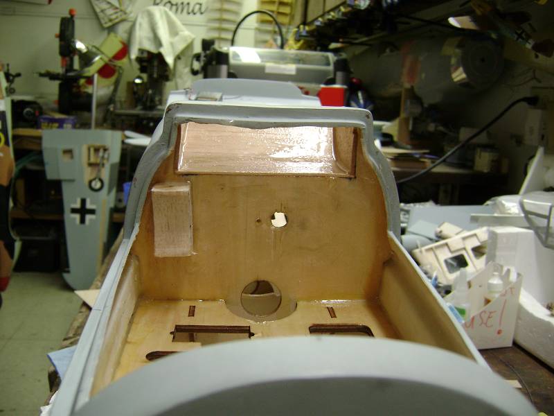

Default RE: CMP BF109F BUILDING THREAD
Hi All
Heres what I had in mind when I cut the rear of the chin scoop open.
Sealed entire engine area with 30 min epoxy resin as well.
Steve

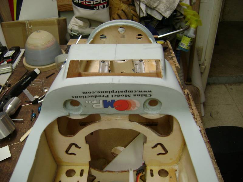

And heres the back of the scoop.
Steve

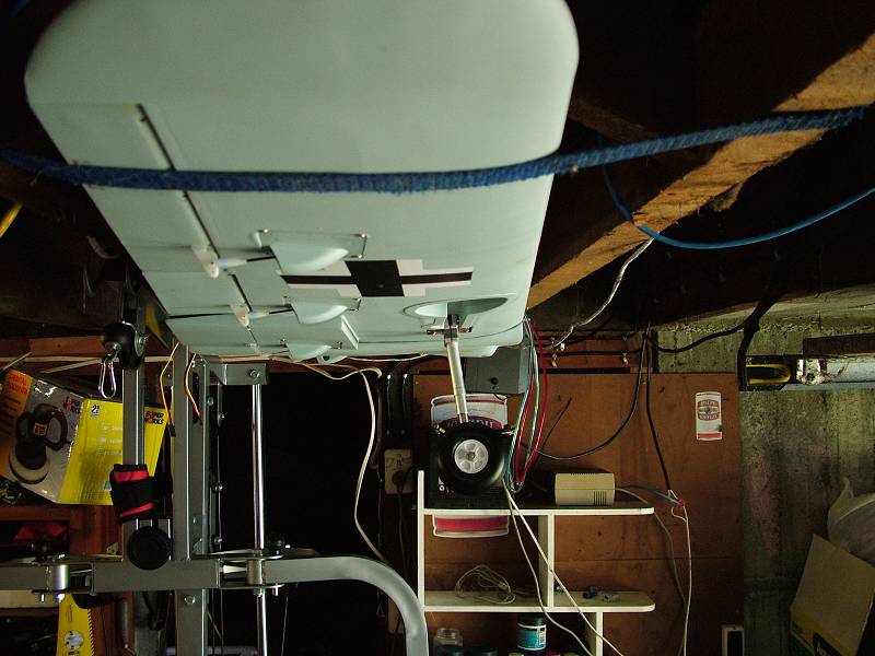

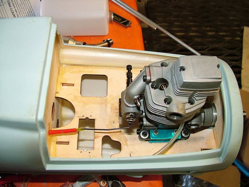

well I decided to not put the throttle servo into the engine bay, TOO HOT!!! the wire looks a little worse for wear but thats just the camera angle it has an offset at the engine end, I used a solid wire threaded through a set of gold n rod also someone asked where the serria retracts sit when down?
