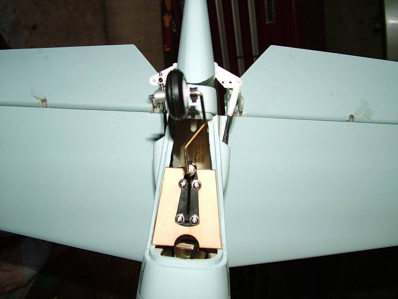

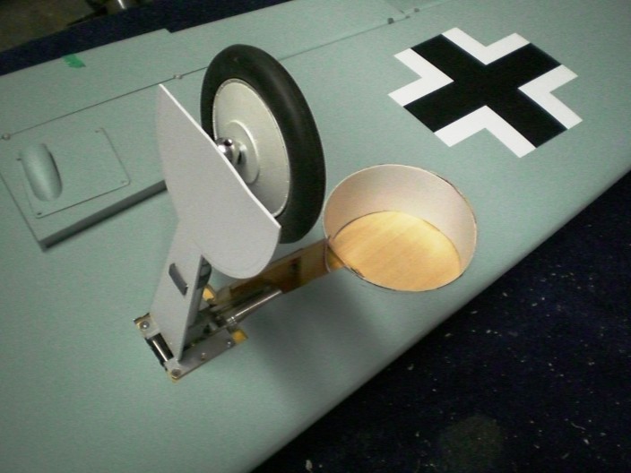

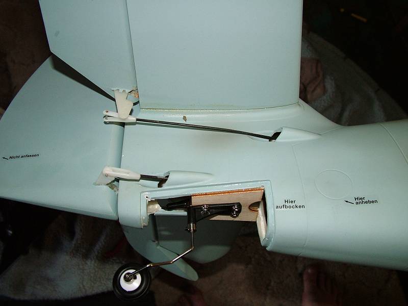

Default RE: CMP BF109F BUILDING THREAD
see photo one show a solution I am thinking of, photo two shows the balsa rod supports, rest are obvious.... now photo one should provide a straighter run for the rods, the bulkheads I really dont like either as the rods are "ribbed" and you feel the running through the holes...
