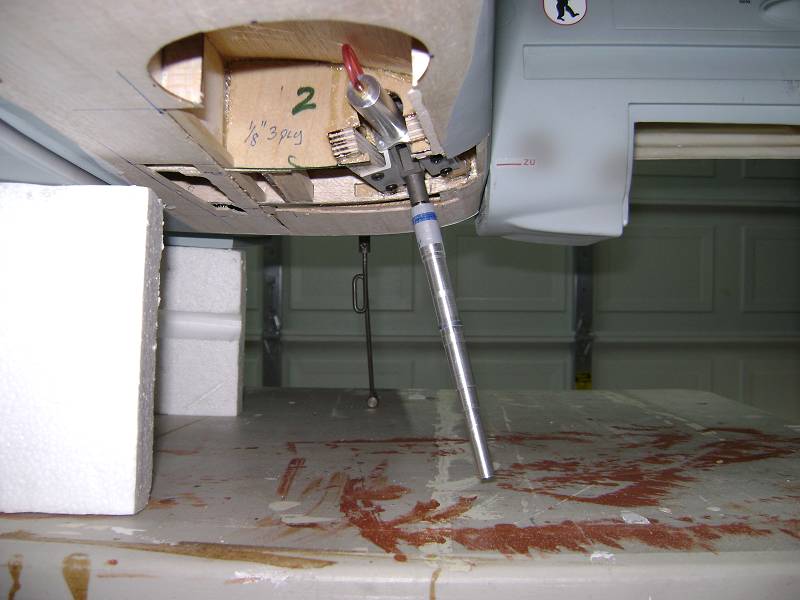

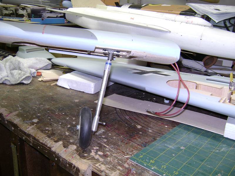

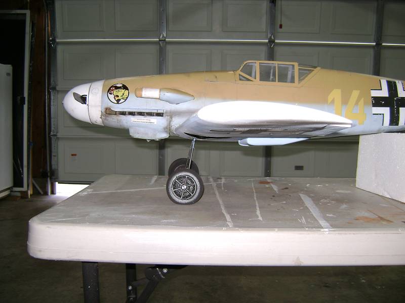

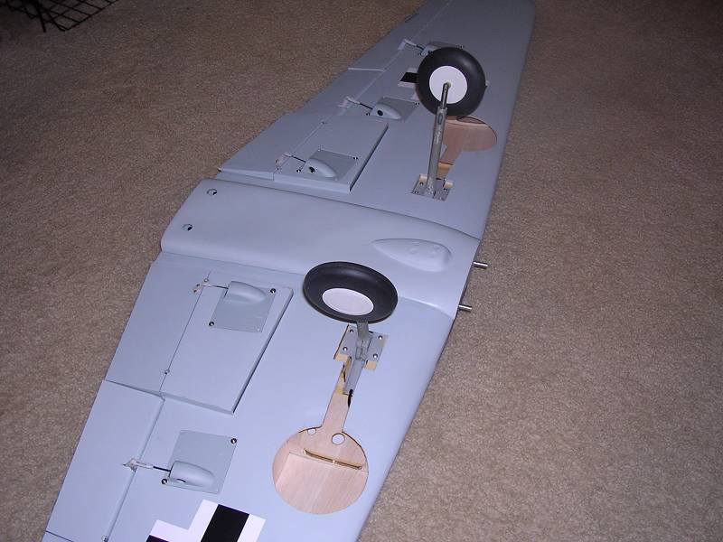

Hi All
Just posting to show the difference in LG position from CMP and what I did.
Also the fabrication and flight of (along with crashes) of the Yellow 14 109 is what has led me to do the LG for the CMP.
Now that I look at our small 109, I could have used even more forward rake. Oh well on the next one.

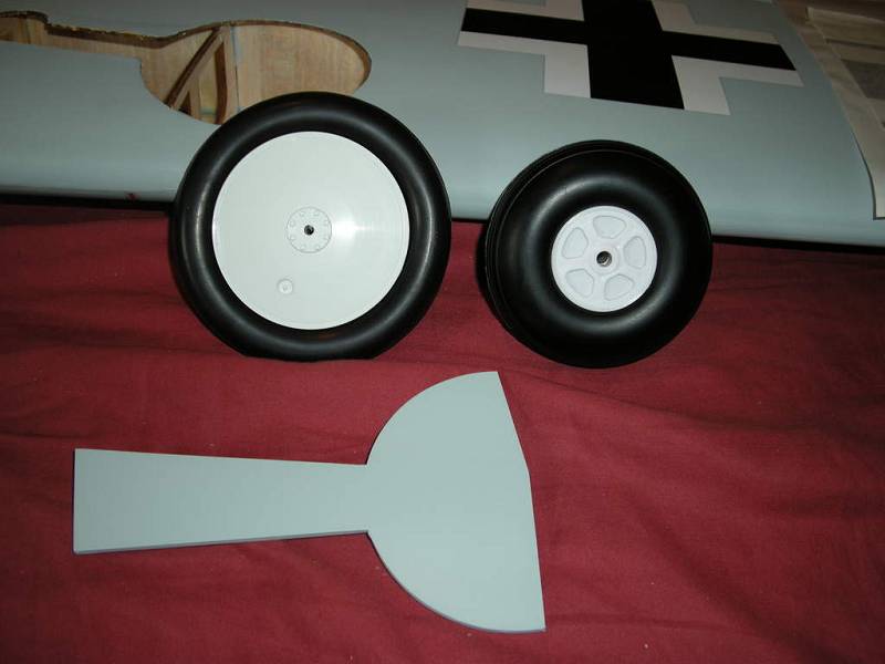

I believe the alum is 6061 solid rods from IPS, El Monte, Ca. They are remnants and sold by the pound. I would get a bit larger than 1/2" and turn it down as needed.

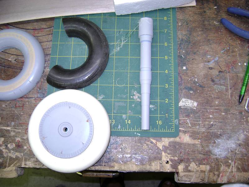

Since tires are being mentioned i thought I would post a pic of my 1/5.0 scale LG set up I am one day going to use on my 80" 109 G2-6. The tire/hub is a test run of a concept I tried years ago to make tires/hub ourselves.. Really hard and heavy 60 shore rubber. But we have a pretty good idea today of what should work.
Timed out will try later
Oh, before I forget, CMP is not known for getting the CG right. The diagram shows the CG a bit to far back for what I normally use for forgiving flight. Use what you know works for you in the past on warbirds.

My Feedback: (13)
Pic of the tries at a scale tire/hub/strut for a true 1/5 scale 109G that I made a few years back for my composite 80" span G version.. A bit large for this cmp model, but if I like the way this model handles, I will make a few parts for it as well.
Steve

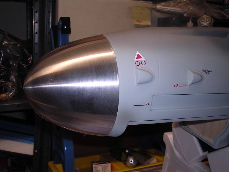

Spinner looks nice. That's the one they sell for their 80" BF-109? Sells for like $125?

you mentioned in one of your posts that 1/2" dia .al. for the gear might not be large enough. What is the major diameter of the gear that you have shown in the pic?
Bob Q.
#220
My Feedback: (13)
Bob

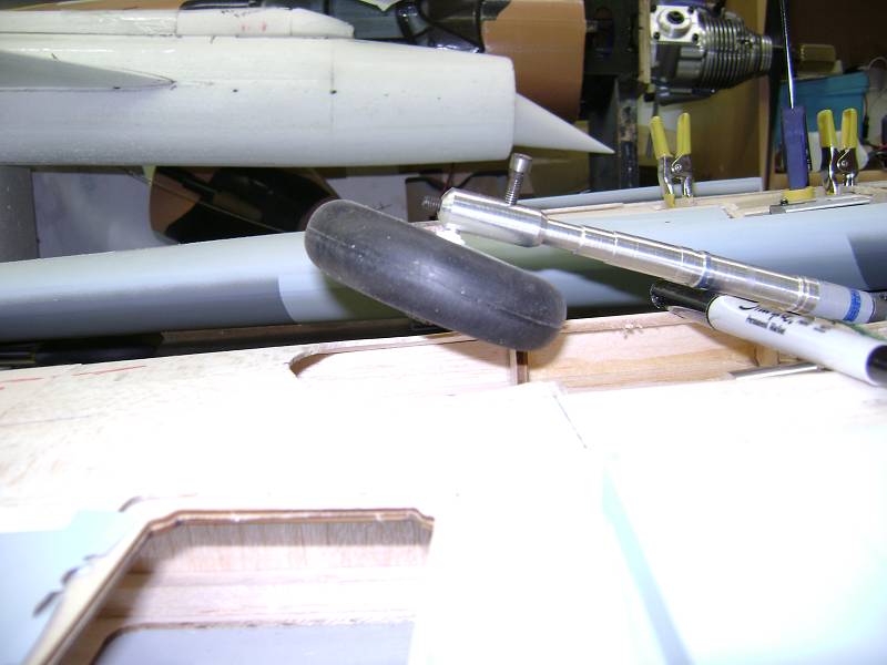

The alum rod should be .625" (5/8") .
A pic of the concept I may use to put my tire/axle on. A sleeve on the strut. Of course the set screws will be hidden. Or I could just drill the strut and avoid a sleeve.??
Note the pic of the wheel geometry near the well. The scale (+, - ) angle on the axle to the strut, along with the larger wheel is the reason why there is a hump on later versions 109 wing.
The wheel is a 3.25" williams brothers ballon tire. For a test flight, they will work.
Steve
