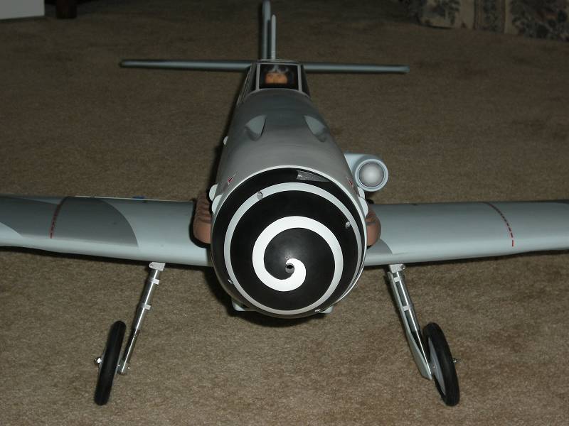

I've seen your Tony before and it is awesome! One of my all time favorite Japanese army aircraft. Do you think it would be possible to enlarge the wheel wells on the 109 to fit a bigger wheel setup?
I beg to differ with the previous answer , Larger wheels are possible Not flown yet.....but, I have built this CMP 109 using 4 3/8 wheels...... It required a bit of trimming but it will work and it actually functions good adding precious scale height and improved taxi stability on a grass field.
I have a set of 4 1/2 scale wheels on order.......... I hope to Squeeze another 1/8 inch out of the well. If not , maybe on another set of wings.

So Freddie, does that mean you are getting 4.5" wheels to fit with no mods to the wing spar? The thickness of the wheels is also a problem as they larger out by the leading edge of the wing. If you open up the wing and change the mounting points of the wing, I would call that "major." When I said no way to 4.5" wheels I meant without "major" mods.
As for the Split flaps, radiator flaps, whatever you want to call them, I would recommend that you cut them out and glue a wood block in to support the control horn. It does not take much to rip them out of the balsa if you don't do something to make them stronger.

Hey Fearless,
Can you post a picture of the bottom of your wing? Also, are those the drop-in SG retracts?

Fred
Nice Spiral!
Steve
