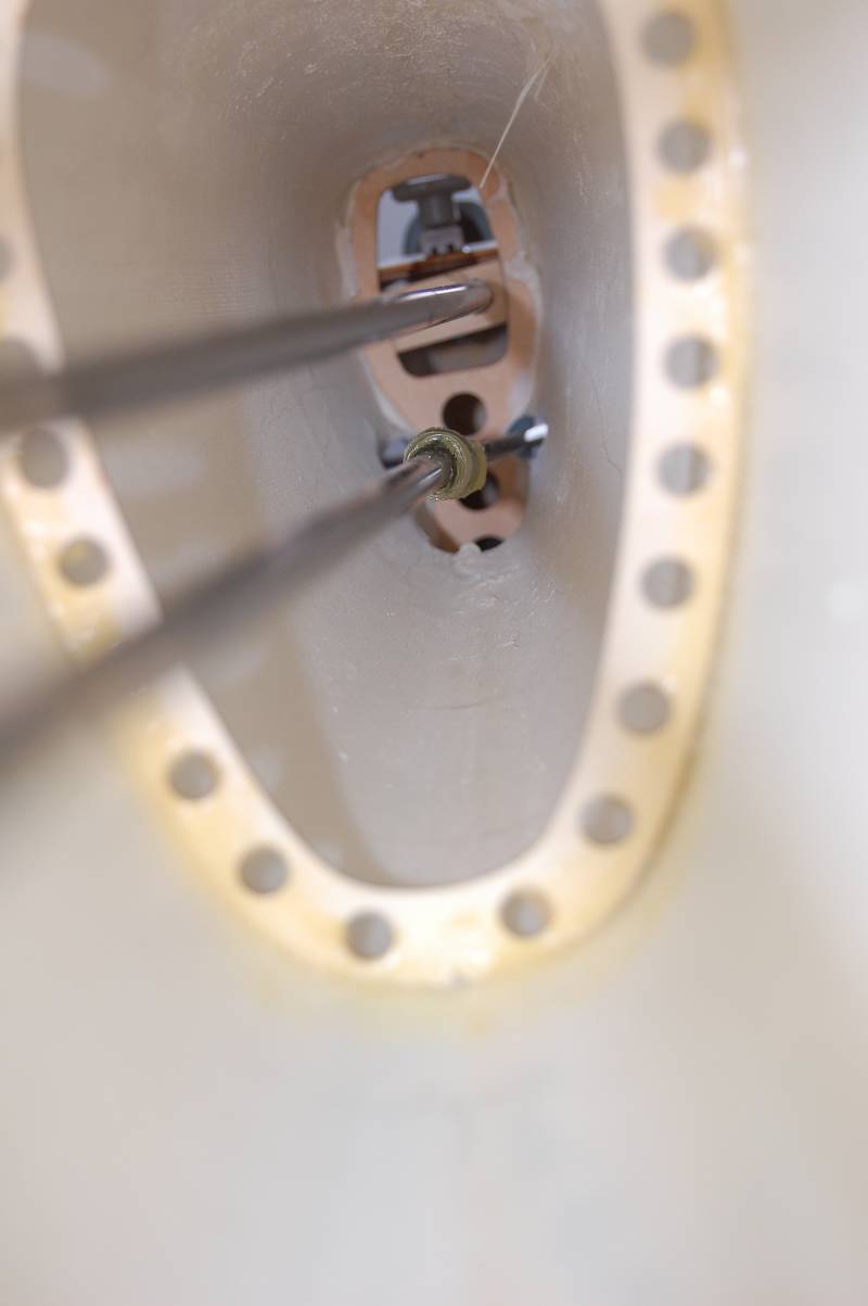

Here's a thought, you might be able to put the control rod in without taking the elevators off.
1. The control rod goes in the holes where the inboard hinges are (were) installed. If you look closely at the pics you can see this.
2. You can cut thru the hinge and pull out the hinge half in the elevator and grind off the half in the stabilizer.
3. Only do this if you can deflect the elevator far enough to put in the leg portion of the L shaped rod with the thru the holes aft of the stab in the fuselage. This will probably reqire that the leg is fairly
short say 1/2" or so. If I were doing this, to be on the safe side I would insert a piece of brass tubing 1" long super glued in place to spread the load out.
4. Before you put on the control arm attach the 4-40 connector to it so all thats left is to thread the push rod to the connector.
5. When the rod is in the fuselage put the control arm on and continue to push the rod thru and out the other side.
6. After one elevator is attached, bend the second leg so it lines up both elevator halves.
7. I would then put several drops of superglue to bond the rod to the tube. Then fill in with epoxy MAKING SURE THAT THE ELEVATOR HINGES LINE UP.........
If up have any questions feel free to ask.
Bob Q.

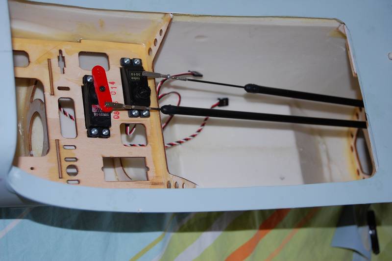

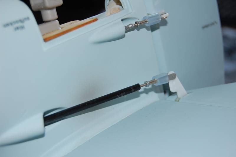

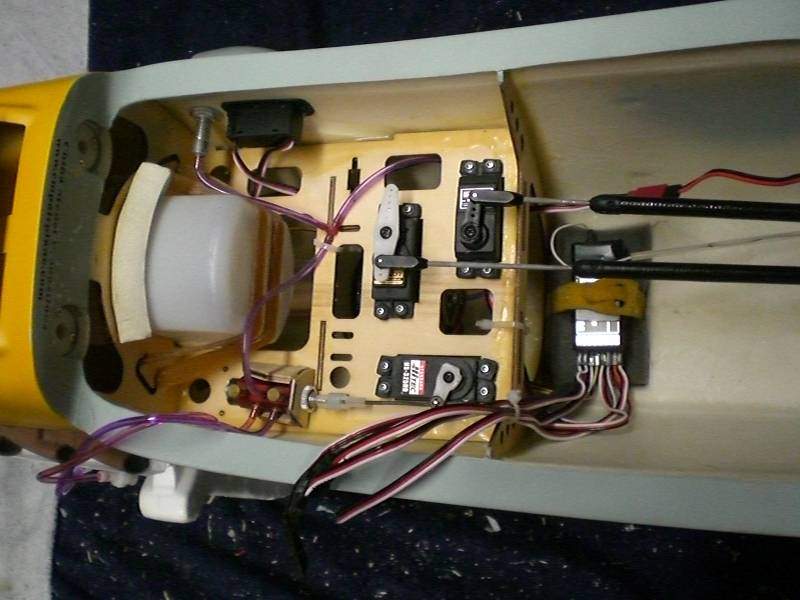

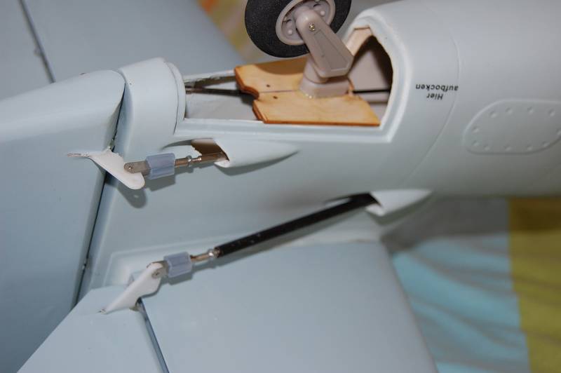

Hello guys,
Here the pictures of the control rods wich I used. I replaced the kit ones with carbon rods. They don't flex at all. The elevator is driven by the Y setup. Only I replaced the steel Y with carbon ones. For the connection I used the metal rods and the supplied connectors. This was glued in the carbon rods, and strengthened with glas-fibre and epoxy.
The tail wheel was replaced with an earlier on this forum advised Hobbycity one.
I hope the provides pictures makes all this clearer.

Todd,
There are different ways to get to Rome I think. Your solution certainly has its advantages, but takes quite some modefying. Weak point in every link stays the lengt of the steel rod used at the ends. Specially when you have to bend it a little, there is always some play. In this plane , one can use a perfect Y with carbon rods. The are no other angles needed. Thats why in this case the Y connection with carbon can be used without play at all. I now only have some play on the rudder, because the steel rod part connected to the servo is too long, or the carbon rod too short for that matter. I'ts clear when you see the attached picture. The advantage of the carbon Y-rod connection, is that apart from the rod itself, there is no modification needed. That can be usefull for the lesser experienced builders among us.
It's clear however that the provided system with the nylon rod, and the Y-part of 8 inch lengt of steel rod certainly has way too much play.
