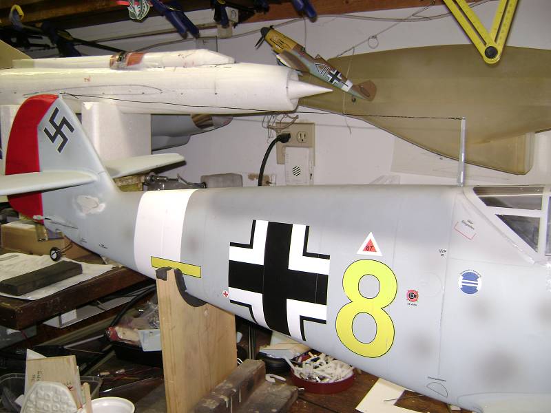

Don't laugh ,but I had a minute and decided to make an aerial for the radio. Have to make the little cones still and get an elastic black thread.
hope i don't break it off before the next flight.

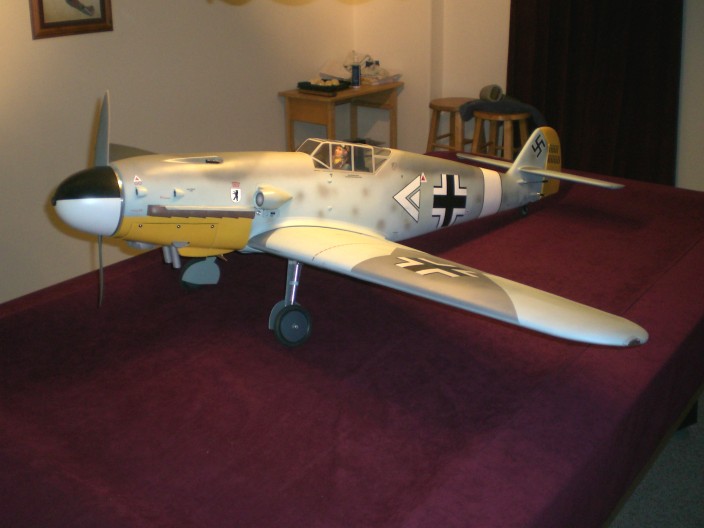

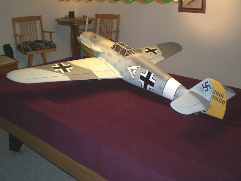

Good to know the function of the radiator coolant flaps, but I will use them as air brakes to make up for the lack of a full split flap. For those that fix the top surface, I'm sure that would still be an effective way to slow the plane down.
I did try the acetone to remove the decals, and it worked well. Took off the wrong colored yellow decals and added a "double white chevron." Nice to have one that looks a bit different than the others. I'll have to get it outside again for some more photos, but until then here is how it looks on my pool table.

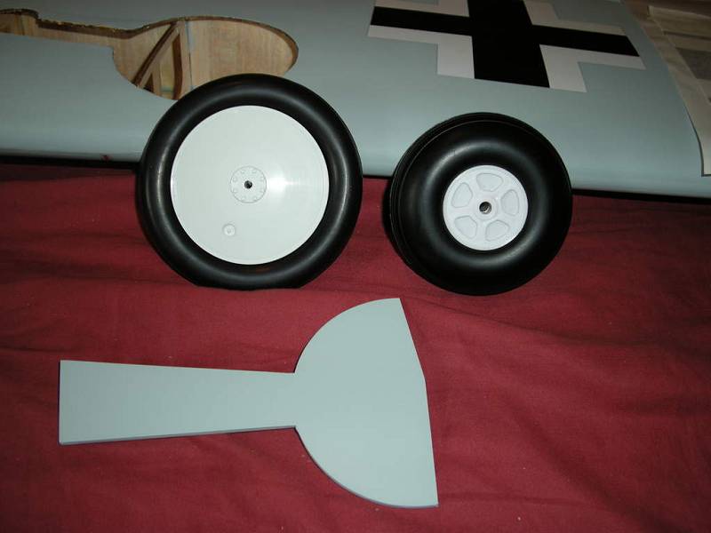

Hot Rod Todd, your ship is looking great. Still can't decide whether or not to get one of these. The gear looks a little short, did you notice that as well?

Yep, the gear looks short, the wheels look small. No way you could fit scale size wheels in the wing, and to make the gear scale length it would have to come out from the fuse (like scale), and the wheels still would not fit. As with many ARF's, the gear is good enough. The good part is that by having the plane sit a bit lower it will ground handle better. The stock wheels are so small that everyone who saw the plane would say "wow, those wheels are tiny!" I can live with "the gear looks a little short." It is unlikely anyone could do enough mods to make the gear look correct on this plane, so I'll live with it and enjoy it.

I used the Williams Bros. 3 3/4" wheels, and even they are a tight squeeze. It would be hard to go any bigger without major mods to the wing. Keep in mind the stock wheels are 3" and look tiny on a plane this size. (see photo of comparison, williams bros. and stock)
To be scale they would have to be around 4.5-5" No way they would fit.
