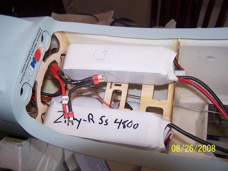

Here's the component cost for this CMP ME-109
Turnigy 6364 230kv motor: $63
Turnigy 100amp HV esc: $100
Zippy-R 5s 4800 x 2: $99 each
The two batteries are run in series for a 10s 4800 setup
So, $362. A saito 180 can be bought for about that price....so...price wise its a wash. As such, I have to disagree with the arm and a leg cost comparison because it isnt at all. Now, sure, either wait 1 hour for the batts to be recharged using two charges(which I already own anyhow) or buy a 2nd set of batts to fly while the first set is charging....which I also did.
So, you can add $198 if you want to the cost, but, that isnt really part of it to get the plane in the air. $362 is what it'll take.
I do agree in the short term, glow is cheaper to have mutiple flights per day as it costs about $30 for a gallon of 30%. So a saito 180 with 1 gallon of fuel cost is $410, but you can fly several times in one day. However, that gallon wont last all that long and you might get 10-12 flights out of it depending on how well broken in the 180 is and how big a fuel tank is in the plane. Also keep in mind for the cost for the saito 180(or any glow motor) is that you have to break in the motor with at least 2 gallons of fuel before ever flying it(or you should anyhow). So, add another $50 to the cost since one would probably use 15% for the break-in period to keep costs down slightly. So, now we're at $460 for the glow motor option just to get the plane flight ready(not including whatever servo you use for it....so another $20)
So, as I illustrated, it doesnt cost that much to do an electric conversion compared to running a glow motor or gas motor if you know where to buy the stuff from. I can see, obviously, if someone were to buy FLightpower or TP batts, that it would be extremely cost prohibitive for most ppl since a comparable 5s 5000mah TP battery is about $250 each. But, using decent Zippy-R or Zippy-H batts, motor, and esc from Hobbycity considerably lowers the cost. An e-flite 160 costs $170 and a CC 110hv esc would cost about $279 so if you use the BIG name brand stuff, your gonna pay out the nose. But it doesnt have to be done that way and Ive used Turnigy motors/esc's in the past with no problems.
In any case, an electric powered CMP ME-109 is gonna fly A LOT faster then any glow or gas powered setup and fly for about the same amount of time....6-8 mins. I know my KMP ME-109 with a saito 180 in it and an 18oz tank can only fly 7mins before running out of fuel. I know as I had to run the tank dry and deadstick the plane in as the throttle servo linkage crapped out at full throttle.

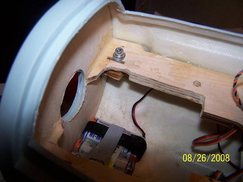

got some work done on the plane today
All switches, air fill chuck,retract air valve, shunt switch, etc are all contained in the cowl area. The chin piece will be removeable of course and held on with with a good deal of rare earth magnets(perferable) or screws like shown on the box.
The rx battery is all the way up right under the motor itself. It is a 2700mah 6v nimh. I am thinking about using 2 of these considering the amount of servos that will be in the plane. I will wait till the plane is done and checking balance to see whether I need to put it up front like the other one is.
Although it would be nice to be able to change batteries without removing the wing, my batteries are quite big and putting them up in the chin area wouldnt work and I wasnt so keen on cutting such large holes through the rear bulkhead where the ESC is mounted on in roder to slide them in and out through the chin.
I am sure Coastwatcher on RCGROUPS will decide to do that though.

Hi Kahloq,
I have been lurking but not posted here yet. That looks great but I have a suggestion....
I have cut the inlet to the chin scoop out on mine and the ESC (I have the same one as you) will fit flat in that area such that ram air will cool it. I am going to cut a scale exhaust slot at the back of the chin scoop and dremel a slot in the firewall for the air to pass through the firewall. I am going to glue some t-nuts to the scoop and mount the ESC on screws to this with rubber supports to keep it in the airflow and clear of the scoop bottom.
I have trial fitted it all and it will work.
What receiver are you using? I am on spectrum too but I would be a bit nervous about putting it in the nose with all that current and bulk. I was planning to fit mine in the wing with the remote receiver in the fuse.

Its a 2.4ghz JR rx, so no EMF wont be an issue, however, I will be installing a 36" remote extension in the 2nd plug on the main rx though just to be safe.
The chin scoop will be opened up where the stupid black fake sticker is. This will blow air directly on the esc and is the reason i put the esc where it is. I noticed JE Johnson replied before I was able to submit this post so this answers his questions
I am still working on getting more throughput for air from the front area to the battery compartment to expel as much air as possible. I will also attempt to make the dummy exhaust stacks functional(to the point of opening them up to allow air to get out).
The esc is not blocking any stock hole in the bulkhead either so its not covering anything plus I drilled addtional holes in that bulkhead...one is directly behind the esc and one to the left of it.
