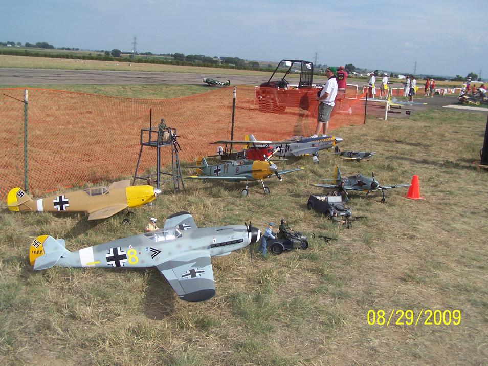

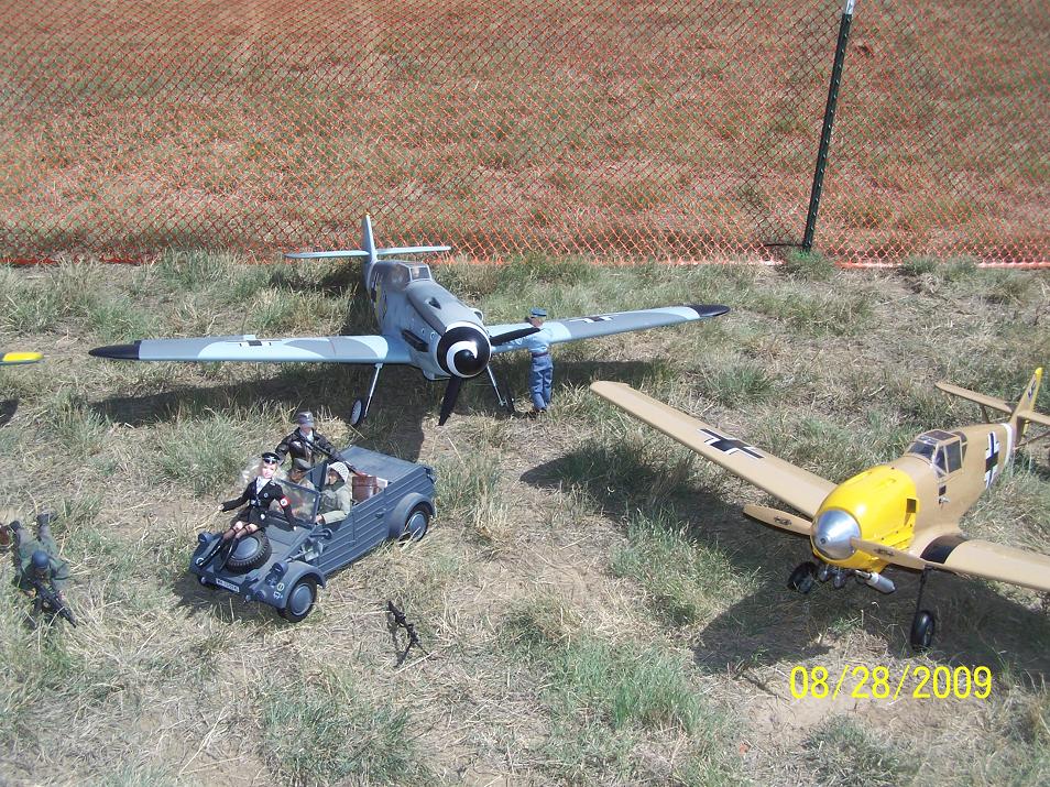

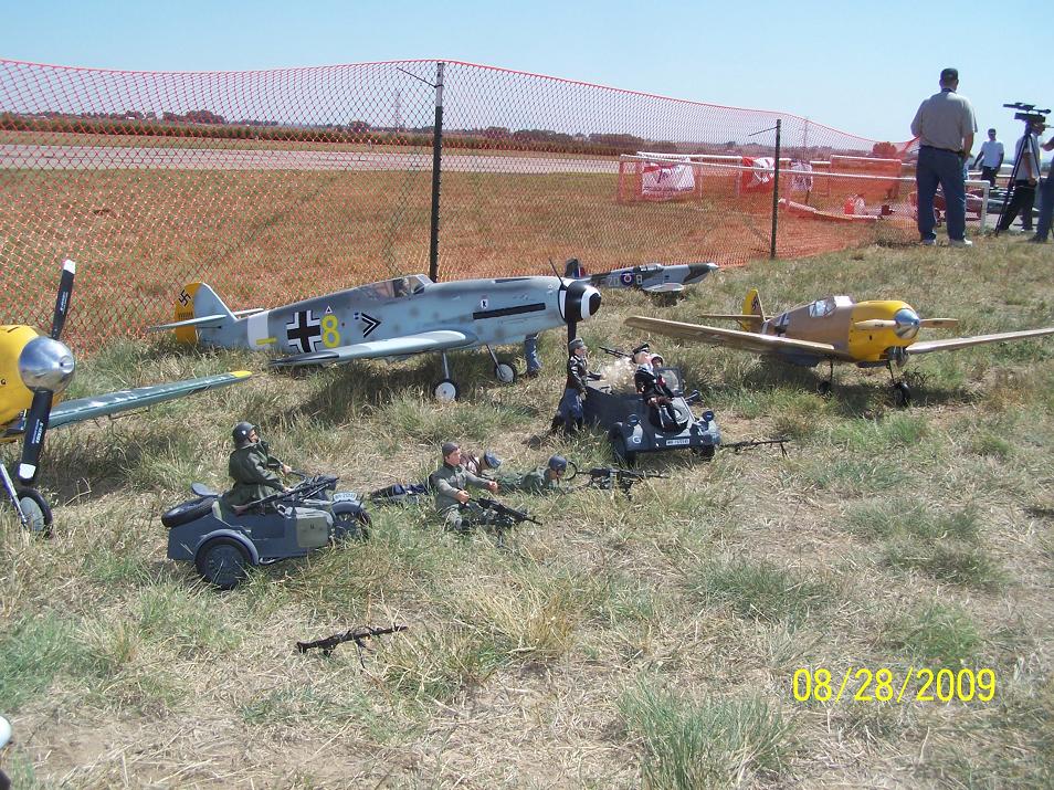

Well to try and shed a little light relative to the gasser not so good for this plane....lets look at mine. Sure its an electric, but I'll explain where the weight is.
I've got the electric motor and the ESC as well as the retract valve and servo all up front. Additionally, I have the RX battery snug up against the very front of the plane just behind the forward firewall where the spinner backplate is up next to....so basically as far forward as possible. This is a 6v 2700mah nimh. I also have a 6c 1500mah nimh for the flaps sitting right behind that rx pack. So, think of the footprint of the gasser motor inside the nose. All of my motor/esc/servo/rxc batteries are located in the nose in the space a gasser would occupy.
The point is, the overall weight of those components is about what a gasser would be. My flight batteries(2x 5cell 5000 lipos sit over the wing on the CG so that makes no difference.
I dont think you'd have any problems using a gasser. There is plenty of room aft of the main servo tray to put RX packs, ignition batteries..etc. A simply ply wood plate glued to the fuse under the cockput should work just fine for this. I ended up making a 2ndary servo tray under the cockpit area because the main servo tray is used up by the 2x 5s 5000 lipos. If you did need to put an rx pack or whatever in the tail, it wouldnt be a problem either. there is plenty of room back there under the tail wheel assembly to located and secure an rx pack.
This plane only has a tendency to nose over if you set the CG further forward then 112mm. My first one had a CG of 108mm and it flew fine and landed well and not overly fast. It did want to pitch up a good deal with full flaps, but thats easily taken care of with an elevator to flap mix. I merely held in down elevator when landing it on the maiden. I did get a prop strike on the 2nd take off attempt though cuz the nose did want to over rotate a little. If you keep to the 112mm-120mm CG as listed in the manual, your shouldnt have nose over problems.
My 2nd one has the CG at 112mm and it seems much better. I did a 2nd one because I wanted to use a 3 blade prop and a different spinner(Dave platt) and it required a different motor be used due to that spinner requiring a bolt through the middle to affix the spinner cone.
Another thing you can do to lighten the front if necessary is to hollow out the exhaust stacks that CMP supplies. Stock they are pretty heavy. Almost like plaster of paris with a little fiberglass cloth imbedded inside. I hollowed them out somewhat because under them is where I hid the on/off rx switch, air fill valve, esc arming switch, and on/off switch for the battery for a matchbox i have connected to the 4 flaps. Now those exhaust stacks are held in place via rare earth magnets.
One last note...my FIRST CMP ME-109 weighed in at 17.5 pounds and flew fine with no problems in the air.

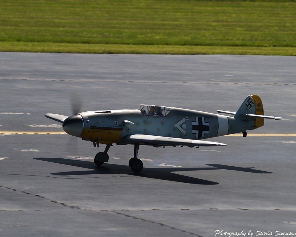

Depending on which gas engine you choose, it could be an option. The EVO 26GX weighs about the same as my OS 1.60 (add a few more ounces for the ignition unit and battery). I could see one of those working. The Zenoah G26 (engine only) on the other hand weighs about a pound more. You would have a challenge ballancing the plane with the extra nose weight using the Zenoah. The extra weight of the ignition on the EVO 26 would be countered by a need for less fuel. In reality you would likely run the same size tank, but would get longer run times. Power would be quite a bit less than the glow motor, but I normally run around at 1/2 throttle anyway to save fuel (and the plane will fly at 100mph at half throttle). I doubt the EVO 26 would vibrate any more than the same size glow engine. So to clarify I would say a light gasser should work just fine.
As for flying fine at 17.5 lbs, it might. I for one would not like landing the plane at that weight unless I had a fairly long and smooth runway. I take off at about 16 lbs, but with the fuel burn I land at closer to 15.
