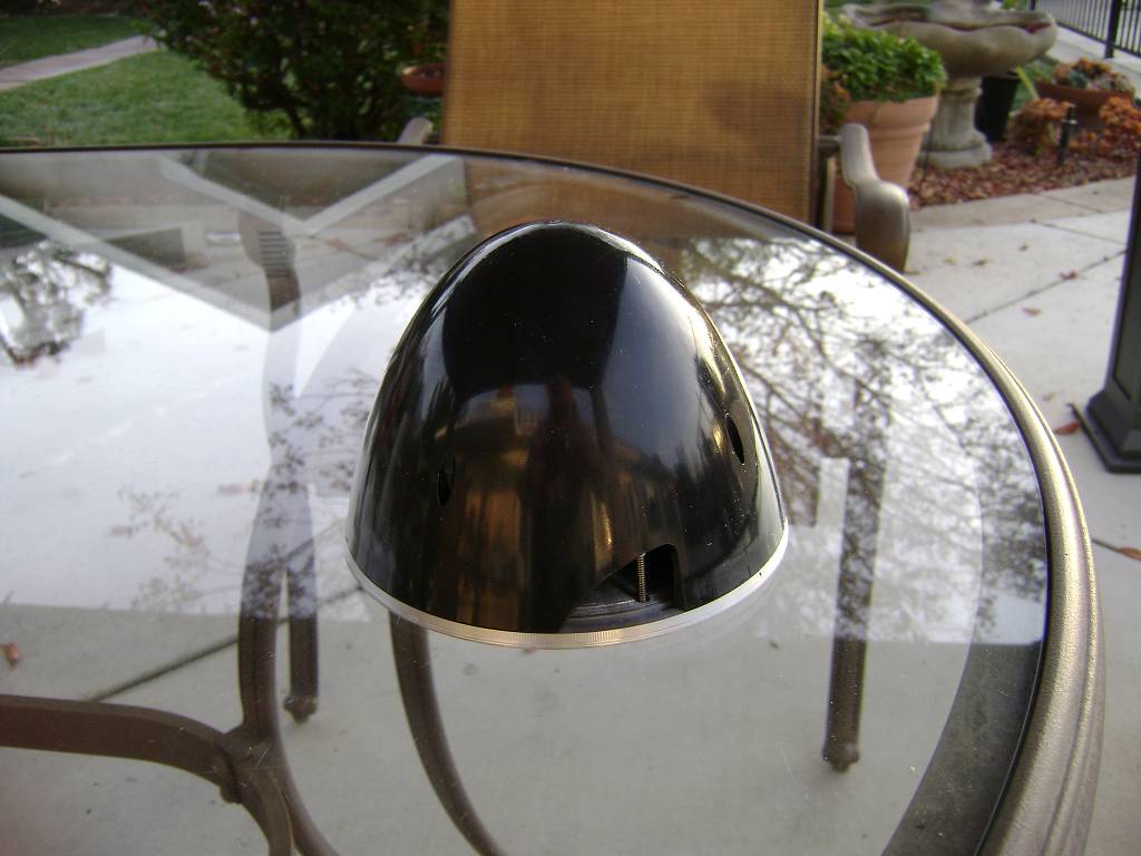

What spinner are you guys recommending on buying for this plane ?
Old 09-29-2009 | 10:48 AM
  #1328
SCALECRAFT's Avatar
My Feedback: (13)
Posts: 2,649
From: MONTEBELLO, CA
Default RE: CMP BF109F BUILDING THREAD
Fliteskin or Dave Platt.
Or you can turn a backplate and the use the original spinner. I use the original with an aluminum backplate.
Anchored by a center bolt to a long alum hex nut securing the prop.
Still, l keep all clear from high speed spinning items. No matter who or what its made out of.
Steve

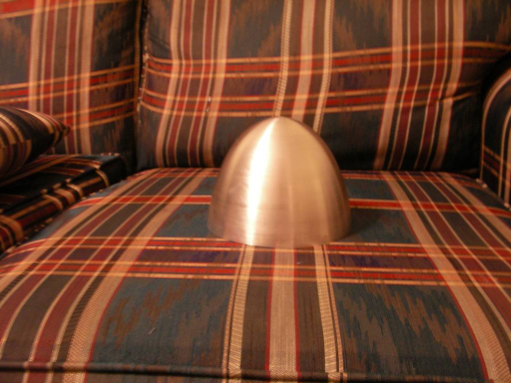

I am in the process of having spinners made just for this plane in the correct size. I expect the spinner domes here any day now. The backplates will be cnc cut with lightening holes to keep the weight down...
Here is a pic of a larger 109 spinner i carry...
Ty

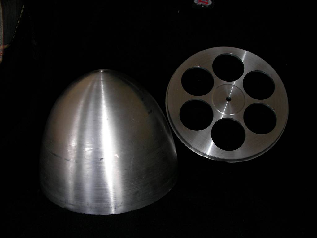

Ok guys,
I just got the Spinner domes in and they are right on the money size wise. The shape is right from a 3 view. I have 15 domes.
I have to go back and search through my e-mail and Pm's. If those of you who are wanting a spinner please e-mail me direct. If I have more than 15 people wanting 1 I will get more. I will check back through my e-mails to see who was in line if it comes to that..
The spinners will be $65 plus shipping. That is way under what i originally thought. I am taking these to my back plate guy tomorrow and he gave me a 1-2 week turn around for 15....

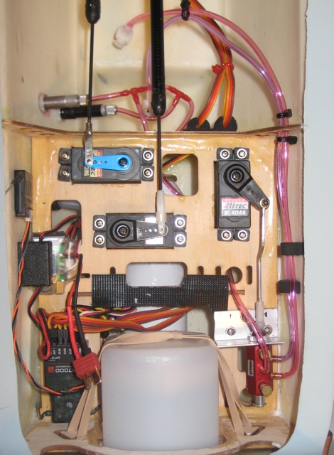

Build complete at 95 %. I'm wait for a 6 in aluminium Dave Brown spinner...
Saito 180 engine
Hitec servos
Robart air retract
Slimline pilot and pit muffler
[link]http://gallery.me.com/fetsou/100033[/link]

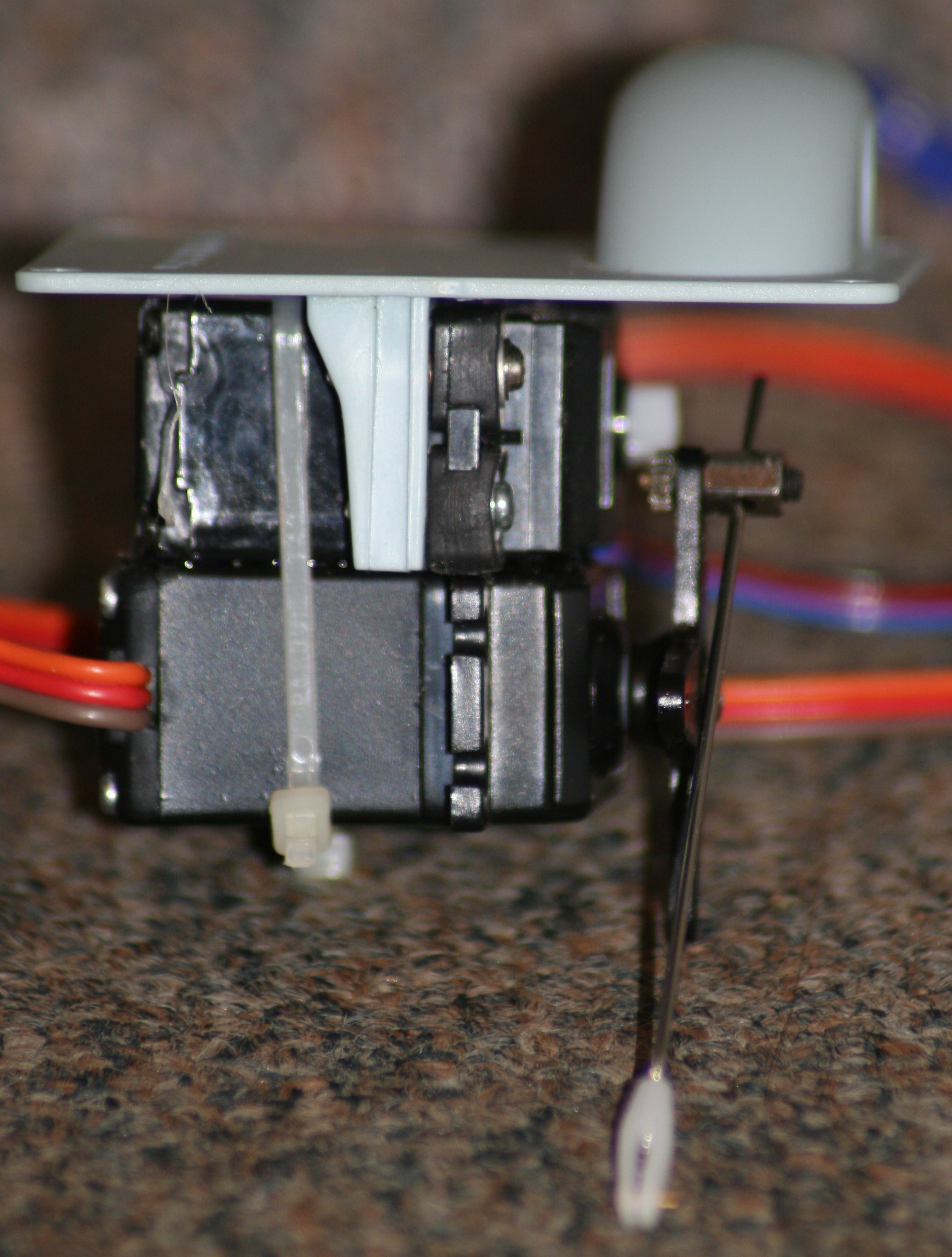

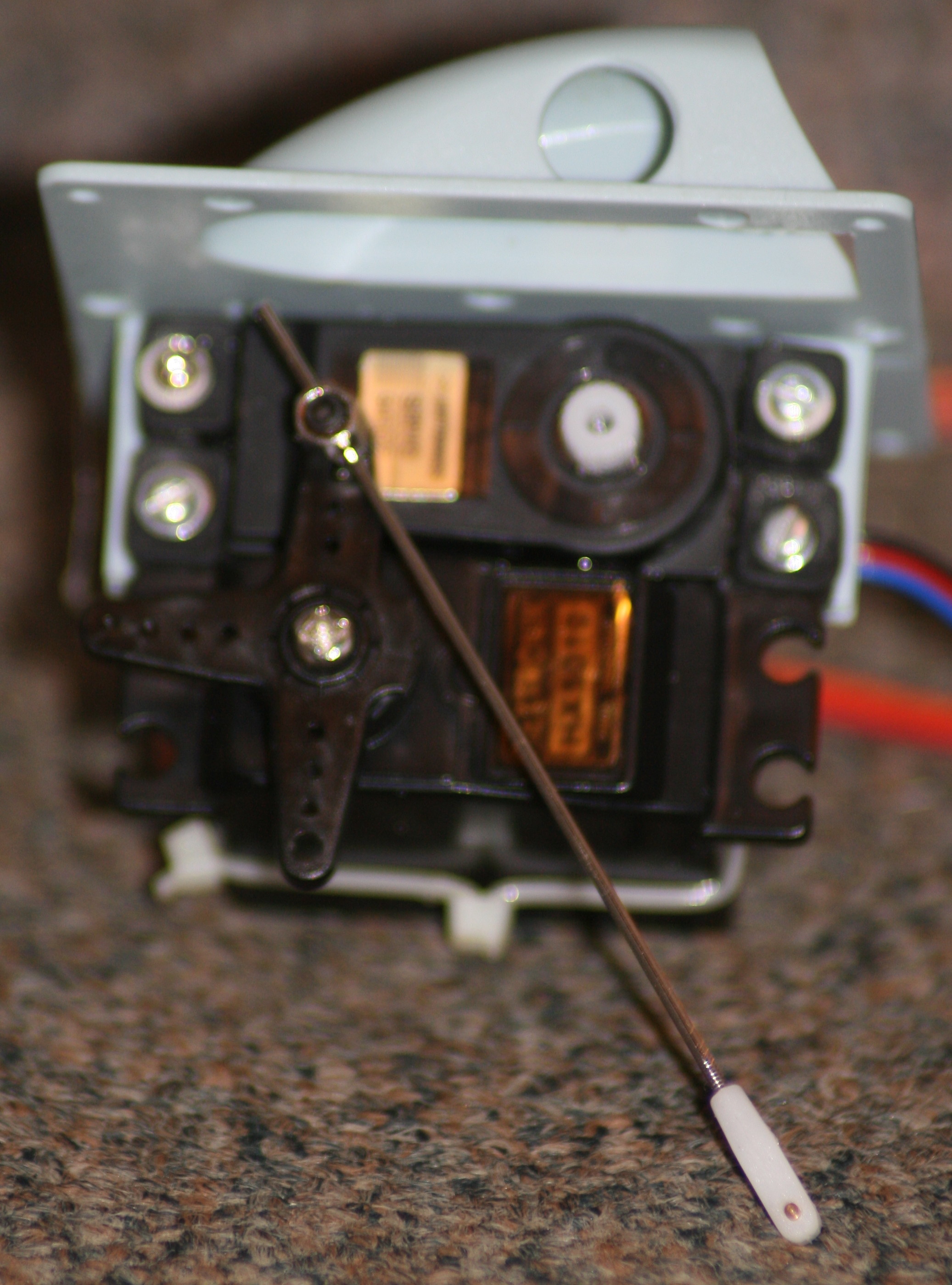

Well I’ve put this off about as long as I could… so its time to set up the flaps and the spoileron. To make this work the way I have it envisioned the glycol cooler flap (GCF) will act as part of the auto temp control so as I increase the T off idle the GCF and spoiler will open about the width of the opening under the wing. Then when the flaps are deployed when the CGF comes down the spoileron follows it down. To do this I needed to mount two servos in the GCF cover and the pictures below will show how I intend to do this.
The two servos were cleaned then bonded together with R6000 from A.C. Moore, then clamped for drying with a C-clamp. Then add a pull tie just incase the bond gives way.

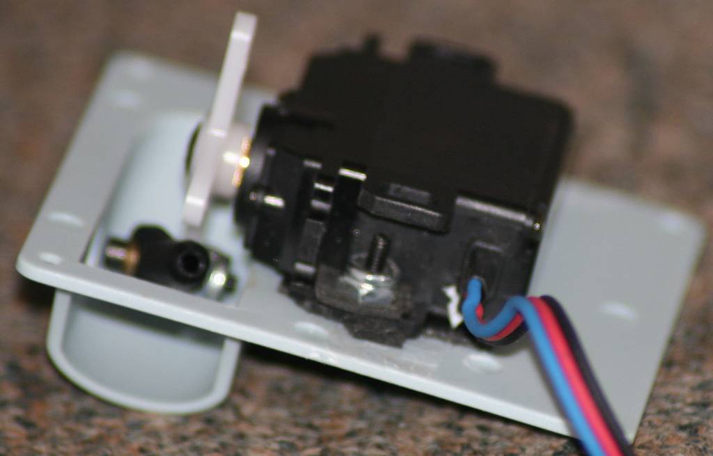

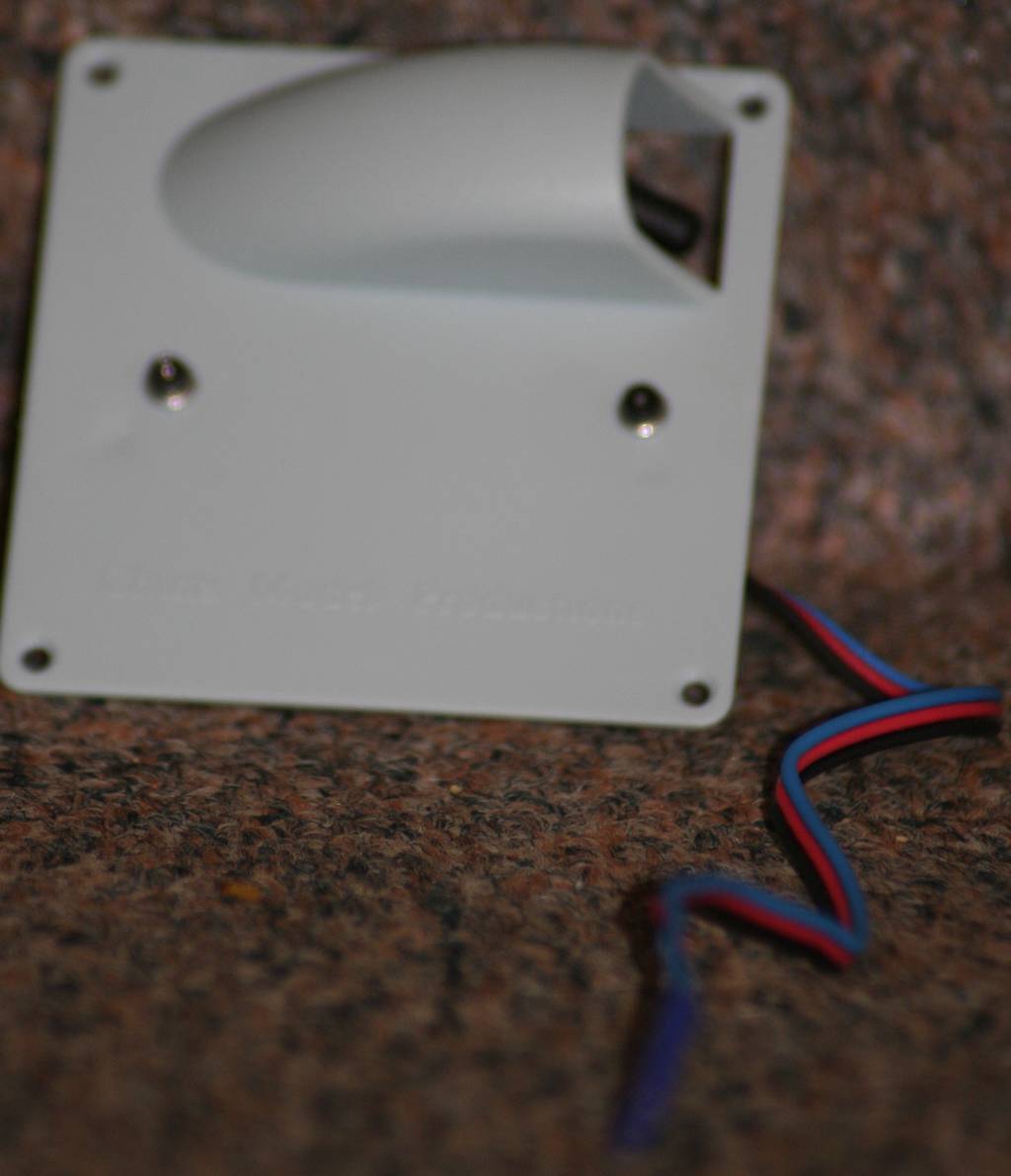

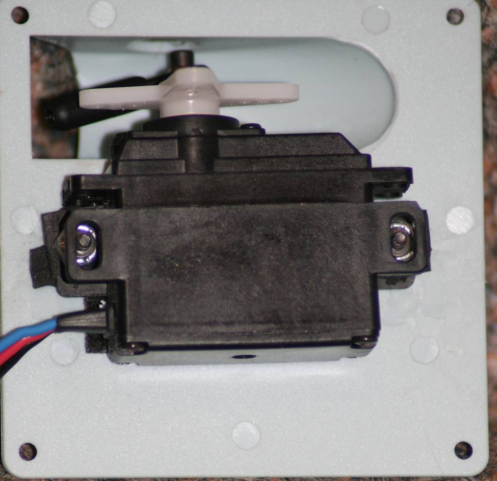

the other flap servo is pretty std. but here it is. the aileron servo had some side mounting tabs so alittle managers tape and some screws and away we go.

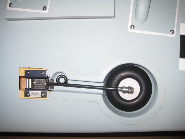

"Robart air retract " can you please post the part number
Old 10-25-2009 | 07:26 PM
  #1345
Joined: Jun 2008
Posts: 12
From: Victoriaville, QC, CANADA
Robart Retracts Product ID: 550W1
Product Name: 90 deg. Main 3/16" wire
Also buy a Robart 188VRX Standard Deluxe Air Control Kit

Thanks for the quick responce Fetso , do you have any pics yet of the retracts in the plane ?
Its great to see options , I know the KMP-BF109 sierra gear requier mods the Sierra gear made for this plane appear short ect , so its great so see another option

The KMP gear made by Sierra does NOT fit this plane as u mentioned. Darrel made a set specific for this plane and fits no problem, but, may be a tad short. The robart ones seem decent for anyone wanting wire struts, although with the overall weight of this plane, I wouldnt put wire struts on it myself.

The Robart kit fit perfectly on slot and no modification are necessary. You can ad a strut covers from Robart if you don't like to see a wire struts...

For me, its not the looks of the wire strut so much, but the weight of the plane. A good set of working oleo struts will make a huge difference in how it lands.
