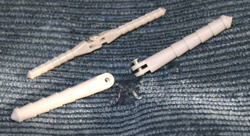

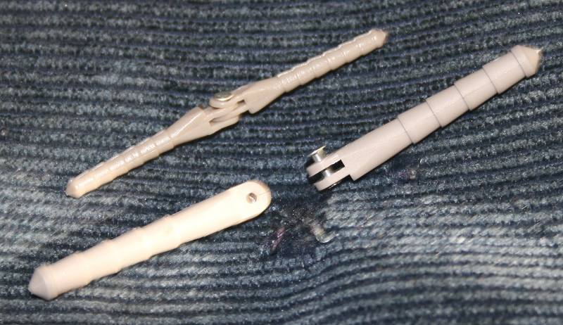

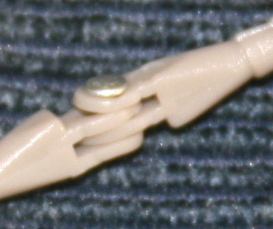

I got robart hinge pints, both the 1/8 and 3/16. well I decided to test the smaller one and it held up very well. It was about the same failure point as the one I posted (from the kit) which I expected. This is subjective of coarse. But the big difference in my mind was that the failure point came on so slowly that I was able to stop before the pin turned so you could see the elongation of the plastic and the slight turning of the hinge.
Then I tried the bigger hinge I was expecting this to put the kit hinges to shame. As soon as I started pulling it failed! Both knuckles, without the pin in them in the pic’s, split with out warning. So I have to say the kit provided hinges are just as good as robart hinge points. My plan is to use the kit provided hinges with the control horn on them and use robarts every were else. Once I get a count of what I need I’ll break a few more robarts hoping the first one was a fluke.
I’ve been looking at polyester resin on the internet, but what store can I walk and buy this stuff? A place they sell/repair boats?
Joe
Joe

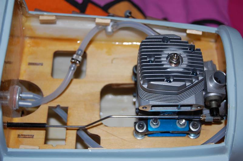

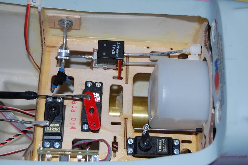

I agree with scalecraft. I like to take the ARF as a start. Then I try to make it as good as my experience and my budget let me.
I took the trottle servo out of the engine room. See the pictures which also include some of the fuel plumbing.
Regards,
Eric Schumacher, Netherlands.
Regards,

And when I'm at it, here is a picture of the electronic heart, waiting for the transplant. The device gives a 6v current from 2 seperate 2c lipo's. It also prevents overloading the receiver, as the servo currents don't pass the receiver.
I also put in an fuel valve for easy fuelling. The other knob showing is the mixture control.
