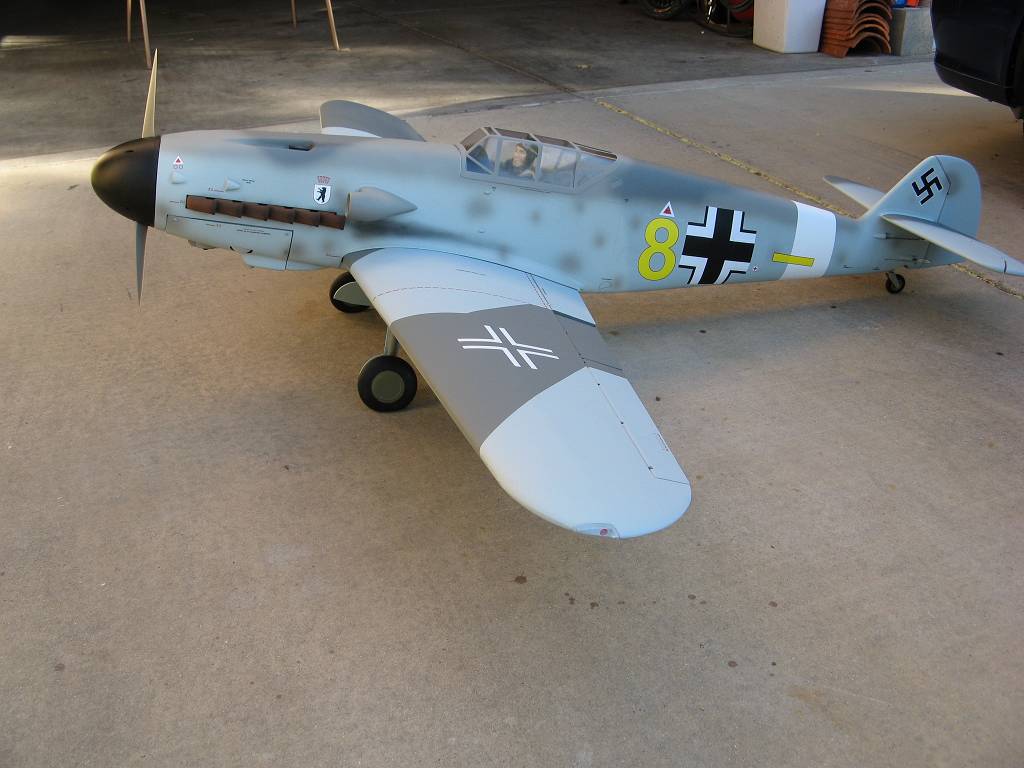

Flight Report
Equipment:
OS 160 2 cycle engine
Ram on-board glow driver (5000 mah battery)
Spring Air retracts (in stock location)
Zinger 17 x 10 prop
Aluminum spinner
Duralite receiver battery (mounted aft of pilot to balance plane)
Recommended control surface throws, per instructions.
CG - 115mm
First flight:
Ground handling good. Take off uneventful. Tracked straight down the runway. Normal amount of right rudder for tail dragger / warbird. Trim; added several clicks of down trim, two or three clicks of aileron trim. Engine running rich (not completely broken in). Plane is very stable and smooth in flight. Dropped full flaps on final. Did not use spoilers. Flame out on final. Barely cleared fence at the end of the field, plane on the edge of a stall, then stalled 2-3 feet above ground. Dropped flat, took out gear, no other damage.
Reinforced landing gear mounts. (keeping stock location)
Second flight:
Switched prop to APC 16x12 (much better!) Leaned out engine a bit. Plane flying much faster! Several low altitude, high speed passes had fellow club members drooling!! Same set up for landing; full flaps, no spoilers. Kept 3-4 clicks of throttle until over threshold. Came in a little hot. Used full runway to slow down.
Conclusion; This plane is very fun to fly and looks great in the air. P-51's and P-47's look out!!! Take offs and landing require your full attention. (as expected with a tail dragger warbird with narrow gear) I would not move CG forward (of 115mm) unless I re-positioned the gear. (as others have done) Having the CG close to the position of the main wheels could lead to nose overs on take off. [img][/img]

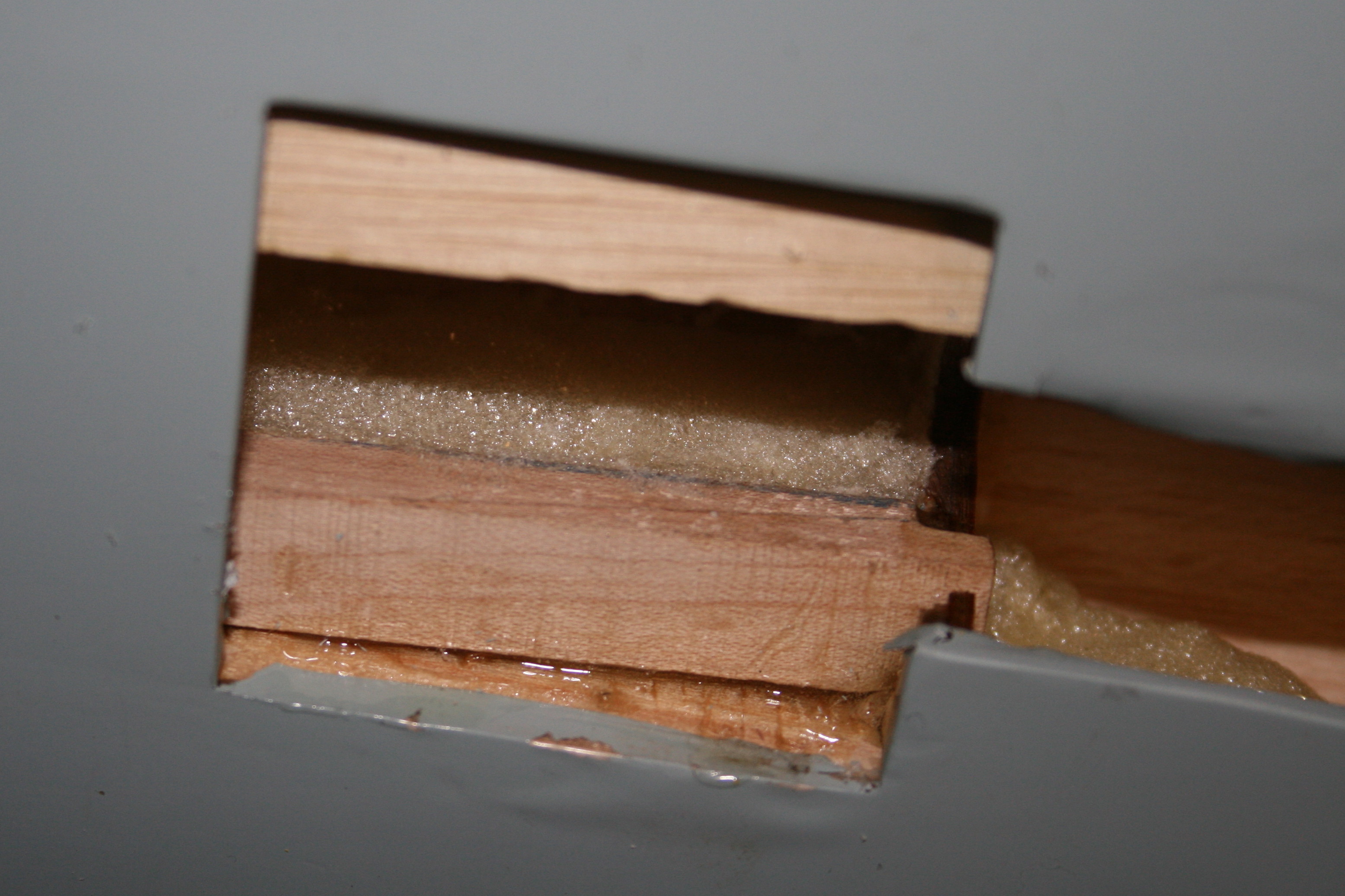

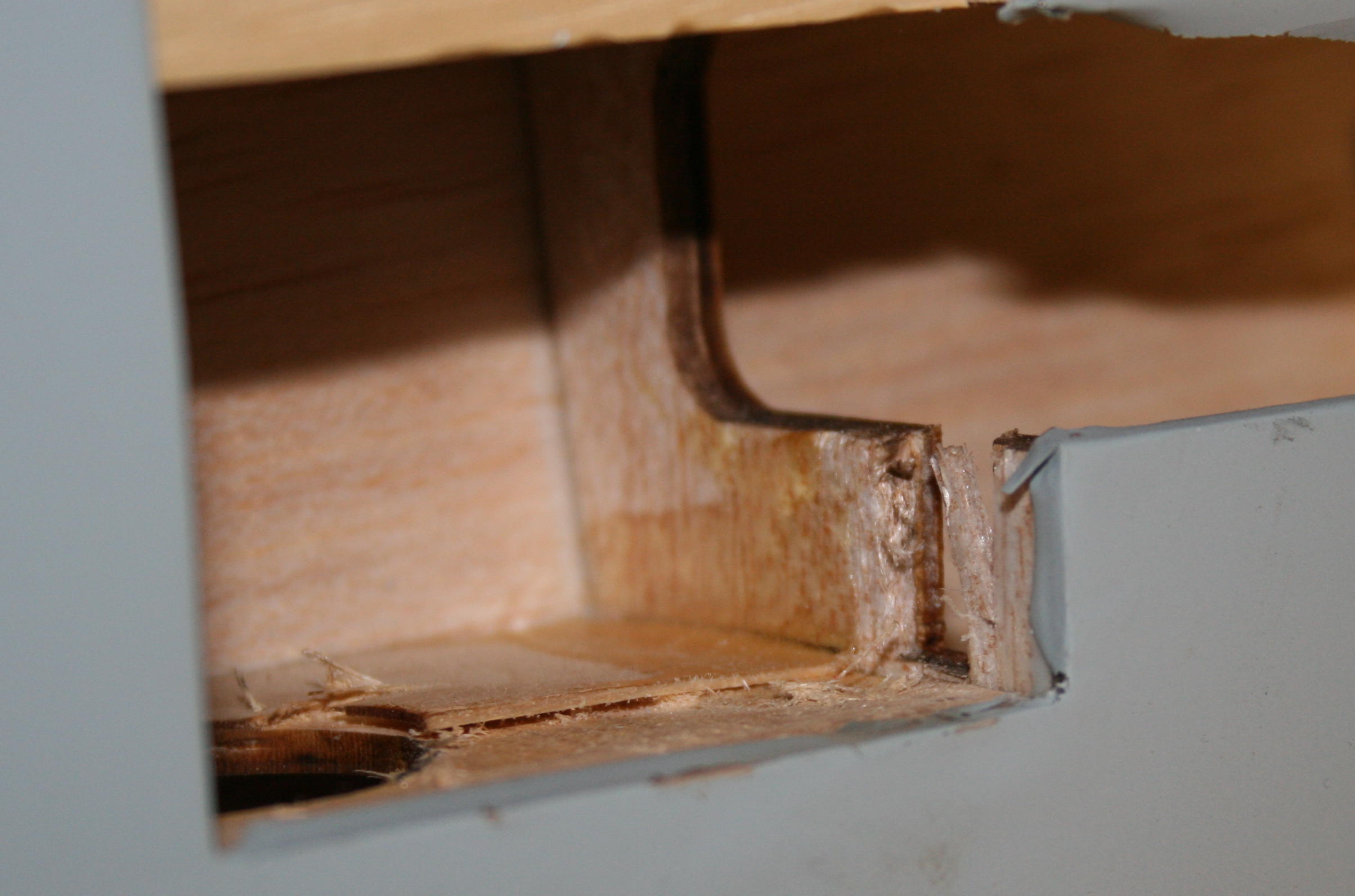

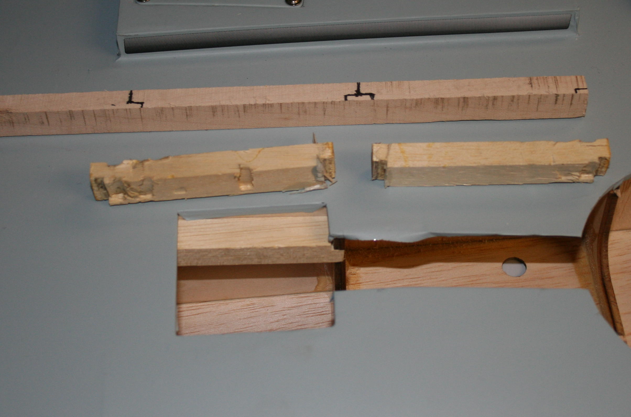

Old 11-30-2009 | 03:23 PM
  #1416
Posts: 2,922
Received 6 Likes on 6 Posts
From: Vestal, NY
Default RE: CMP BF109F BUILDING THREAD
prepairing to install retracts.

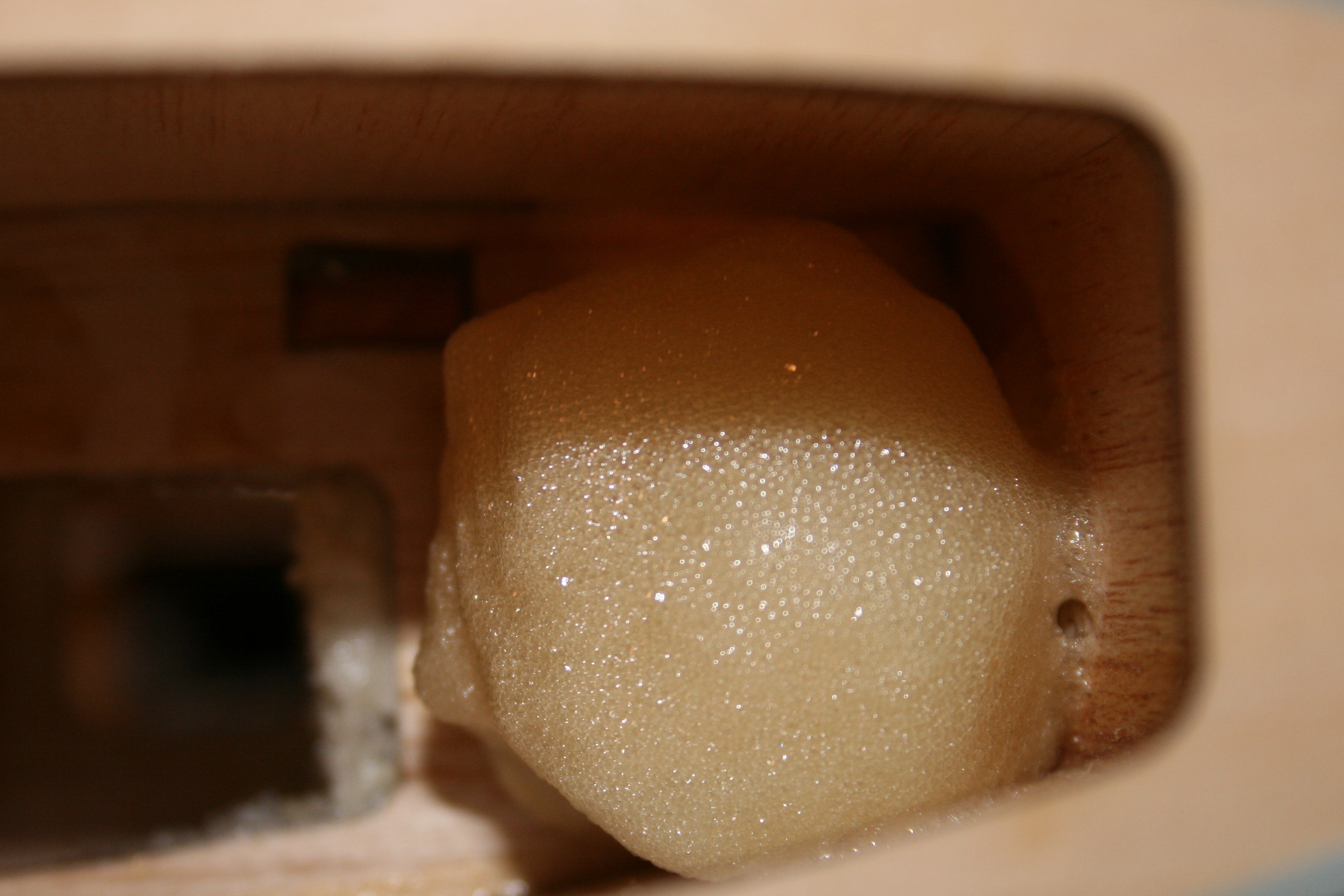

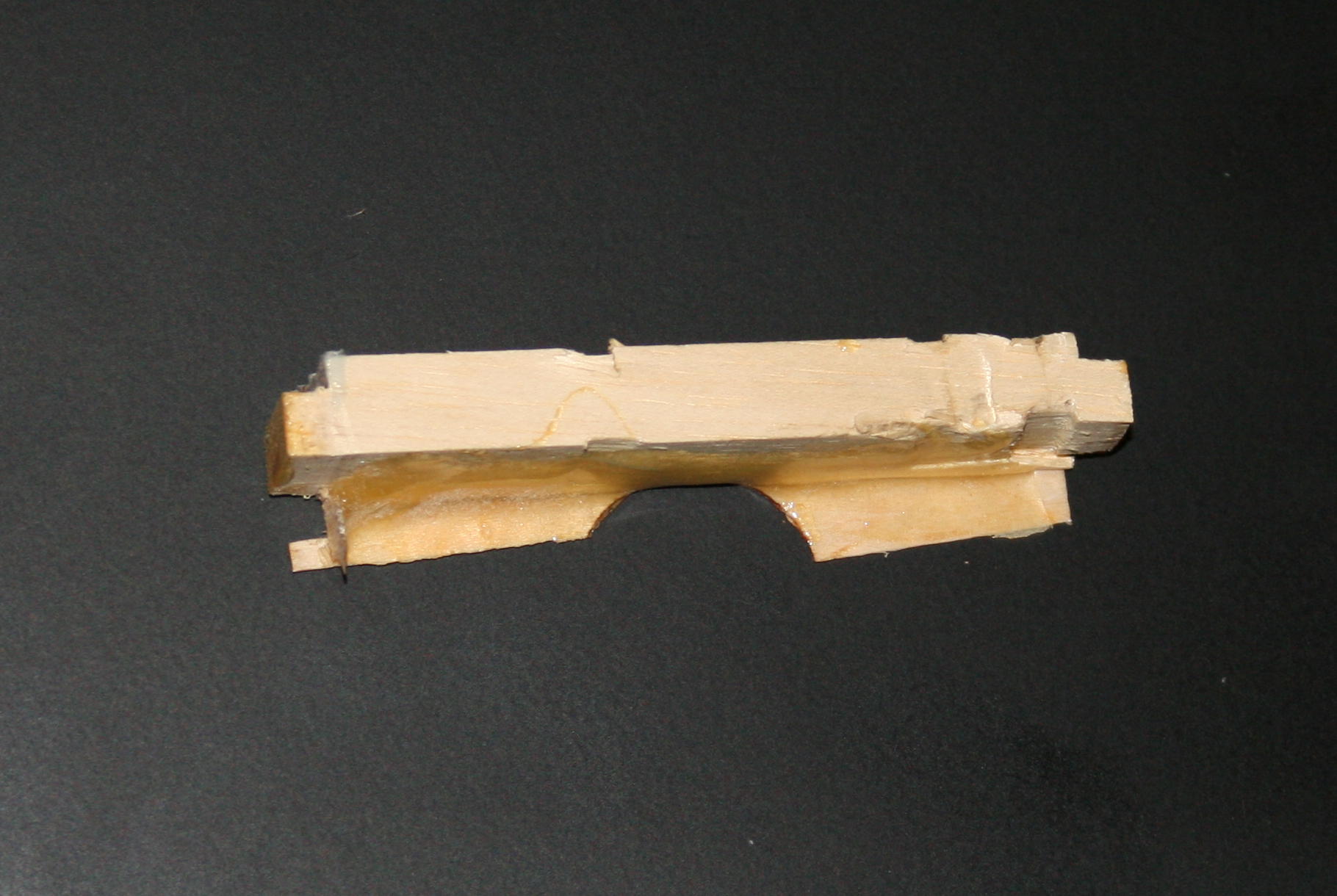

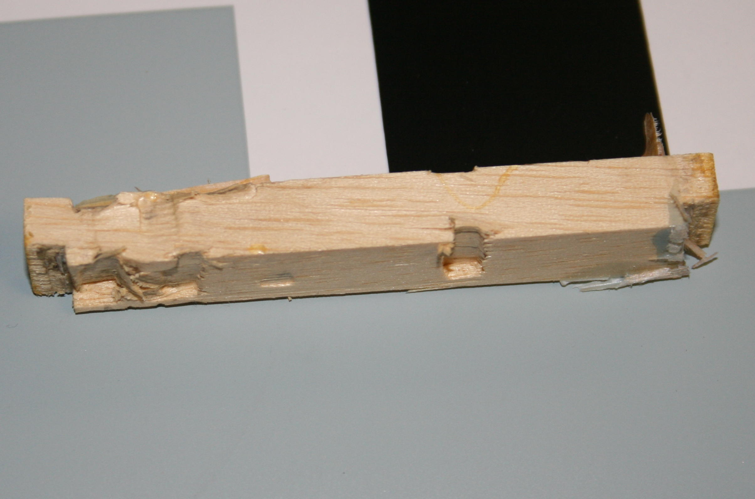

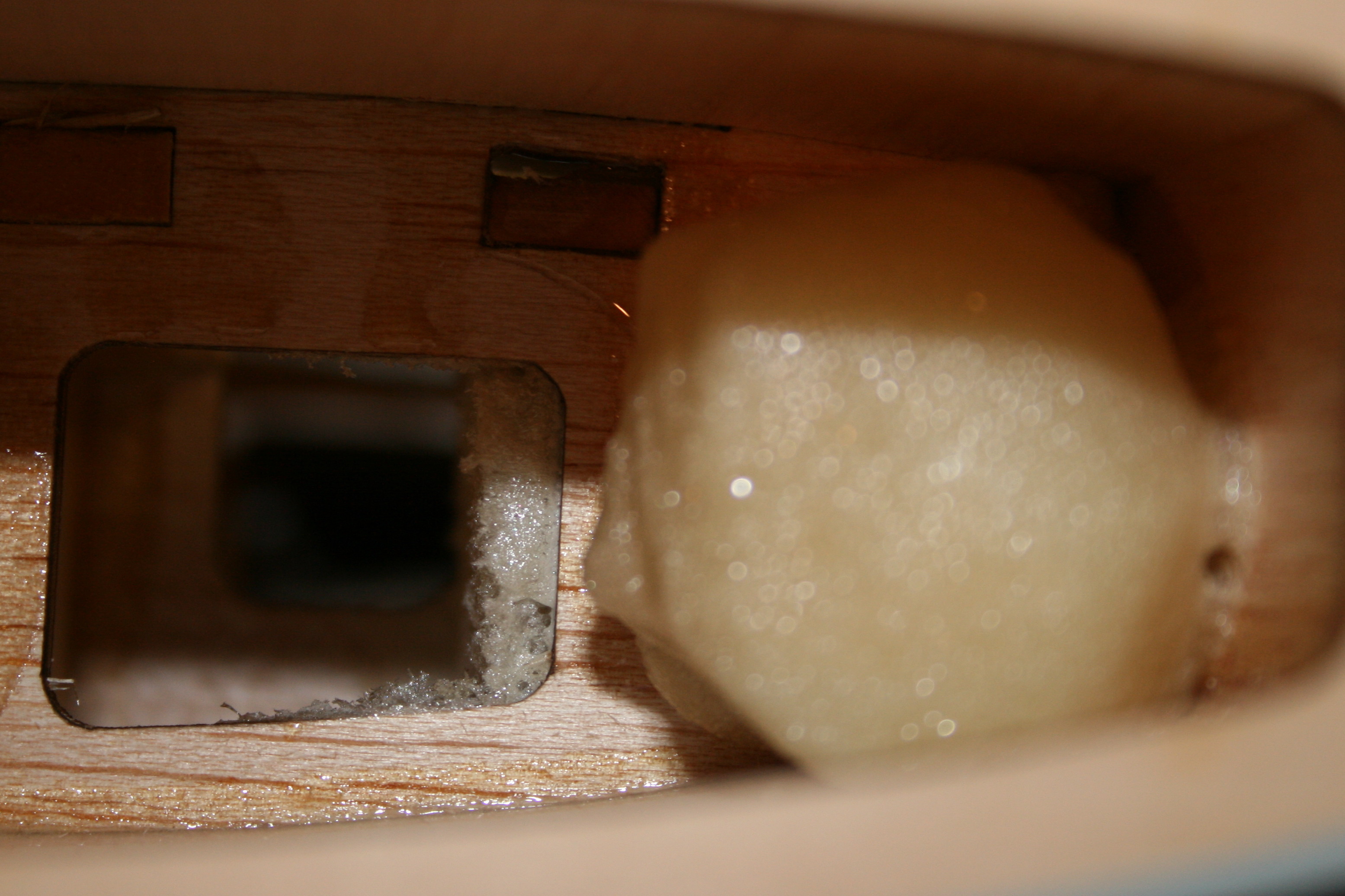

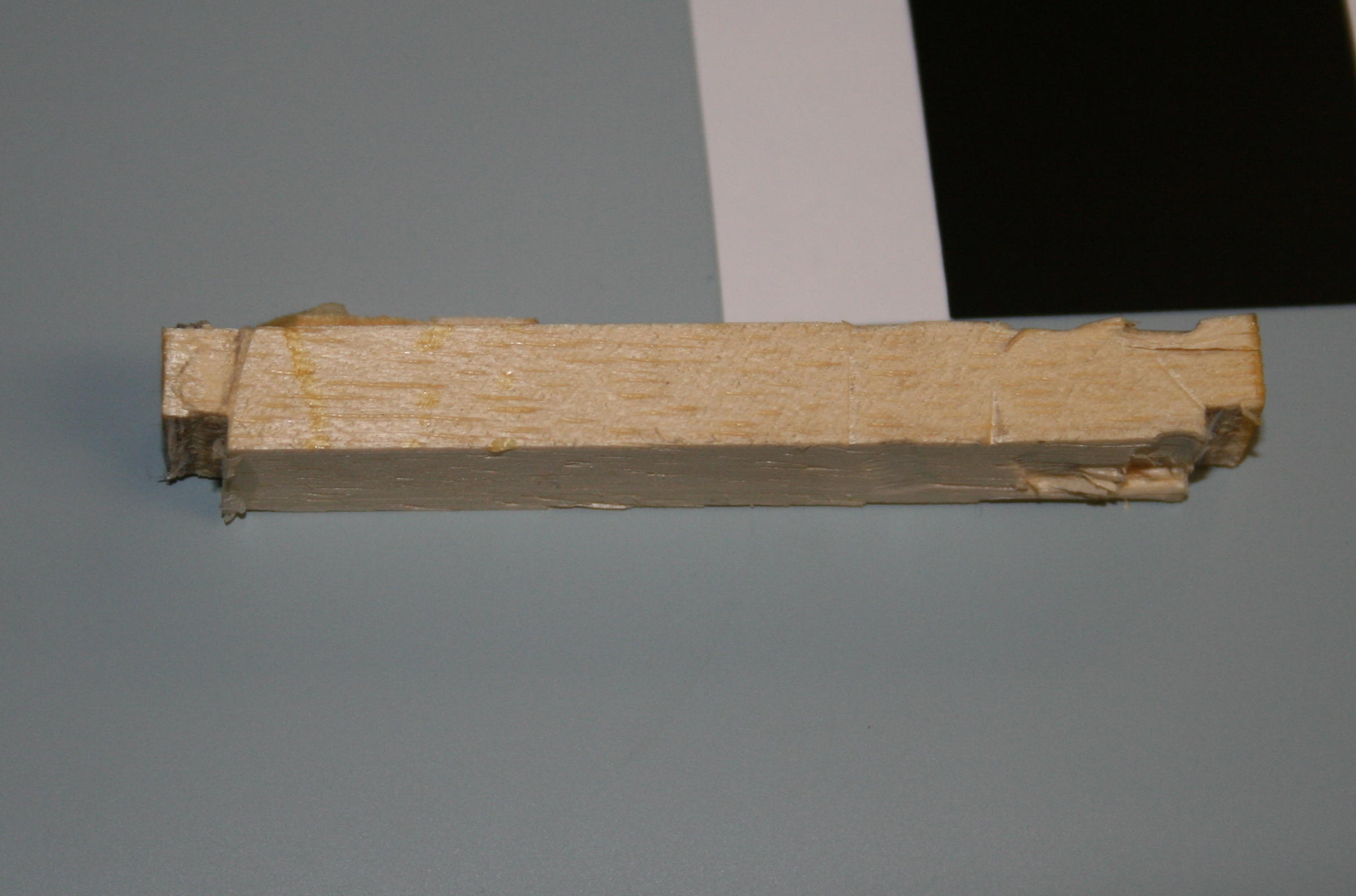

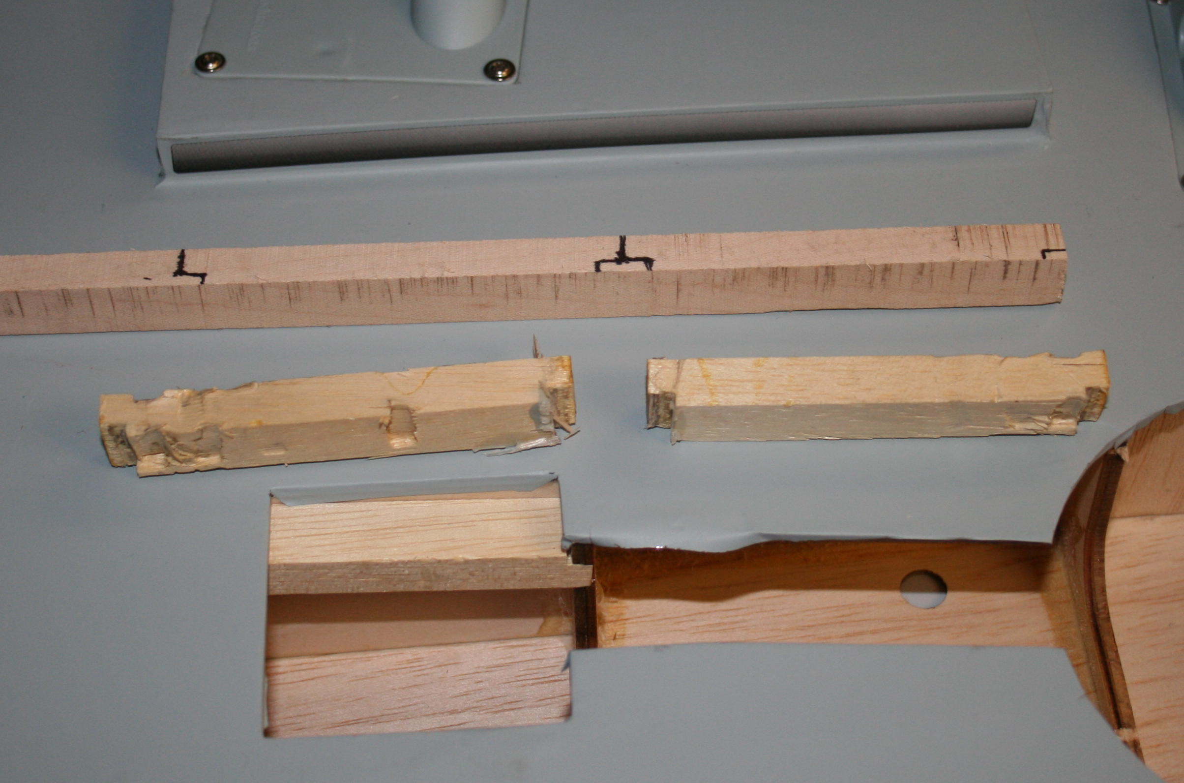

first step is to remove the front mount. I ran a x-acto #26 blade between the front Landing Gear mount and the support as far down as I can. Then grab it with a pair of pliers and twist it till it breaks free from the end I can reach. Pull that end out, push back in and repeat till it can be pulled out.
Use the removed support to make new ones out of maple.
I don’t know what the old EM material is but it sure has the feel of Balsa.
Joe

Old 12-01-2009 | 08:33 PM
  #1417
Posts: 2,922
From: Vestal, NY

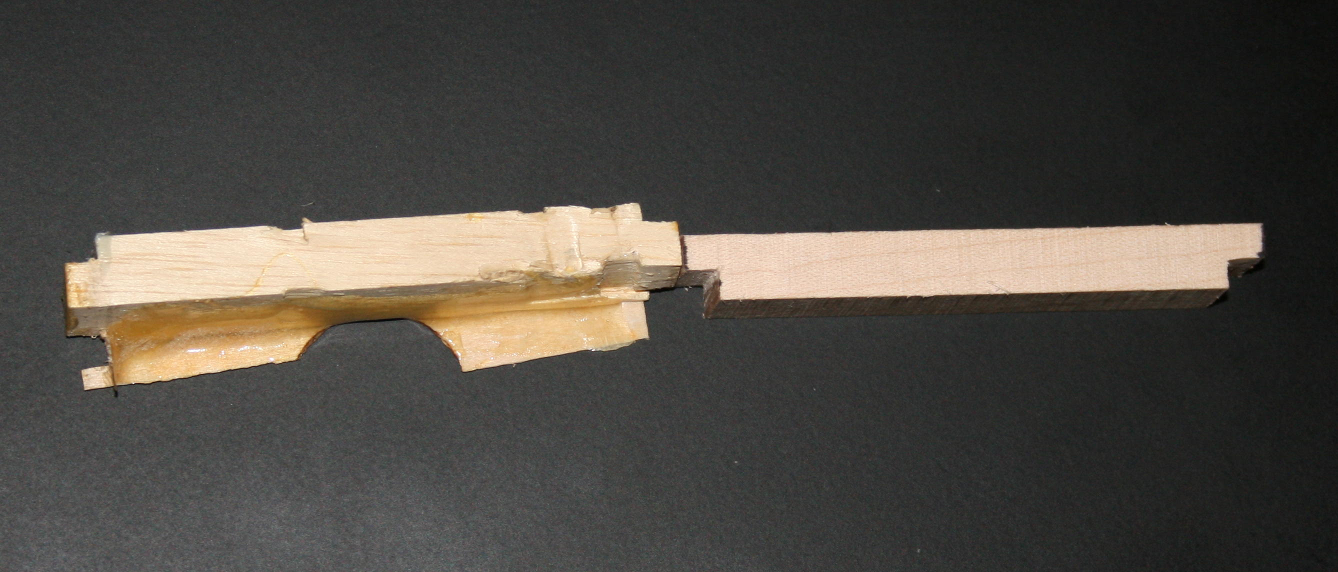

I cut out the replacement front landing gear mounts. I cut the side ears .200 thick when the original ears were .300 thick. It is my intent to mount the new rail with the ear on top, originally ear on the bottom, this will mount the rail .200 lower. Thus giving me most of the .250 shim I usually put under the back rail for ARF’s. hopefully allowing the strut to recess into the wing.
Joe

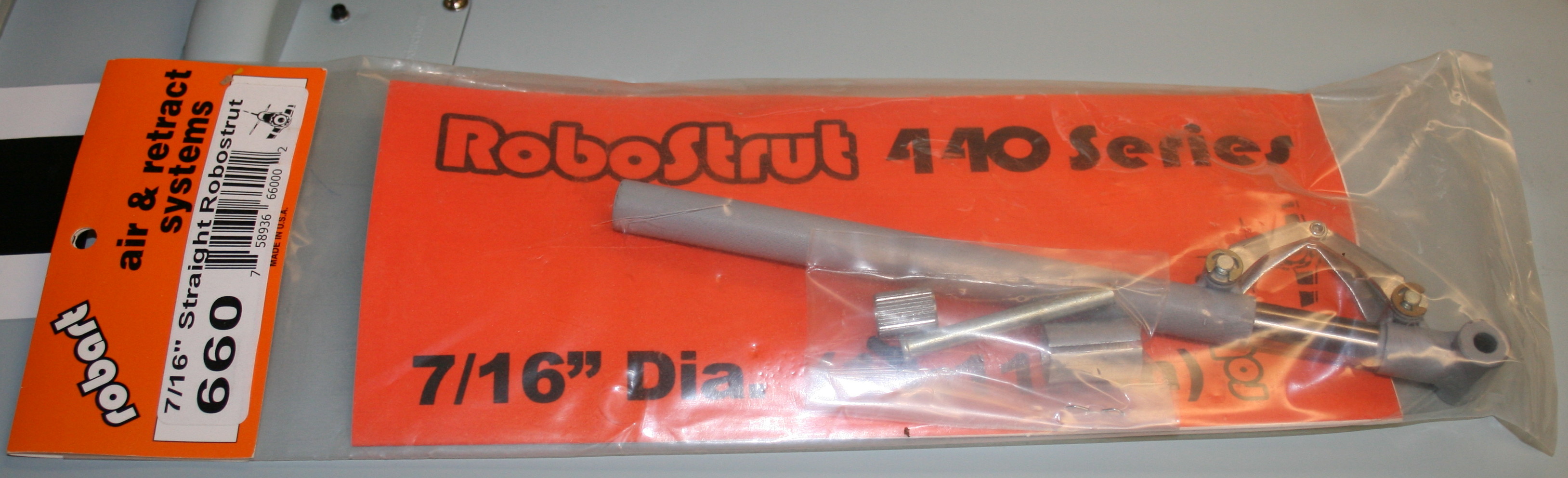

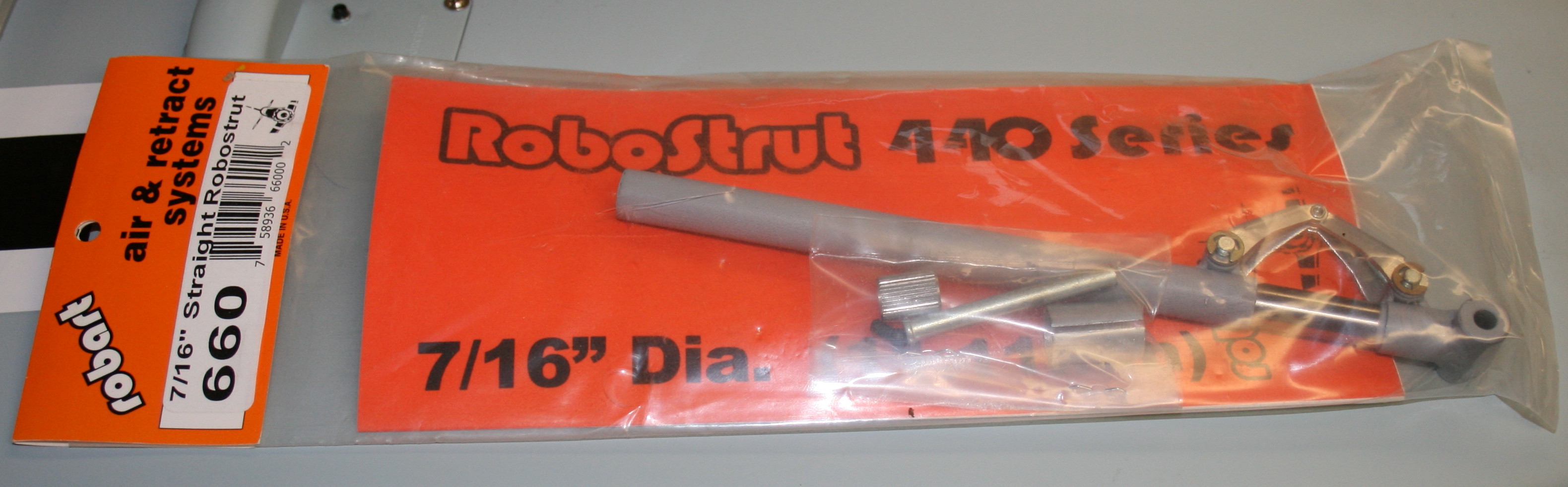

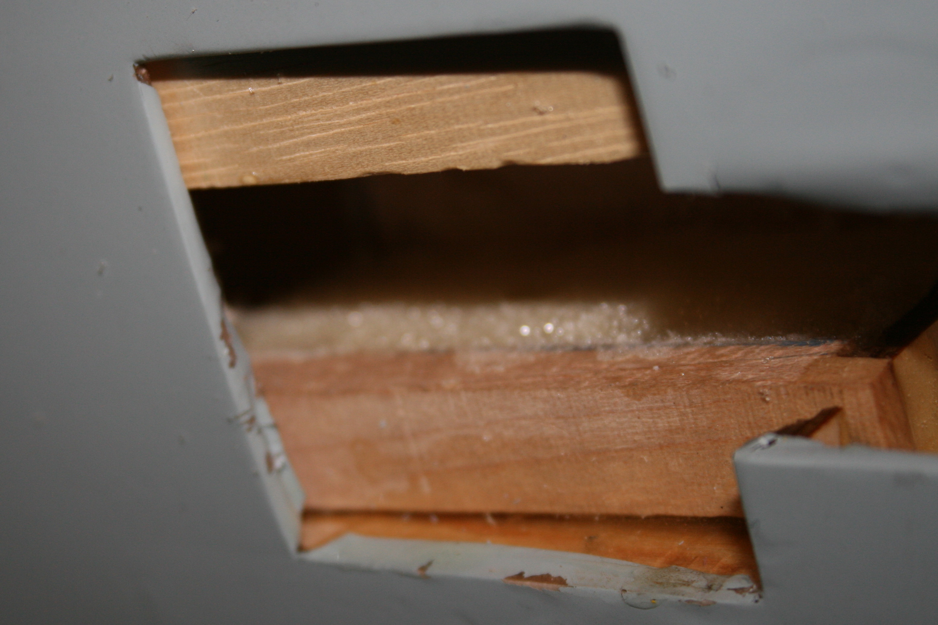

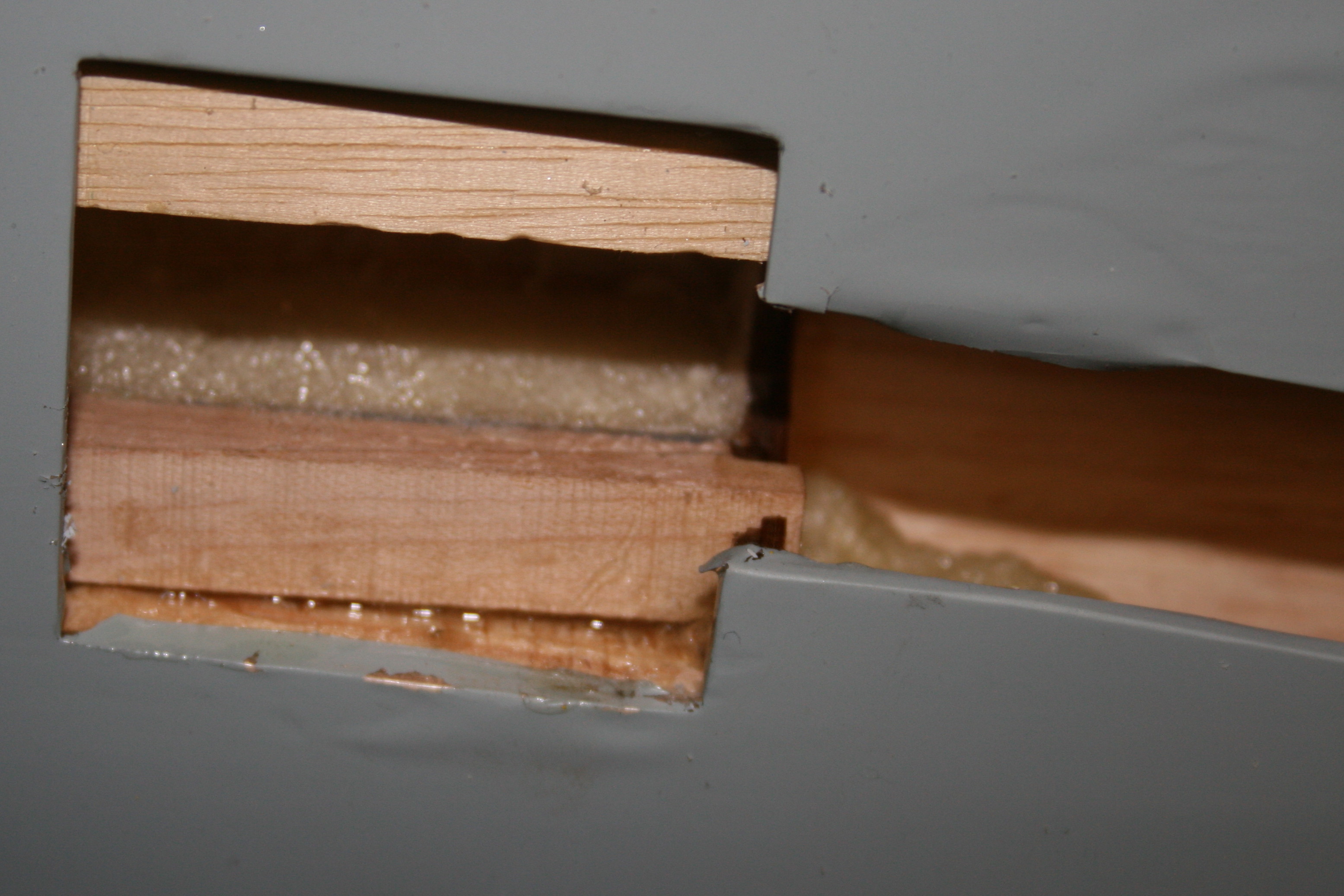

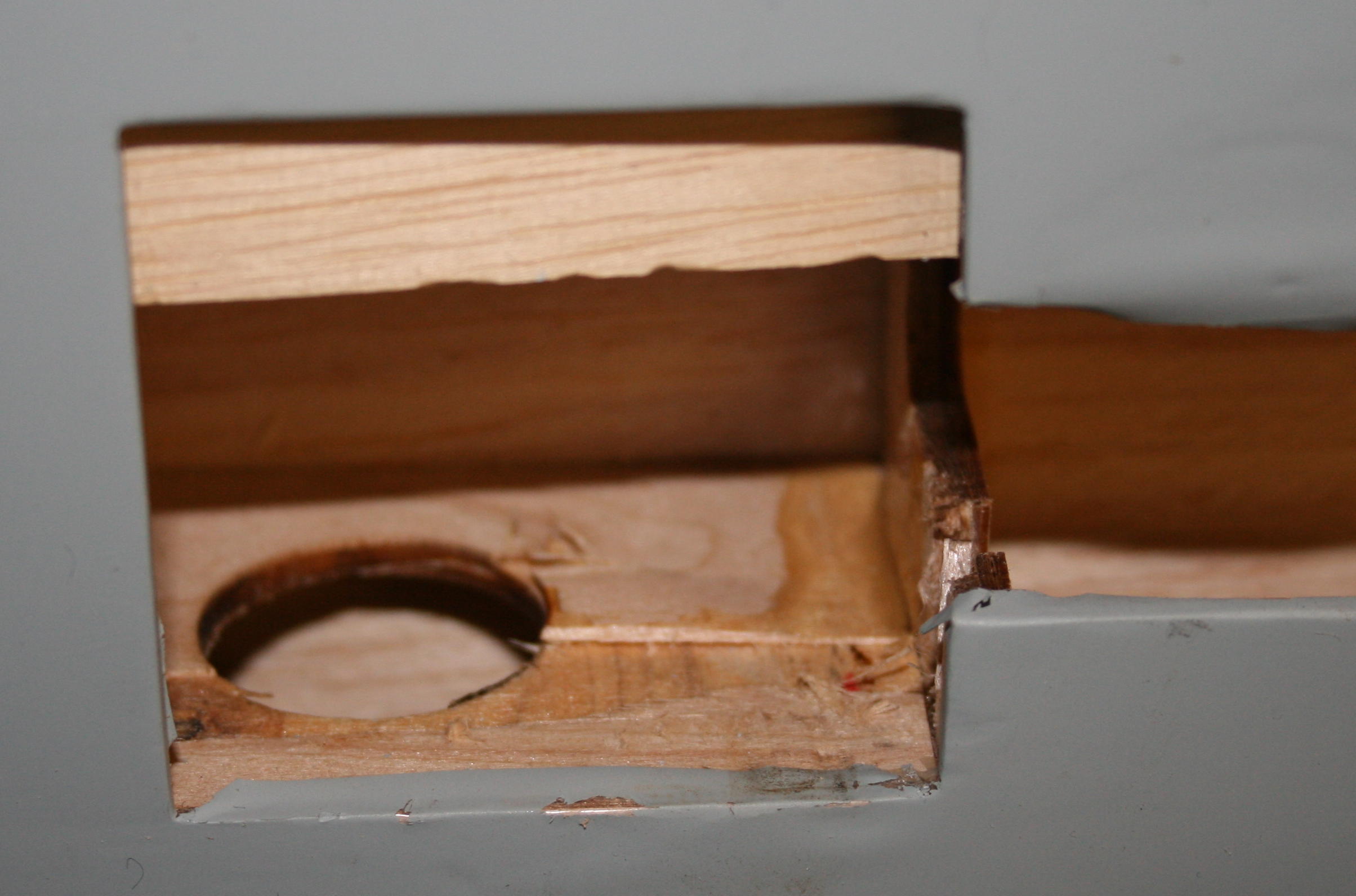

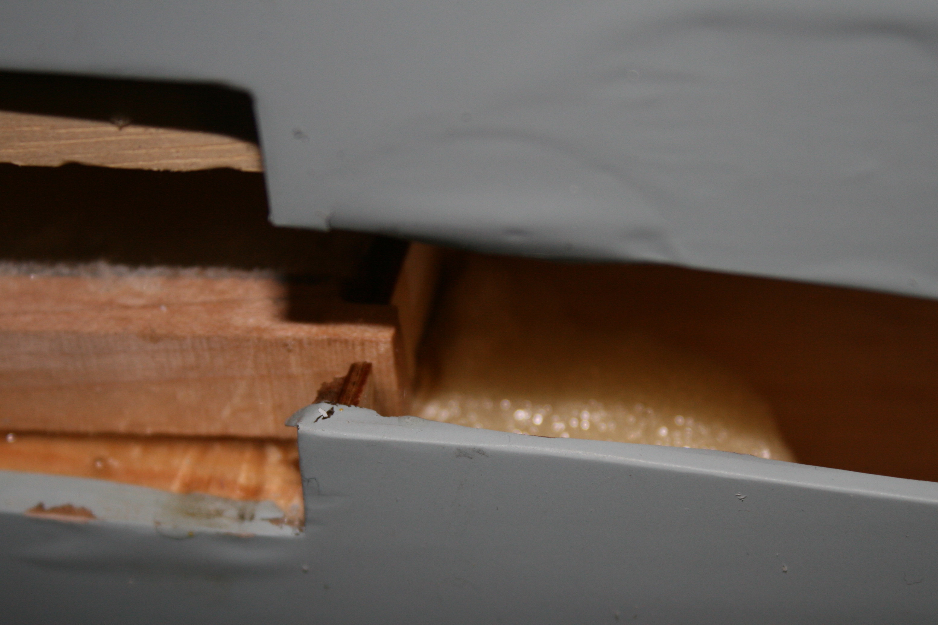

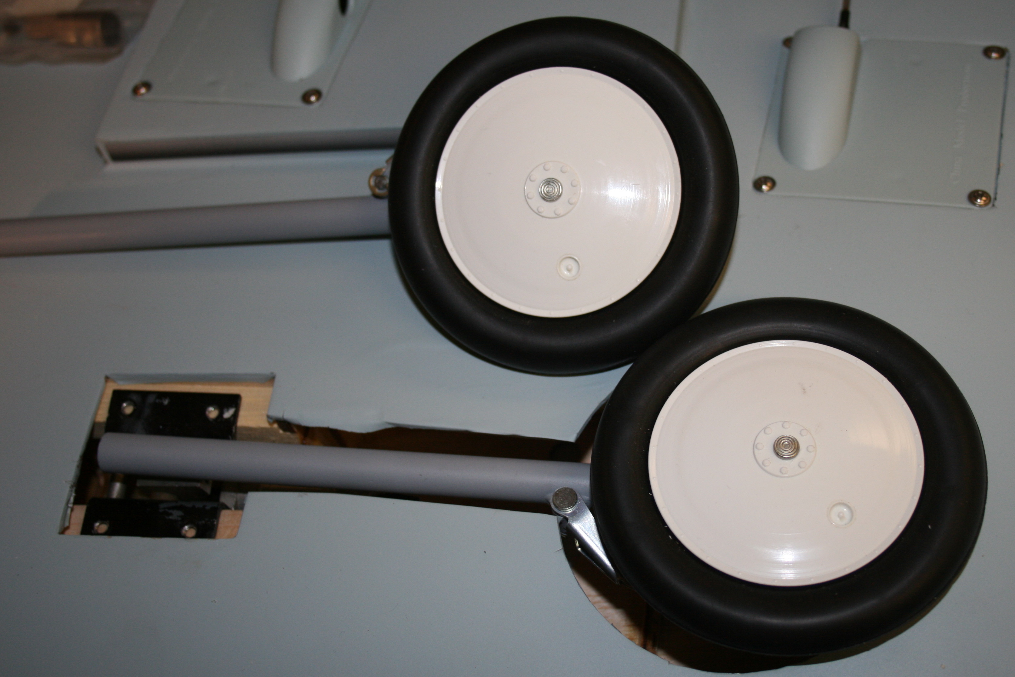

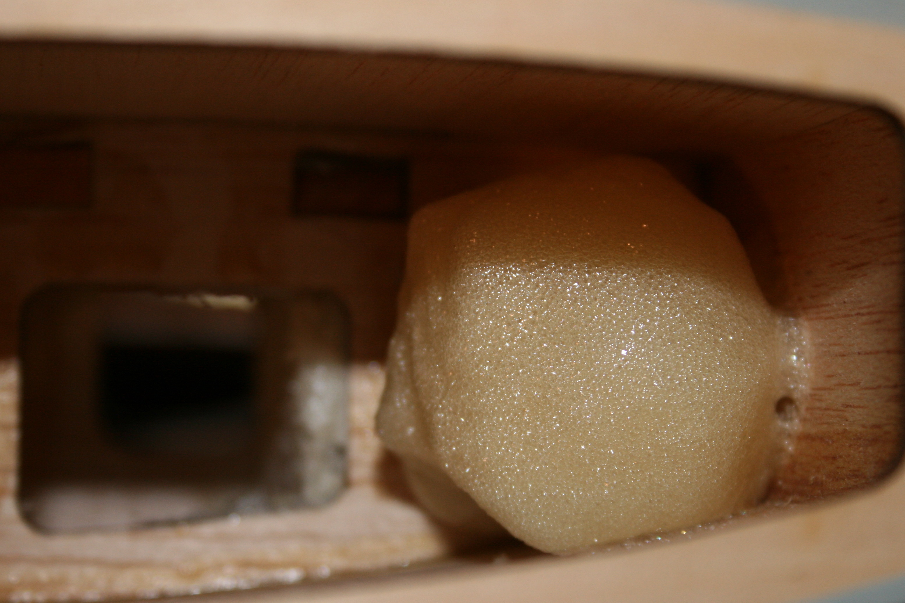

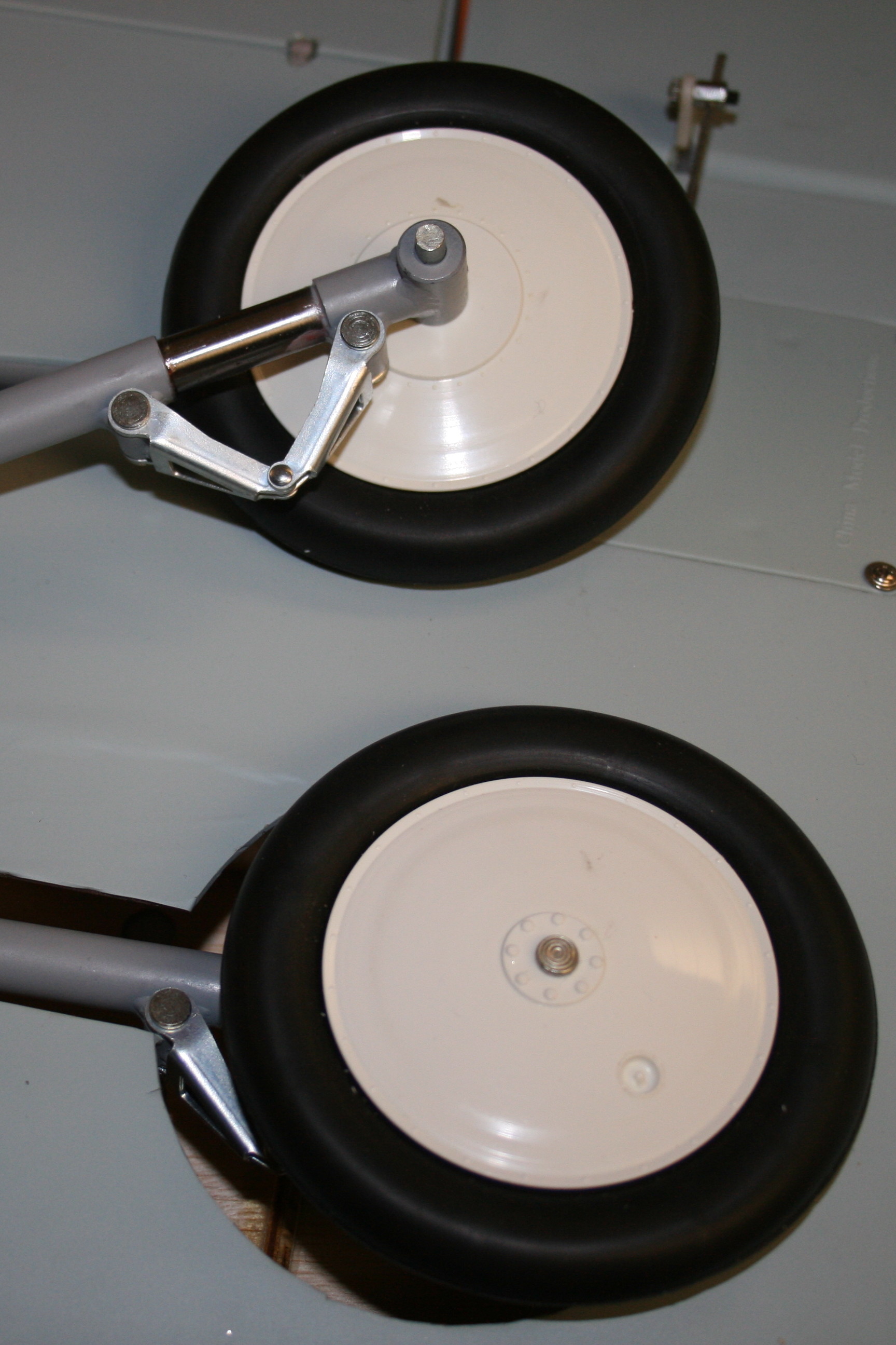

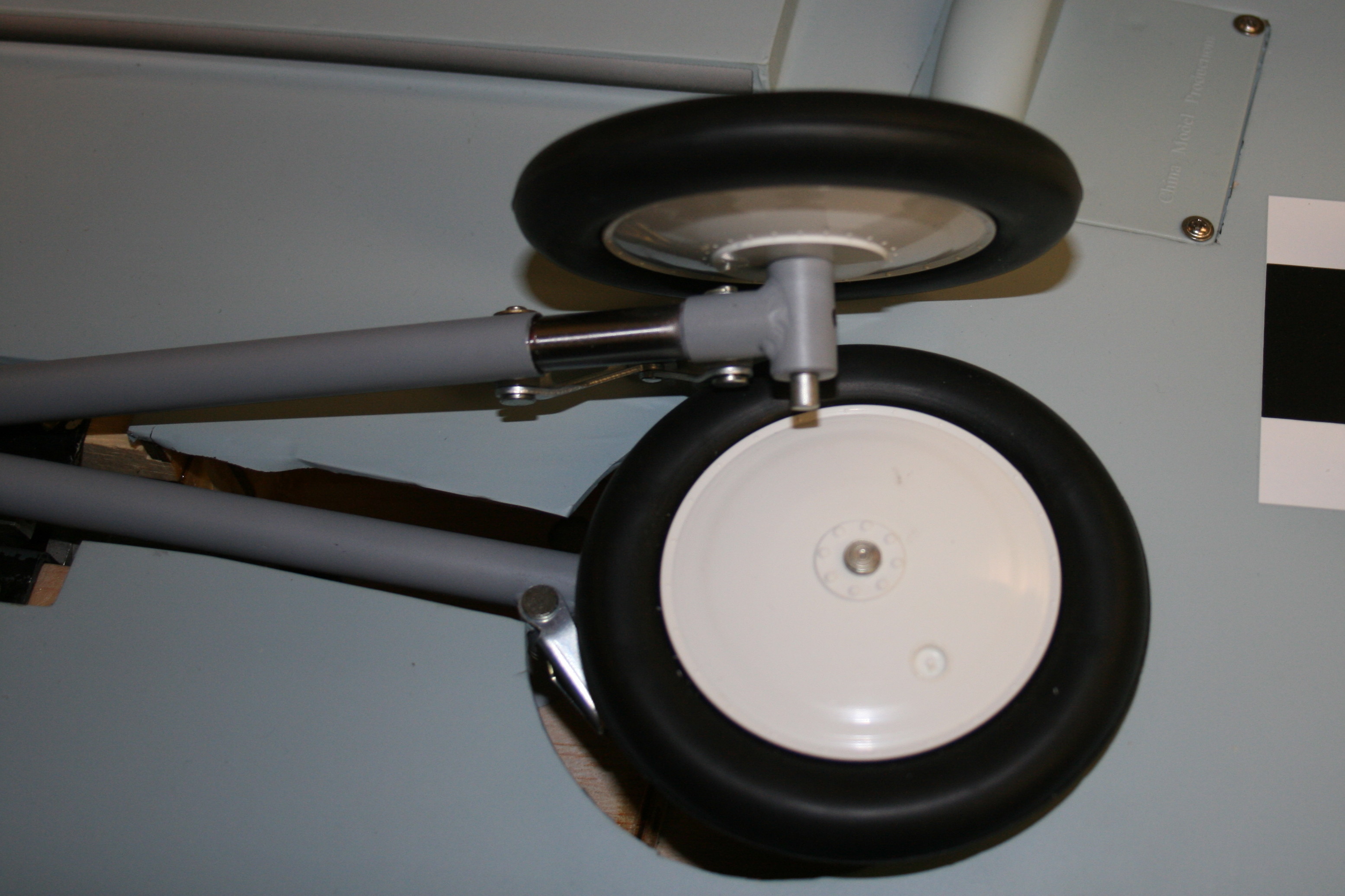

After CA’ing the ply supports back together I epoxied in the maple landing gear rails in place .200in lower than original location. Then filled the box between the Leading edge and the front landing gear rail with expanding foam. Then cut away the foam I don’t need.
I’m planning to use a set of Rhom-Airs, with the struts and wheels shown.
Joe
