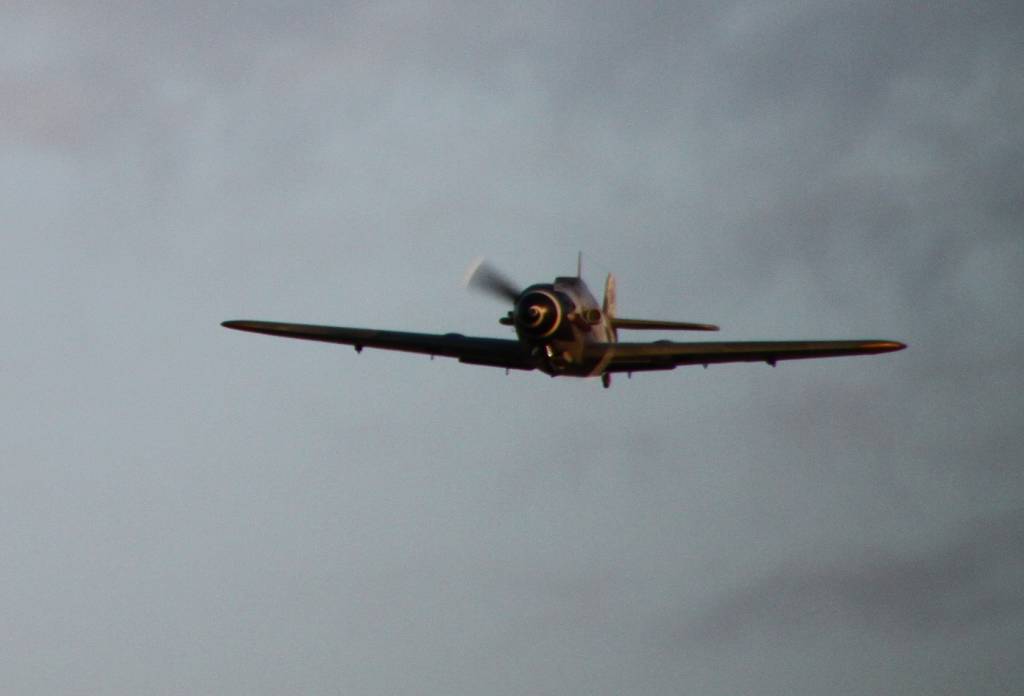

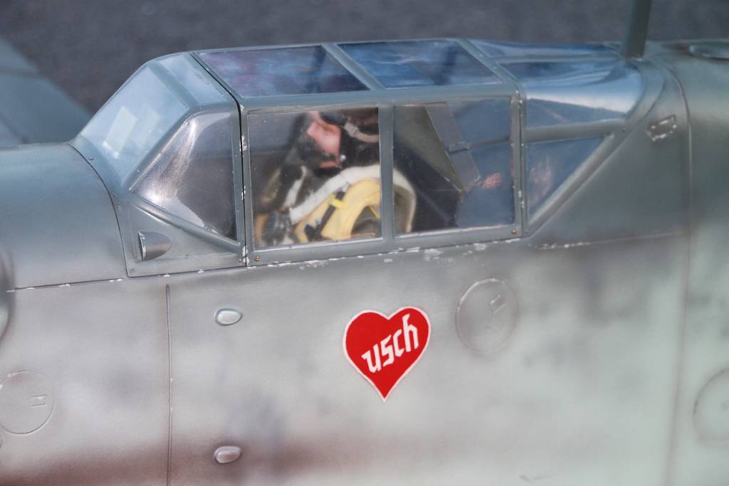

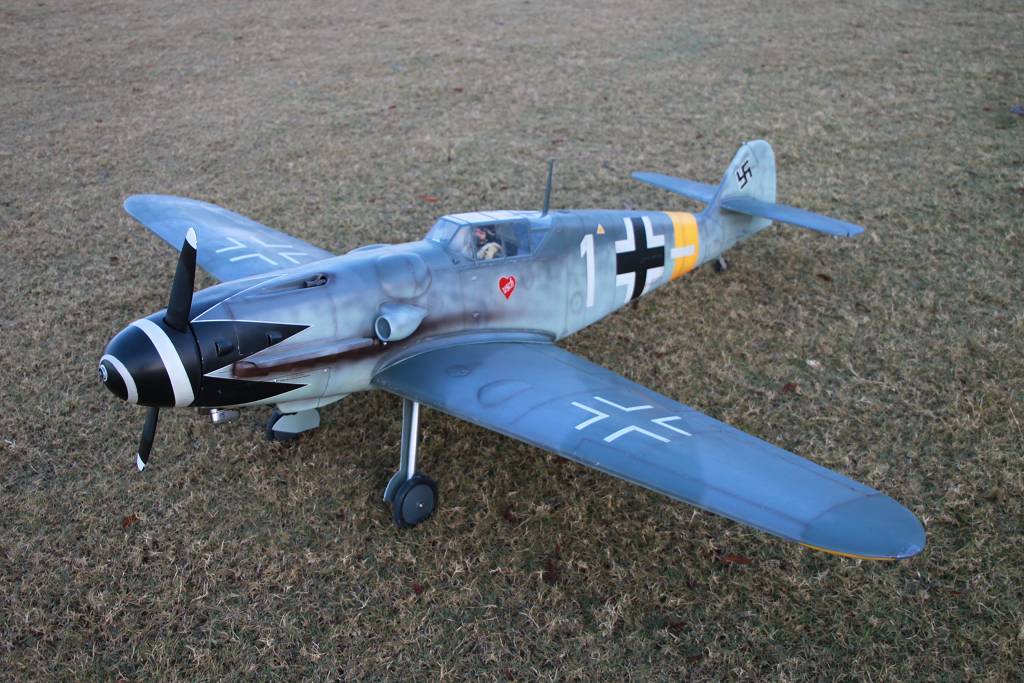

I finally maidened my BF109 today and was pretty happy. The pictures are in early morning sun so the colors are a little dark. I have a Saito 180 in this bird with Shinden retracts with modified position to bring them more forward and toward the middle. It was a pretty clean flight except for a very sensitive elevator. I am not sure if the CG is too far back or just too much throw. I am curious as to other who have flown this plane as to where they set the CG and throws. I have my CG at 112mm back from the leading edge and 15mm of throw. I hate to change the CG too much as the landing was very nice with flaps. It slowed down fairly well and didn't tend to nose over on take off or landing. I had had to cut my flying short as the internal baffler on the muffler fell off during the flight and I lost tank pressure and high end RPM so need to replace this part and give it another go. John

112mm is fine for CG. Maybe too much throw. Do you have any expo dialed in?

I didn't do expos on the radio. I may try that next time, but didn't get the chance to play around so much today. I am going to add a couple ounces to the front to move CG a tiny bit forward. I think it had too much throw but it acted a bit tail heavy and I would rather fly a warbird a touch nose heavy and land it fast rather than tail heavy.
Good luck on your new 109. I did a bunch of mods, glassed it, and added a pilot and it still cam under 15 lbs.

JD, your 109 looks awesome! Your mods came out great and the weathering is very cool. I'd fly your wing anytime! I set my CG @115mm...seems happy there. Throws are per the book except for more flap. I given her also at least -30% expo on the elevator...when all the bugs are worked out and you get her dialed in she'll fly just like you want her to.[sm=thumbup.gif].

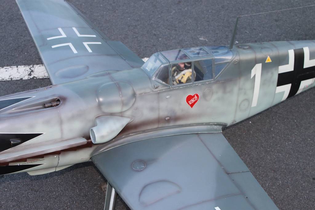

Thanks for the input Ftrjok. I went ahead and set dual rates with the higher rate set at -30 exp and left the throw as you suggested and the lower one down to 10mm throw. I will give it another go when the weather clears and see which works best. I did add a couple ounces to the nose. One thing I didn't think about was that I did the CG measurement with gear extended and I raked the gear far enough forward that it changed the CG a couple of mm back with gear retracted. I set the CG to 112 with gear retracted. We will see how these mods work.
As for engines, I also dislike the engine sticking out, but the Saito is the most reliable engine that I have ever used inverted in a warbird. The one thing I dislike more than a engine sticking out underneath, is spending my Sunday afternoon fixing gear ripped out when I tried to dead-stick a warbird. From the picture, it isn't too bad.
