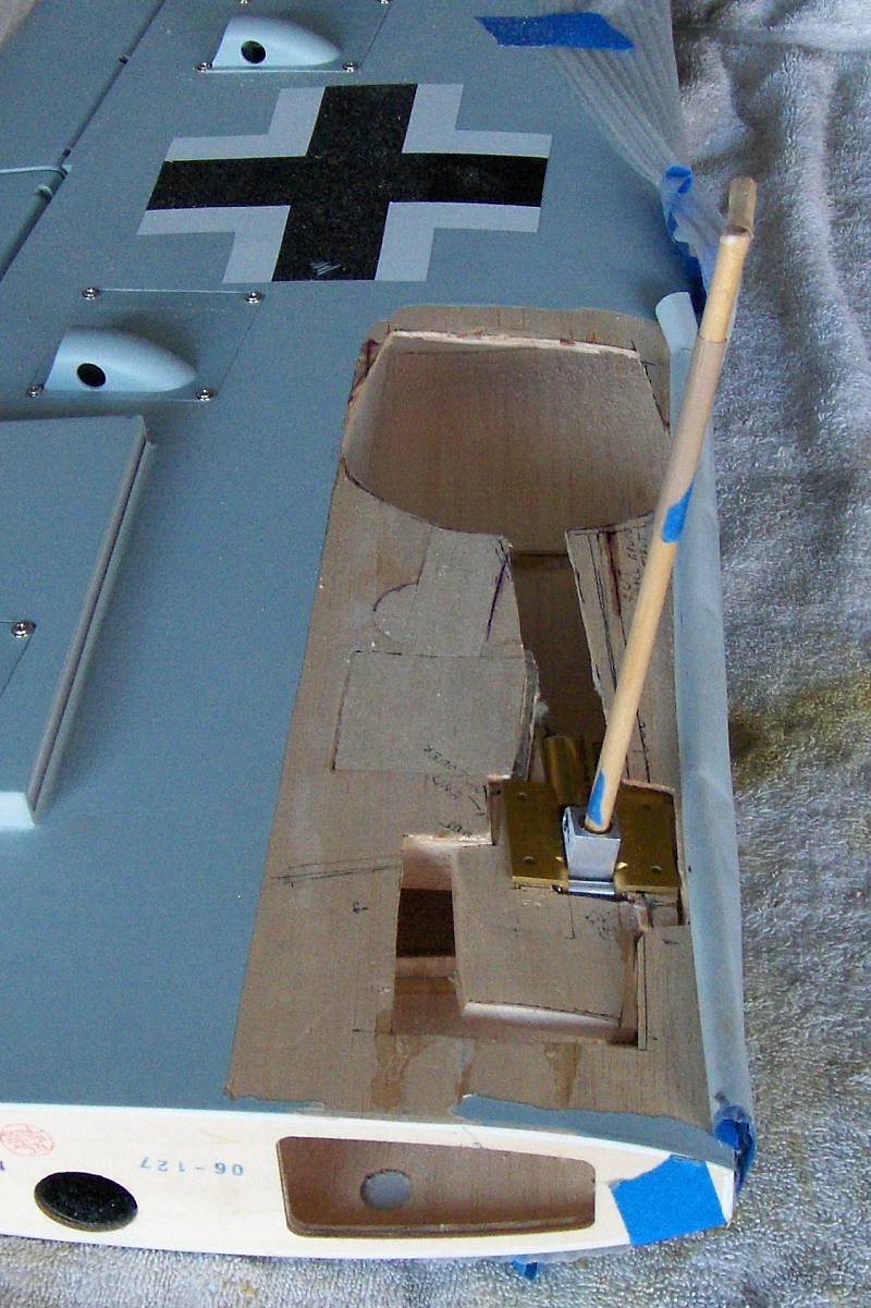

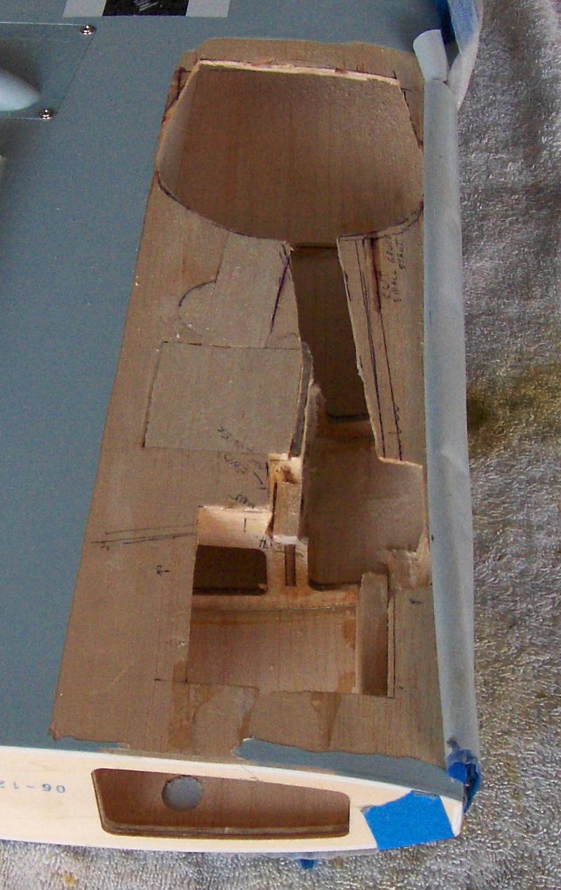

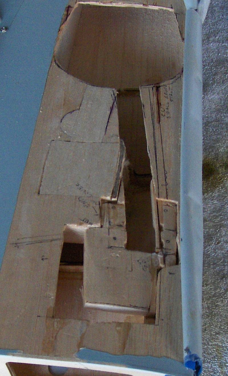

Steve,
Have you done anything on the gear installation? I spent most of the morning building a mockup of the support plate for the gear.It is nestled between the existing forward gear rail and the leading edge.
The scale location of the gear requires that the pivot point of the gear falls in the spanwise center of the rib #2 with the gear forward mounting flange touching the back of the leading edge.
I'm concerned that there is not enough hardwood structure to tie the gear plate to.
Any sujestions you might have would be greatly appreciated.
Bob Q.

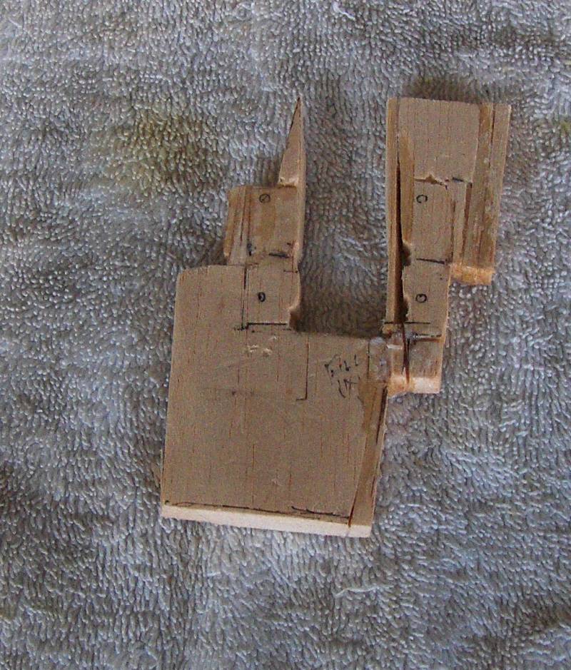

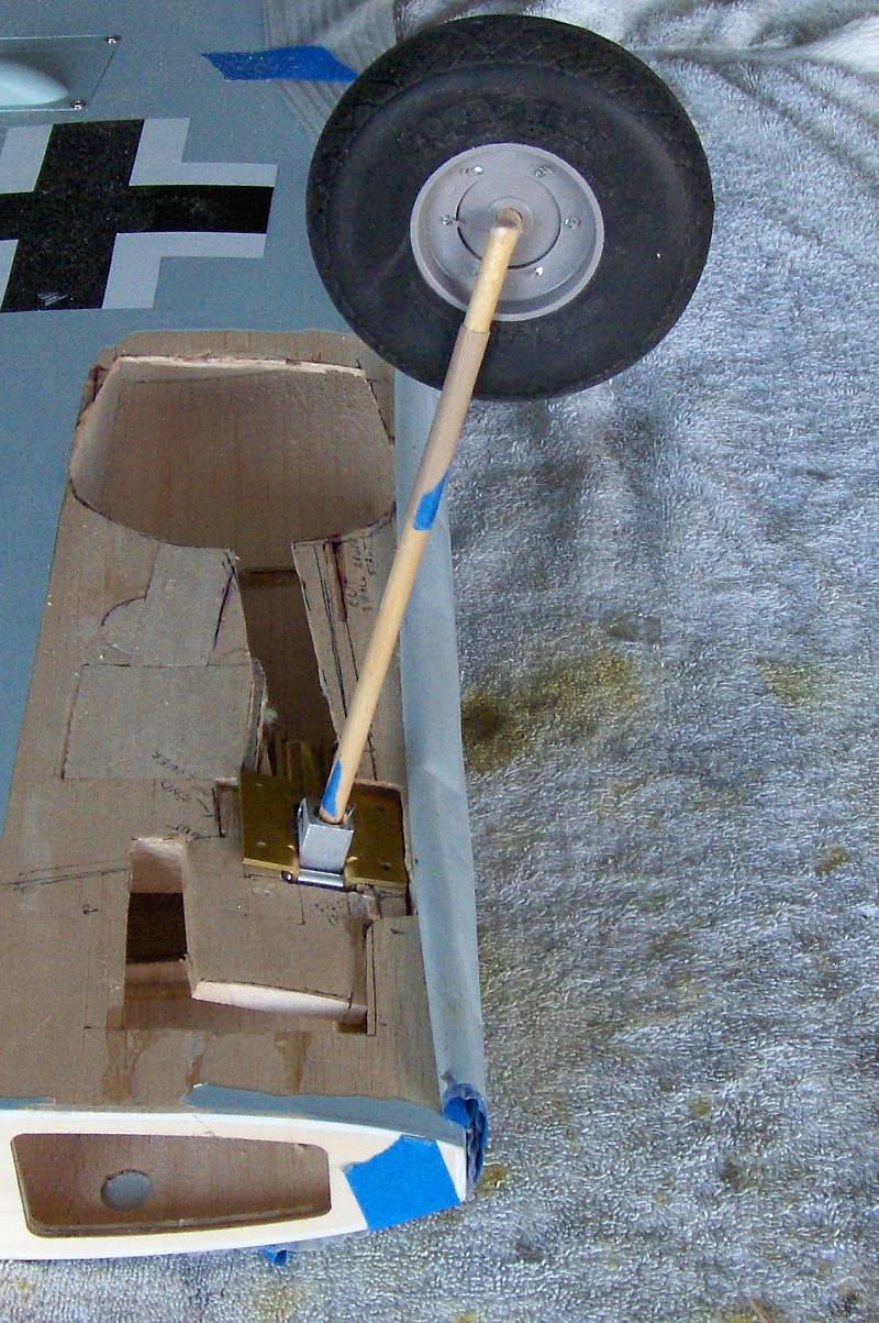

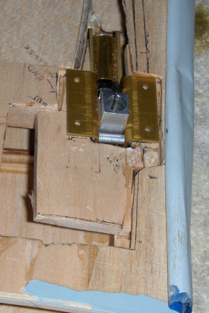

Old 09-12-2008 | 08:17 PM
  #166
kahloq's Avatar
Joined: Jan 2006
Posts: 4,295
From: Fort Collins, CO
Default RE: CMP BF109F BUILDING THREAD
ORIGINAL: SCALECRAFT
Kahlog
If you have a minute, please help me understand.
Why would the arf builder not just shim a standard air retract to achieve the degree of forward rake as desired/needed?
Also in an air retract system, the desired gear down position can be achieved with shims as well, due to the air cylinders having pressure in them at all times. No binding as with electric/mechanical. This air pressure on my planes have always been enough to keep my gear up even when the retract has no locking up position. Since the air pressure is enough to keep the gear up, the gear down position can be in the position you want. And in the down position is where the locking design is important.
So the up position goes up till it hits the top wing and stops. The 120-150 psi air pressure keeps it there. No air loss, (quality system and installation) no battery drain, nothing.
There are many readily available air retracts that will work here. Its not special design, the Spitfire retracts out there will work as well.
I can make any air gear system work in the CMP factory design, as can anyone. The retracts in my CMP 109 are for my CMP Zero
As far as tearing models apart, thats just a disorder I guess.
Steve
Scalecraft....you misunderstood what i was saying...or maybe I didnt describe it right. Shimming wont help the problem on the CMP wing. I know what your refering to and ive done that on the KMP ME-109. The forward rake I am reffering to is simply how the gear rails are kinda parallel with the leading edge of the wing, yet the strut channel in the wing is angled forward. So normal retracts cant fit in there. It was designed with bent wire retracts in mind. I can take a pic and illustrate what Im referring to if you like.
Old 09-12-2008 | 09:29 PM
  #167
Joined: Sep 2005
Posts: 96
From: San Diego, CA
Hi KAHLOG, Saw your post about the retracts and 3 blade spinner for this BF 109 from CMP.....[sm=thumbup.gif] I would like to purchase both of these items when they are available !! Let me know the details when they become known to you, please. You can email me if you like. [email protected] Thanks[sm=teeth_smile.gif][sm=teeth_smile.gif]
Old 09-12-2008 | 10:21 PM
  #168
SCALECRAFT's Avatar
My Feedback: (13)
Posts: 2,649
From: MONTEBELLO, CA
Thanks for taking the time to explain. I did misunderstand " forward rake" and "parallel to the leading edge" as it was used.
Just for infos sake, Century Jet retacts are a drop in for this model also, but flying ( and crashing) assorted sizes of pretty scale configured 109s for around 20 years led me to conclude that the current LG set up is a problem (for me anyway) waiting to be improved/solved. .
I am always trying to avoid putting new cash into a model if I have hardware that I can make work. My fix will be a few hours of fun design/building and cost relatively nothing. And believe me, I have a accumulated a lot of stuff over the years and saved a ton of money. Plus I try to make a lot of my parts from composites.
If this was something like a P-51, the LG wouldn't matter much. I have the CMP 54" span P51 and the CMP 72" span P51. They are easy on the ground.
BobQ, Basically what I have done is removed the forward rail and cut another just like it, then mount the retract to the free rails, then glue them into the "as scale" position as possible. The rails are beveled at an angle to sweep back towards scale retract position, the original wheel wells.. The rails are cut to fit between the original 2 ribs, then reinforced.
I'll post pics when I have the configuration. If you can post a pic of what you have, it would help as well.
Steve

Old 09-13-2008 | 12:02 PM
  #174
Posts: 158
From: Banning, CA
Steve

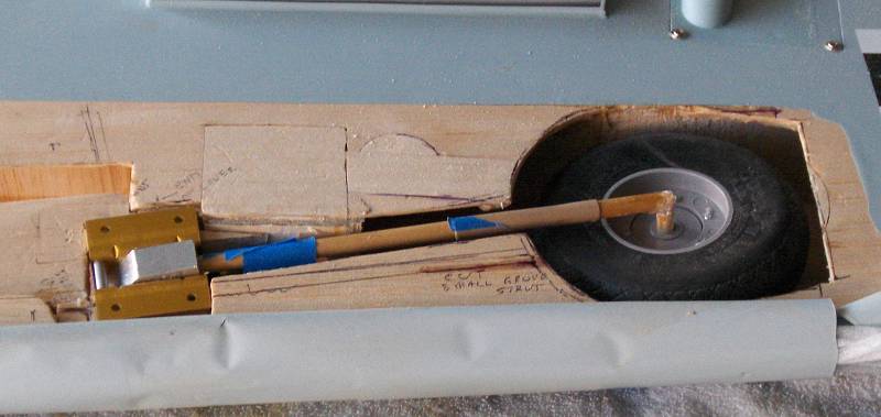

Steve,
Here are some photos of the gear installation.
#1,2 are pics of the new opening in the wing
#3, is the gear support plate
#4, is the support plate installed
ID:	1032362   Click image for larger version
ID:	1032363   Click image for larger version
ID:	1032364   Click image for larger version

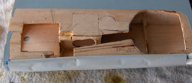

Continuation of gear installation....
#5, installs the gear retract mechanism
#6 is a mockup of the gear wire
#7, is a 4" robart wheel
#8, is the gear in the retracted position.
This was done to place the;
1. The pivot point of the gear in the scale position on the wing.
2. Position the axel center even with the wing root as shown is most 3 views.
3. Retract the gear assembly so the wheel would fit between the leading edge and the main spar.
