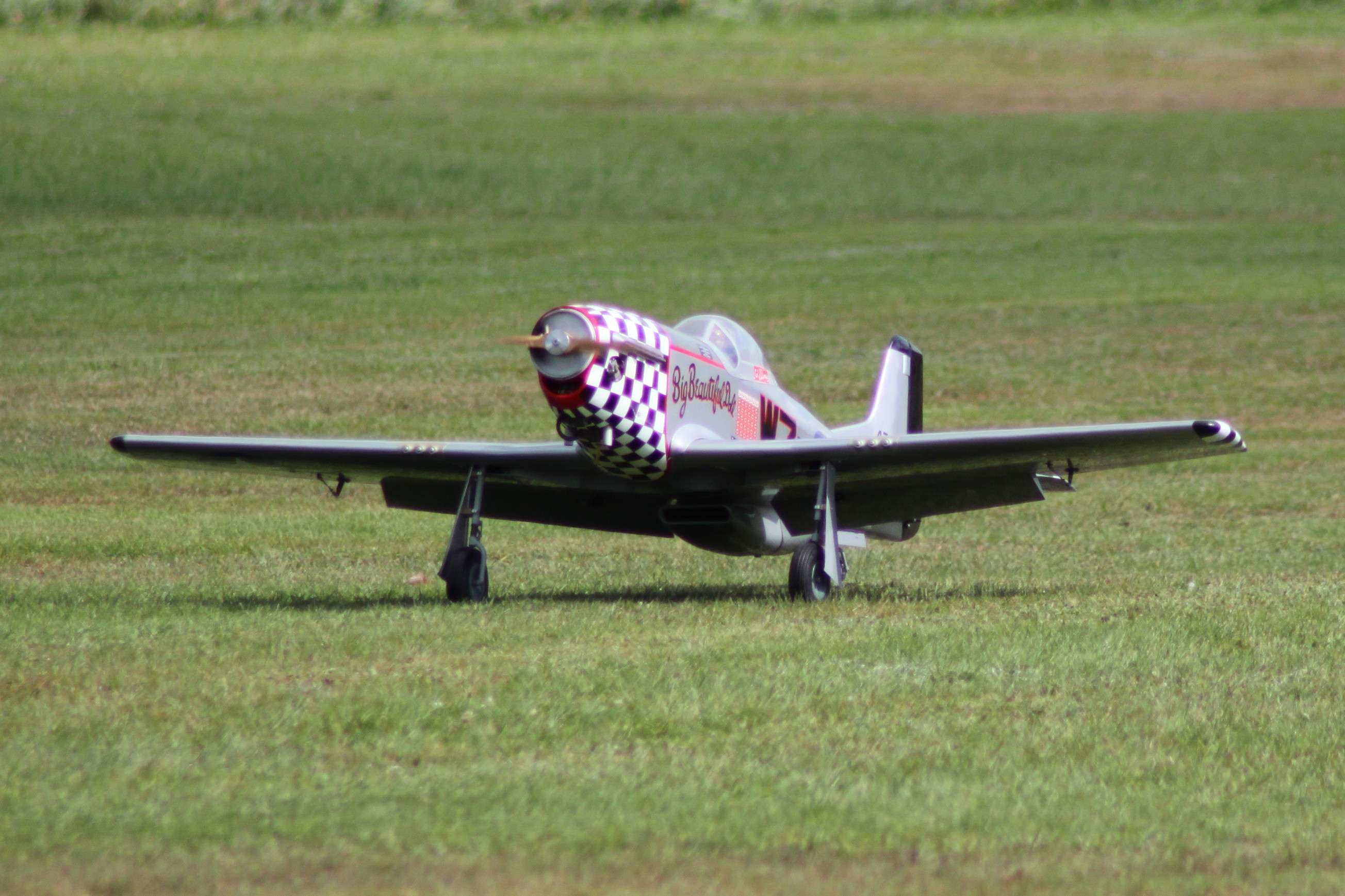

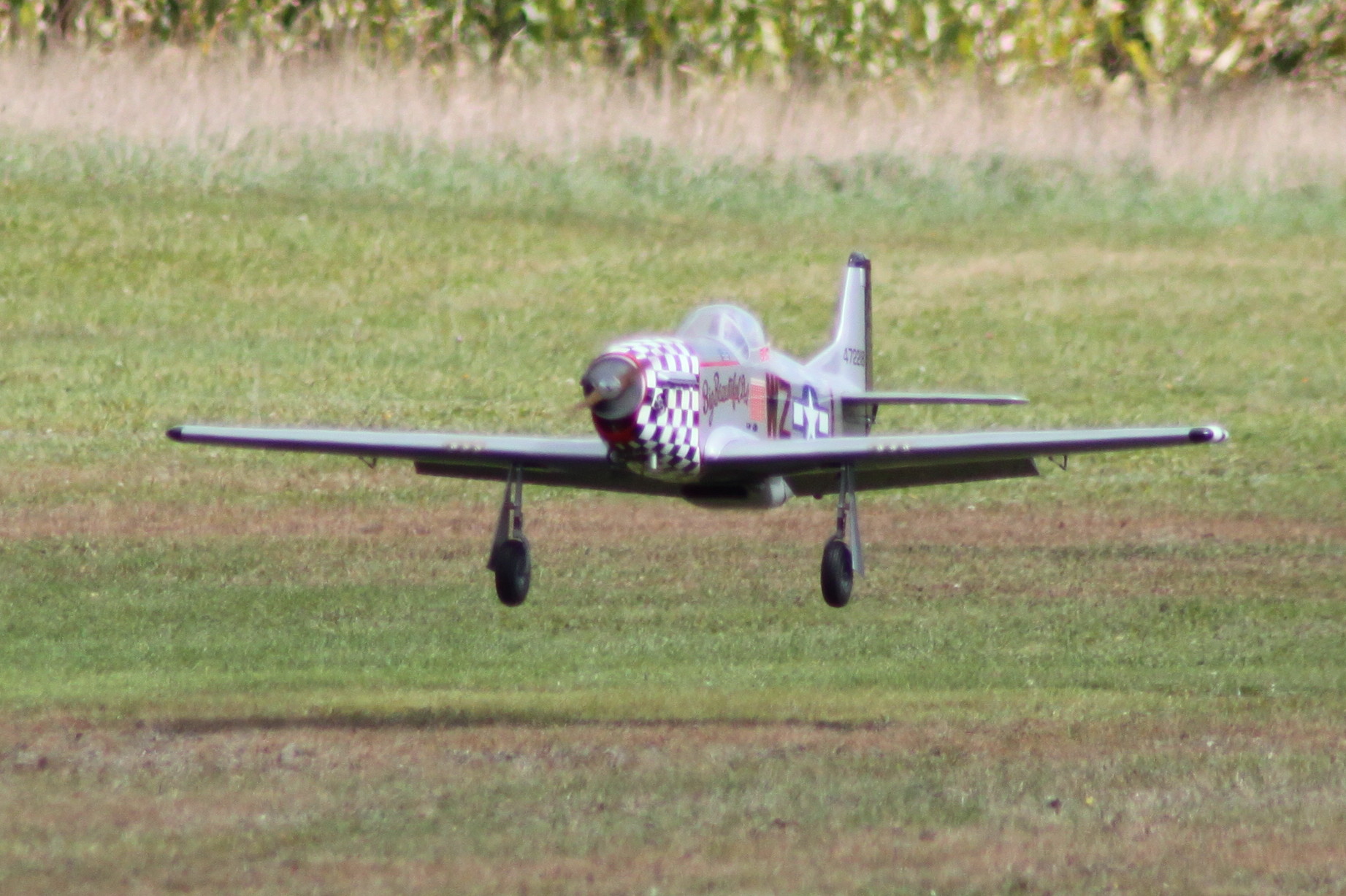

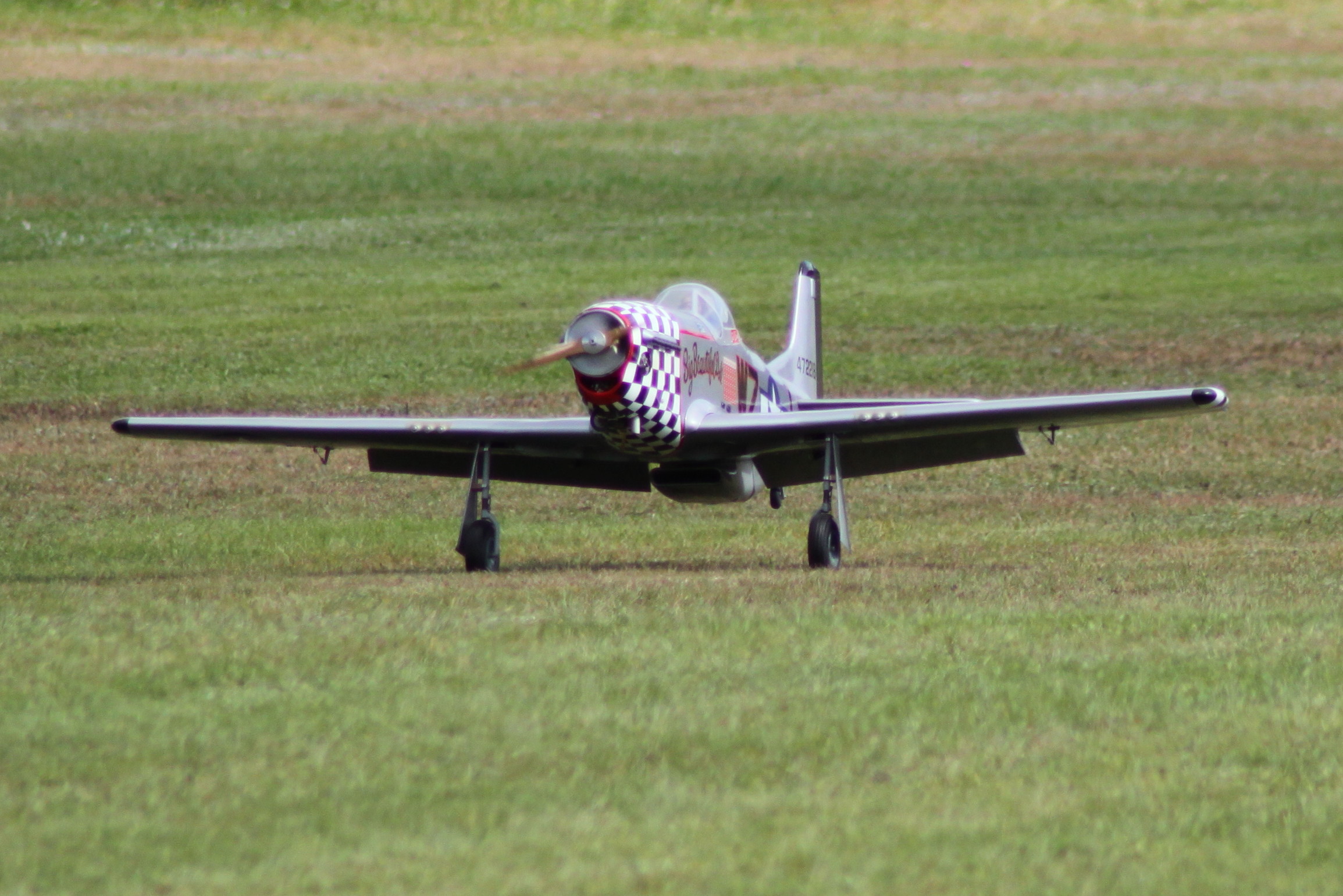

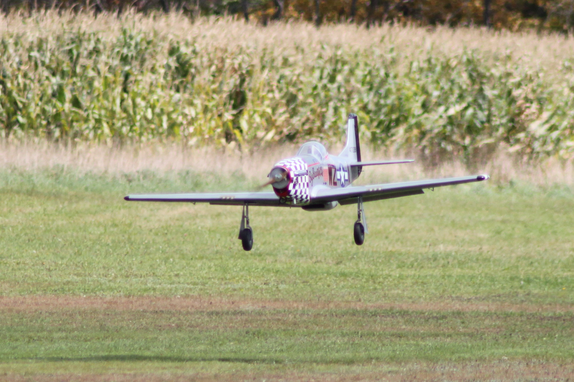

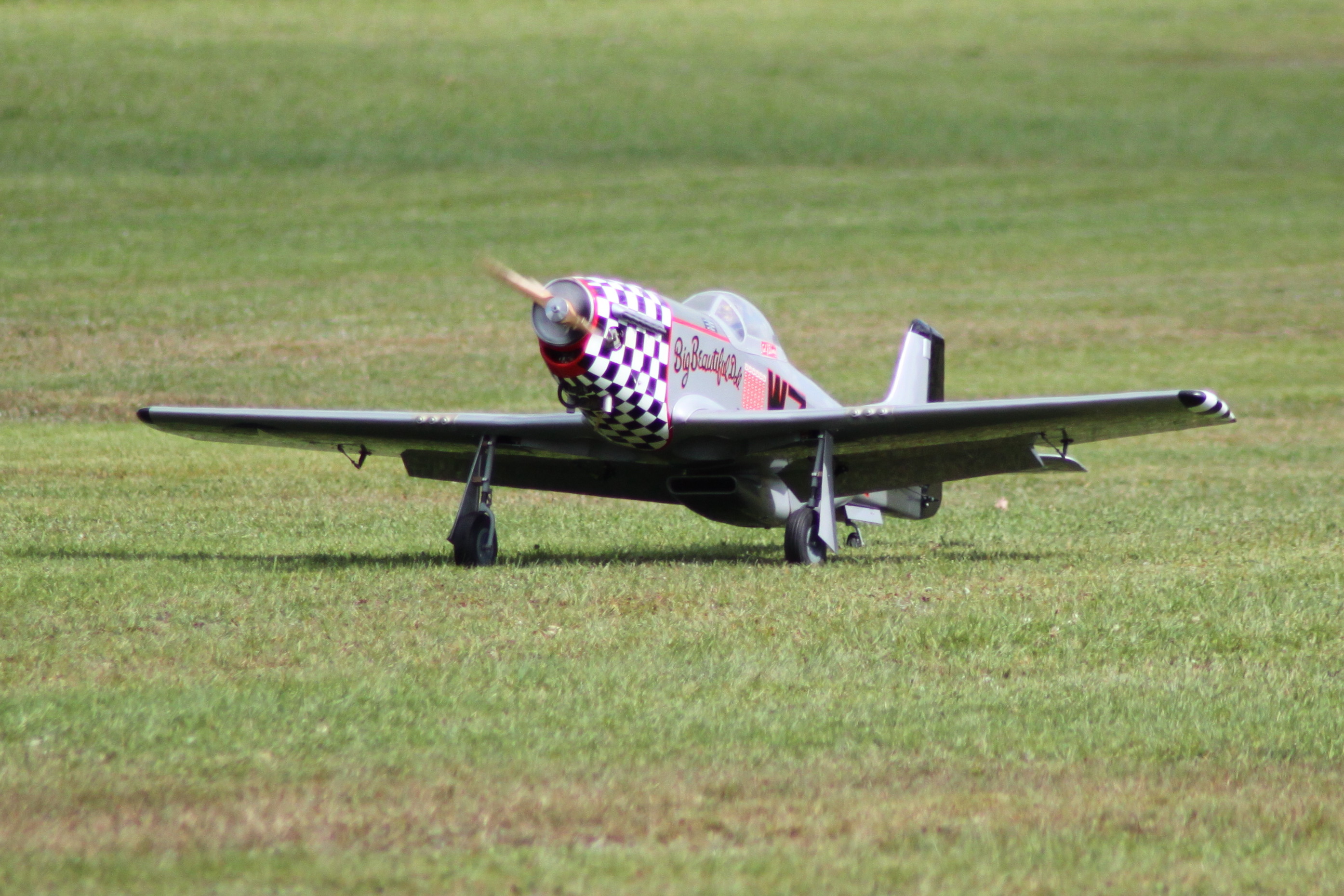

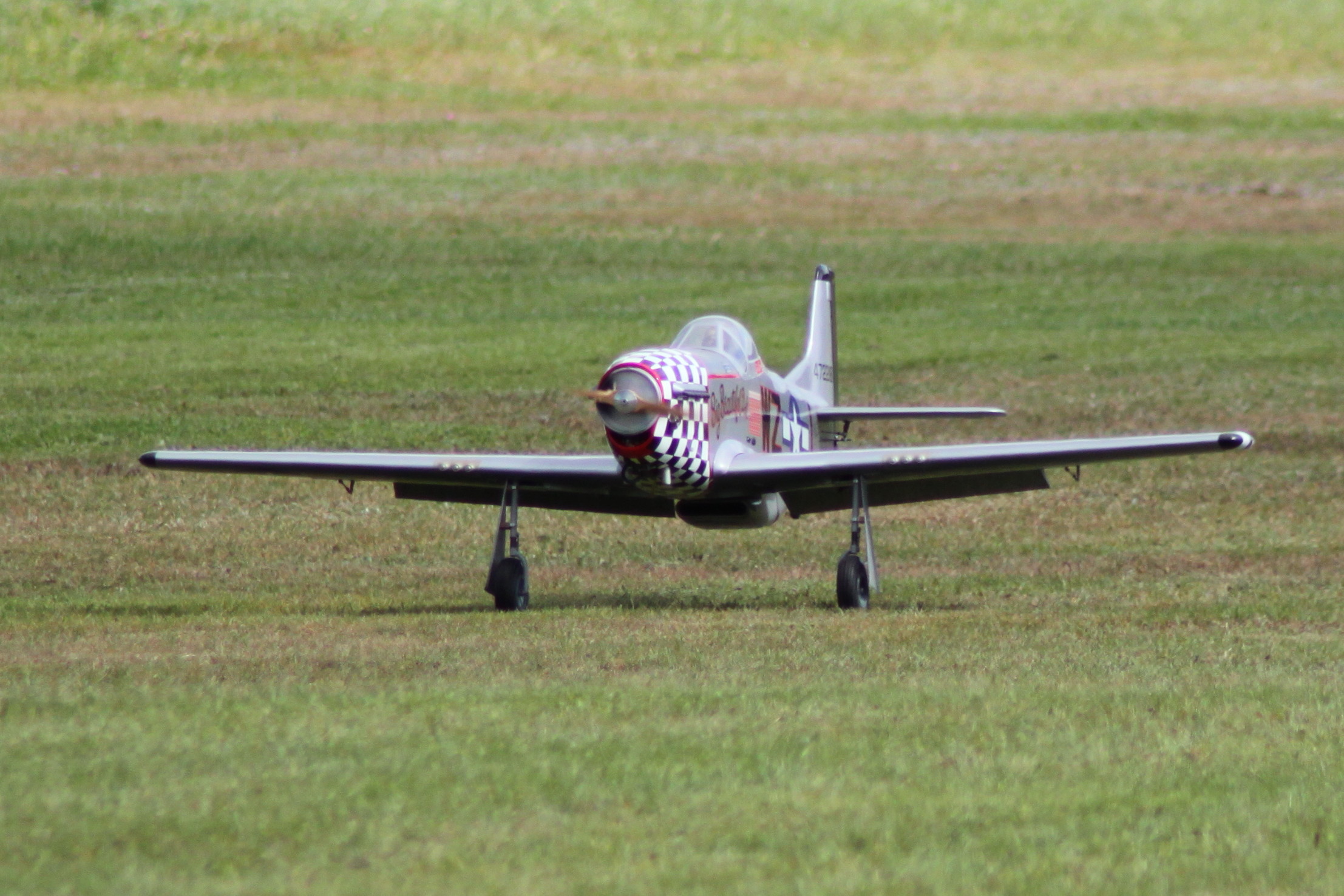

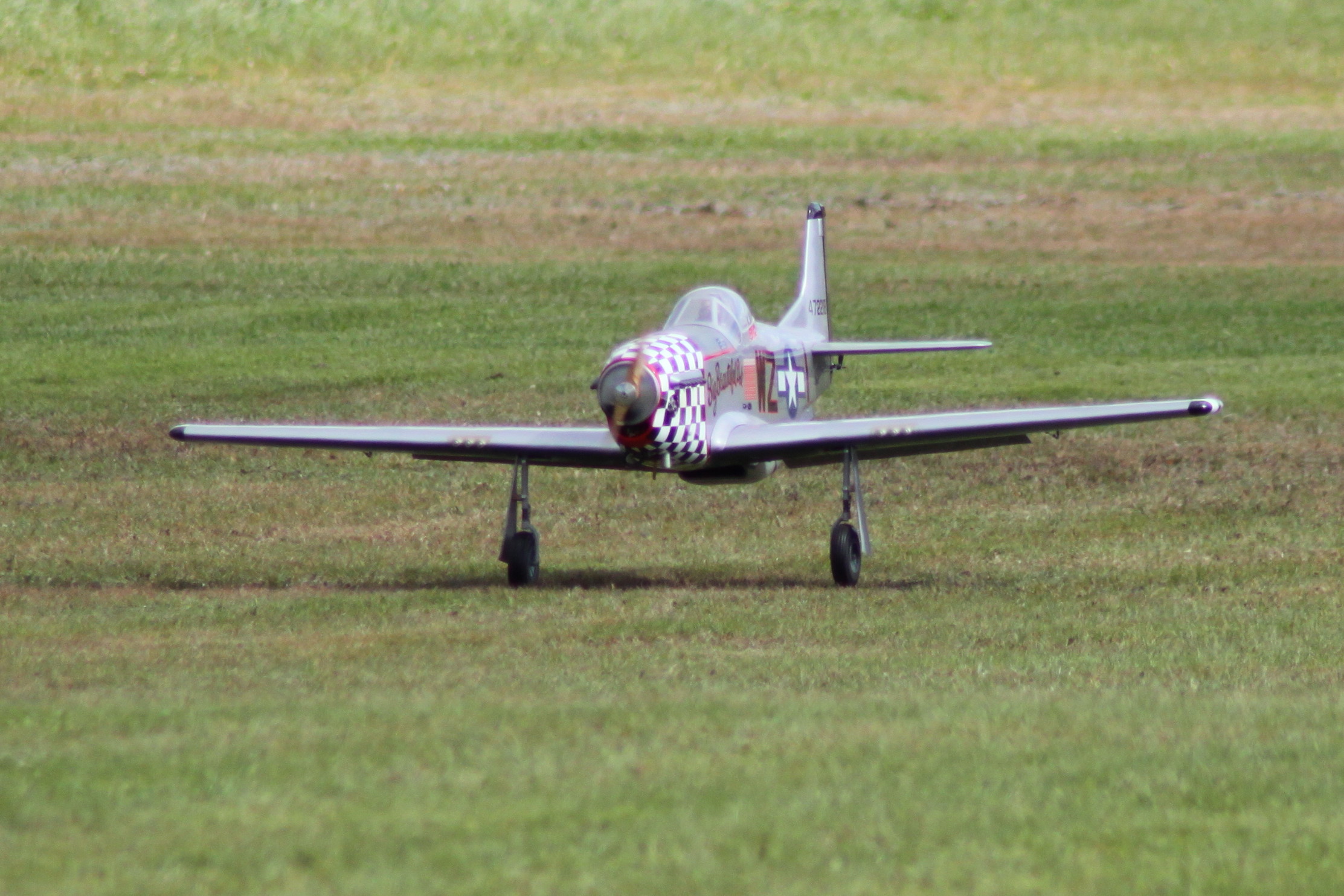

Old 07-28-2010 | 06:53 PM
  #1569
Posts: 2,922
Received 6 Likes on 6 Posts
From: Vestal, NY
Default RE: CMP BF109F BUILDING THREAD
P-51D with aluminum spinner that shreads during chase of CMP Zero.
Joe

Old 07-29-2010 | 06:29 PM
  #1570
kahloq's Avatar
Joined: Jan 2006
Posts: 4,295
From: Fort Collins, CO
ORIGINAL: messerschmidtman
do you know of an after market alternative?
Aside from the aluminum spinner from Ty, a Dave Platt spinner will work also. Its lighter too, but the dome is made from fiberglass/resin. Very hard and much much better then the crappy stock spinner. The Dave platt is a bolt thru the nose style. Ty's is designed to have screws around the perimeter into the backpalte, but you have to drill and tap them.
