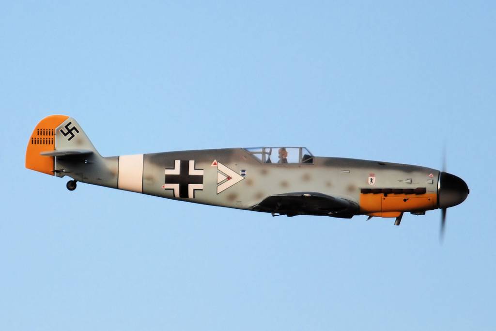

Its time for the maiden flight. I received and installed a set of "Spring Air" 85 degree retracts and now the airframe is complete. I powered the machine with an OS 1.6 glow, swinging a "Menz" 17X8 prop. I moved the retracts inboard from there stock loaction and racked them forward using wedges to get the tires 1/4 way forward of the wing leading edge. Once the wing is mounted the wedges are not noticeable. The wheel base is almost prototypical and propellor clearence is about two inches when fuselage is parallel to the ground. The stance on a level surface looks just about right. To sum up the BF109G-2 not BF109F is an excellent appearing stand off scale WWII fighter.
From all of you who have flown this model, what are the does and don'ts when taking off and landing. This is not a light airframe and because of this I need all the advise from those who have conquered this machine.

I was one of the first to fly this model. I have two, one I put together just to get in the air "as sold" and the other to make corrections to.
I posted the flight on youtube called "CMP 109".
The model had the entire air retract system installed but I did not use it because I raked the gear forward just by bending the LG wires to minimize nose over.
Mine came it at 12lbs with an old OS 1.08 2 stroke. Its a pretty forgiving airframe. It does have the tendency to pull to the left on take off if you throttle it up to quickly. As any airframe with narrow gear. Make sure you CG is right and do not lift off early with low airspeed and high angle of attack if your much over 12lbs. I am going to put a Evolution 120 2stroke in mine in the next few days. Hopefully will get to it.
Good luck

Are we talking about the same plane? They advertise the weight dry between 13.5 -16.6 lbs. Yours weight 12 lbs with an OS 1.08 installed. Installing this powerplant would require adding considerable noseweight, roughly about 1 lb. My airframe weights 16.4 lbs dry. This is at the high end. Thanks' for replying but your information was to vague.

Ok.....ive built 3 of these. The first onbe weighed 16.5 pounds with a turnigy 6364-230kv motor on 10s. It had an 18x12 prop and the sierra giant gear designed for the wing.
Plane flew well, landed rather easy with half flaps, but it did want to torque left...juts likem most tail draggers. My CG was 108mm. I did not add wedges to the gear, but did use a couple washers to rake the gear just a tad. Nose overs wherent that common, but I did try and use the stock spinner and that was the downfall of that plane. It shattered in the air(after a quick prop strike on a rare nose over take off). Plane took off, but about 10 feet up is when the spinner came apart.
2nd one I used a Dave platt aluminum backplate, fiberglass/resin spinner. Much better. plane weighed a little less at 16.3 pounds. Flew just as nice, but used an e-flite power 160 on 10s spinning a 15.75x13 3 blade. This one eventually went in becauseone of the serialed battery flight packs went south just after take off. Plane stalled and that was that.
The 3rd one still has the e-flite power 160. Weight is 16.3 pounds again, but prop is now an 18x12 Turnigy beech wood prop. Take offs are much easier as these props develop a ton of thrust.
Do make sure u gain decent speed on the ground. Don t yank her off. Keep the speed up some on landing of course till u see how it reacts at slower speed tests(up high).

Same with the spinner. the reports of those failing scared the crap out of me and, as I'M fitting a 180 F/S I am going to use one of TY's
the cowl didnt fit so that got modified.
What with repositioning the exhaust stubs, fitting flame dampers over them, & a few other twiddly bits it is nearly ready.
Oh yes, did i mention the ultimate snaffu?
Some little girl @@@@ managed to glue the motor mounting plate in upside down so giving left thrust in stead of right !!!!!! Oh brother!!!
That got ripped out & rectified as well.
A phone call to the model shop got the response " well you got it cheap didn,t you"
Customer care? whats that!
Enough of this moaning 'cos I,m pleased with the results so far, its ballancing well nose heavy with engine & radio & so far its well well below our clubs 7kg weight limit ( we are close to london gatwick &
& its a CAA (FAA to you ) requirement.
good luck with yours & I'LL keep you guys posted on how it goes with maybe some construtional pics if any ones intersted
