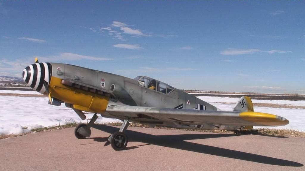

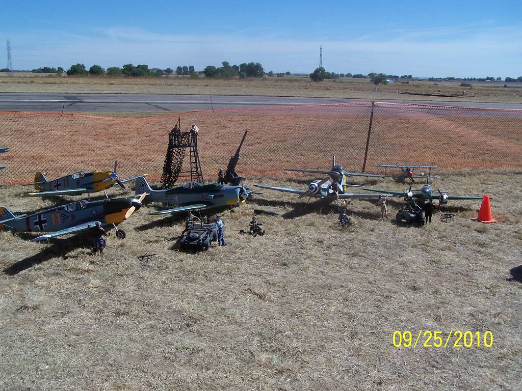

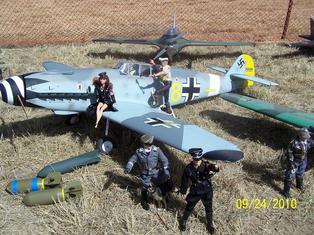

Latest pics of mine at Warbirds over the Rockies 2010

What kind of maintenance crew is sitting on the Bf-109 wing? I don't recall seeing gals like her in my history books! Wow - your pilot must have all the fun!
Bert

Its the pilot's wife

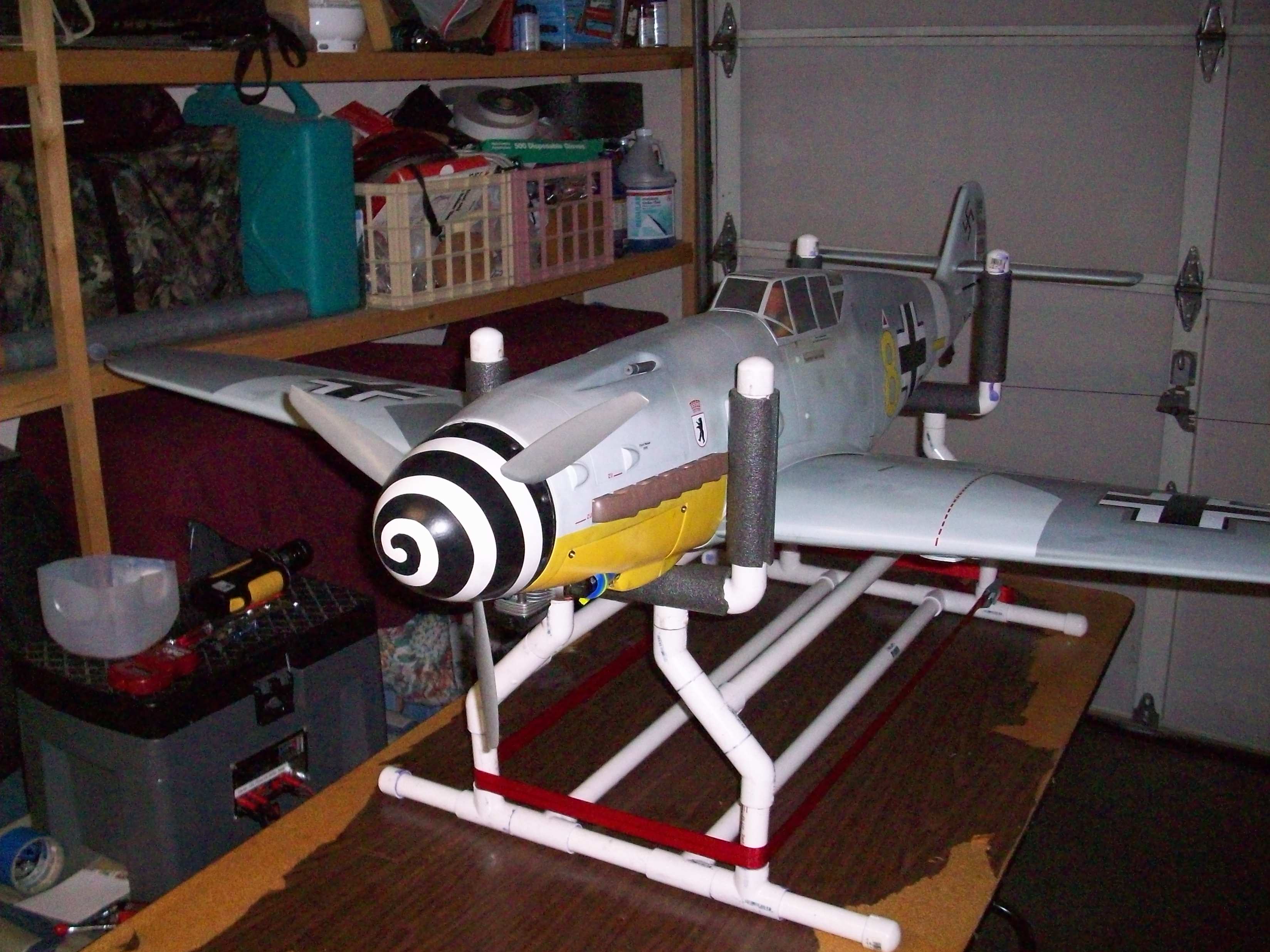

Here's what mine looks like with the 150. A 1.80 would be sweet but would probably need some mods to the flimsy mounts. The 1.60 should fit with no problem and give you plenty of zip.
