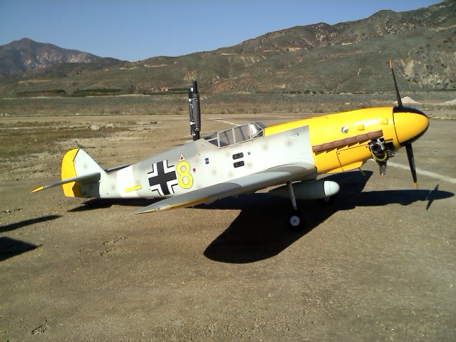

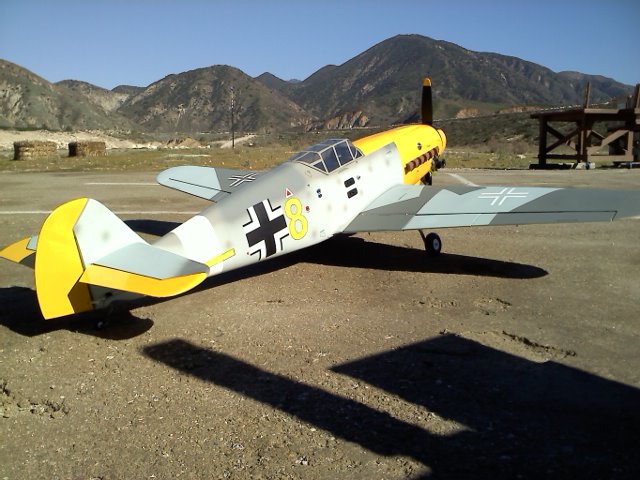

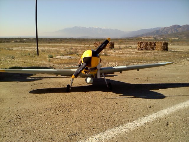

Here are a few pictures we took the day we maidened it with a camera phone, Sorry if the quality isn't the best.

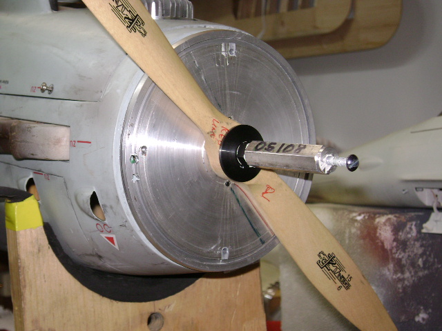

First let me point out I am not a machinist at all. I just have a lathe and a mill and the drive to make things. More than once at times.
The biggest challenge for me was to mount the 4.5mm aluminum rough disk to true. I think I mounted it to a 1" solid aluminum machined "face plate" I made to hold disks.
I used the original back plate to get an idea of where the spinner groove should be cut. I mounted the original onto the face plate and to get the approximate location for the groove.
It took two tried to get the groove to where I liked the fit. Snug, with no play, but not tight.
Once you cut you alum back plate, you will need to secure your original plastic spinner to the aluminum. I used a center bolt in the spinner along with 2 of the original mounting hole with allen/cap screws to keep the spinner from slipping when spinning at high RPM and hitting the blades. I would have used four screws but 2 of the hole were broken.
The center extension shaft is a piece of 1/2" aluminum tapped to my engine and tapped for my center mounting bolt, originally a cap screw to simulate a cannon.
Very important to use thread lock on the spinner screws because you do not want to over tighten and place extra load on the spinner.
And as always, never be in the hazard zone of high speed moving parts. Anybody.
Steve

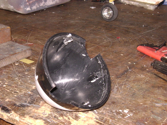

On the spinner to spread the load and look like a cannon I made a small aluminum disk to avoid having just a screw on the front of the spinner. It is contoured to "seat" on the spinner tip.

The P40 spinner broker with both glow and gas engines , I was part of the guys who purchased the plane when released , no nose over , no over tighten , no over use , no CSI investatgation , deal is , not made strong enought for the common use . If it was a typical consumer product there would have been a national recall for safety , while I love CMP , I am not a fan of how they handled the problems and incredible danger they placed modelers in .
If you use the CMP Be109 spinner or the CMP-P40 spinner, please be awared its a flying time bomb of scrapnel , its not a matter of "will it break" its a matter of when .
I immediatly moved to a Gene Barton spinner for my P40 and recently bought a carbon fiber version from Hobby King .
As far as the Bf109 I have the one that Ty made .
