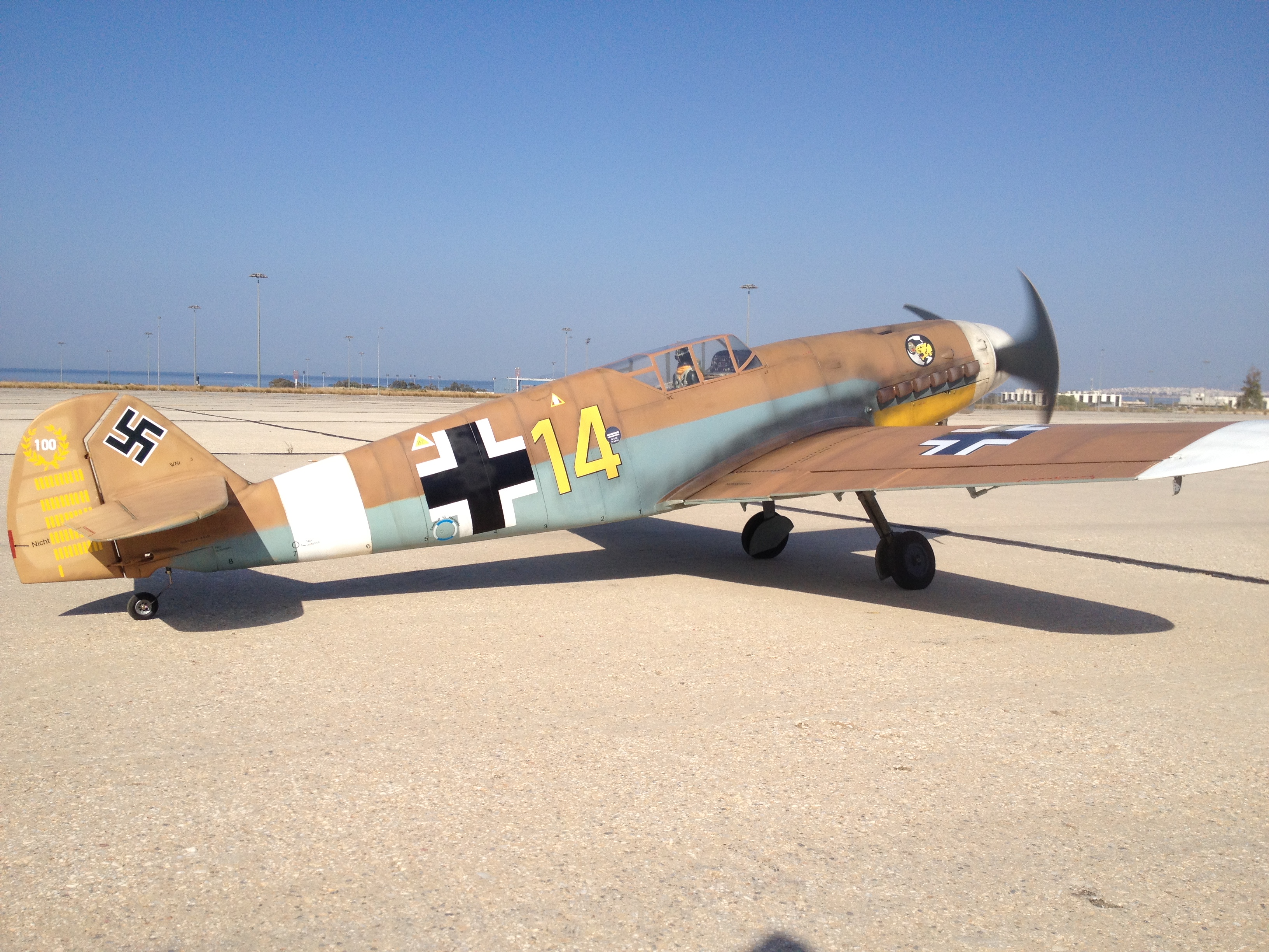

I've repainted in desert scheme "Gelb 14" Joachim Marseille.
My flying buddy's got one too, he's repainting in Heinrich Bartel's "Rot 13" JG 27 scheme, what is interesting is that Bartel's airfield when he flew that plane is the very field we fly in (Kalamaki, Athens, Greece)

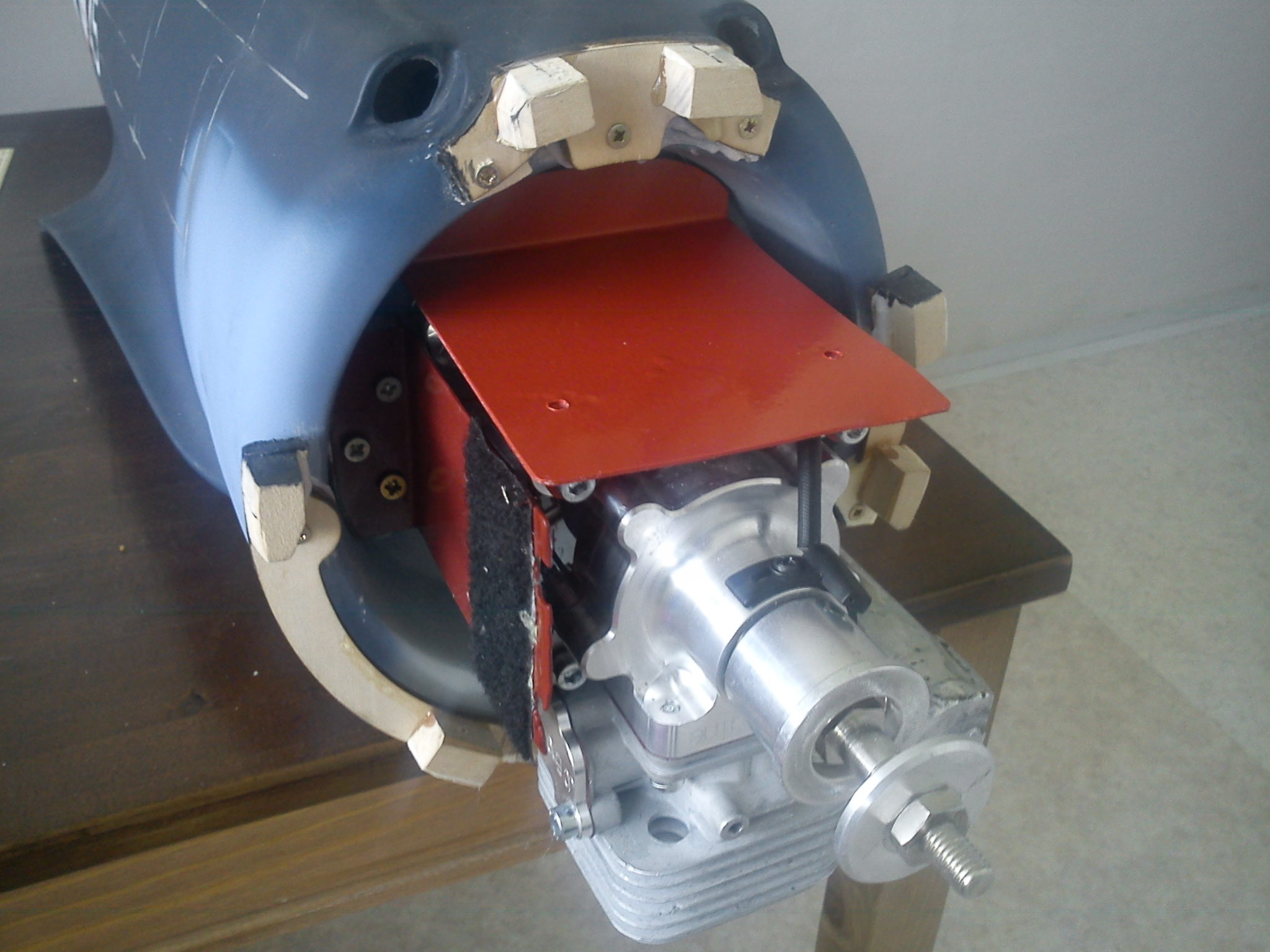

I´ve just didn´t know it yet. Now I´m waiting for an aluminium scale spinner, so we can say, that this is a weight in the nose. But this is the dark site of the warbirds with a short nose. I had to put all batteries in the nose.

- Put some stiff beams between the engine mounts and the airframe wood, the ply is soft and if you install the engine directly on it, it will vibrate out of place and possibly destroy the ignition sensor (happened to me) - see pics on post #2028 above
