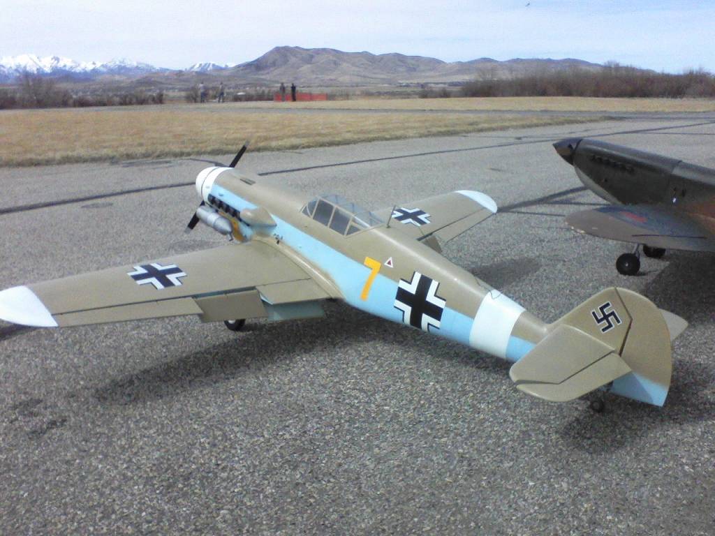

Default RE: CMP BF109F BUILDING THREAD
I made my cooling doors stationary but you still need the servo to operate the lower flap part of the radiator. This 109 has two flaps per wing. the inner which is the flap under the cooling door, then the outer flap which is next to the aileron. A couple of servos on the wing are not going to make that much of a difference with the weight. I fly my plane with a SAito 150. This plane would fly well with a 120 4 stroke. A 160 2 stroke makes this plane a rocket which is not needed. I am flying at about 4200 feet asl.
I used pieces of wood like match sticks and put them in the holes where the hinges would go and also glued the inner part of the flap to the wing. They have held well. This is a pic with the OS 160. I later got an inverted pitts muffler for it and got rid of the large standard muffler.
