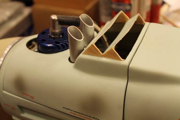

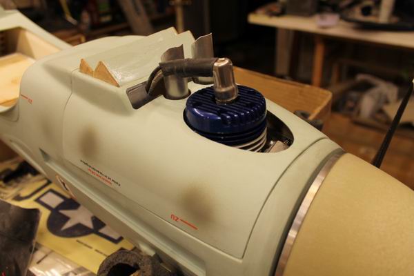

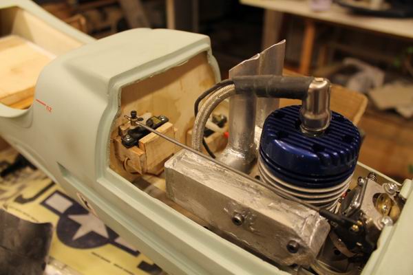

Just thought Iwould post an update to my build. I have the engine compartment completed and most of the cockpit done. Next Iwill be working on installing the servos for the tail, pushrods, and of course the tail.

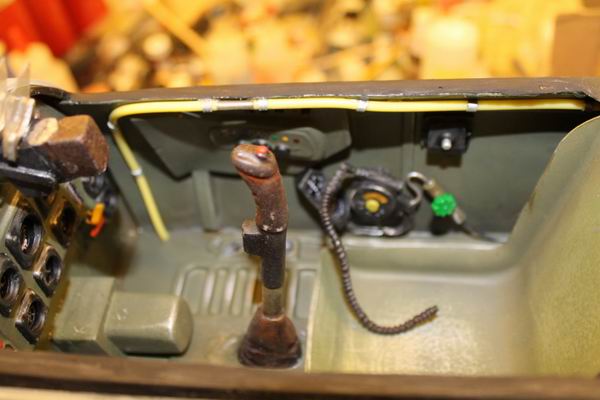

I use the Sierra Retracts, and they have some forward cant that puts the axles about at the leading edge. You'll need to be about that far forward, or nose overs will be hard to prevent. The Sierra's also do not extend a full 90 degrees, so they help the width of the gear and give the right splayed out look that you expect on a 109.
Sharpeye, I like your cockpit, I was thinking about updating mine. What have you found for a pilot? Will a 1/5 scale pilot work?

A 1/5th scale is way to big. I have a couple of Dragon pilots. I will do surgery on the one I will use to lighten it up a lot. (Replace the body with foam and only use the head, hands, boots, and cloths/gear). At 1/6th it is still just slightly to long but when I craft the body I will fix that.

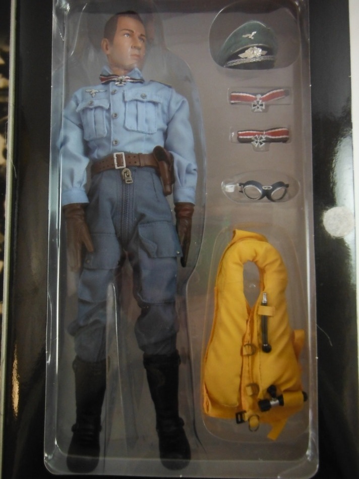

The BBI, 21 st century, elite force pilots are becoming more and more scarce on Ebay . Seems like the 1/6 action figure craze has run its course. The body on the figure is quite heavy so I recommend building a foam body. It does not take long but will save a lot of weight. Here is my post earlier in this thread. Tero T in Toronto

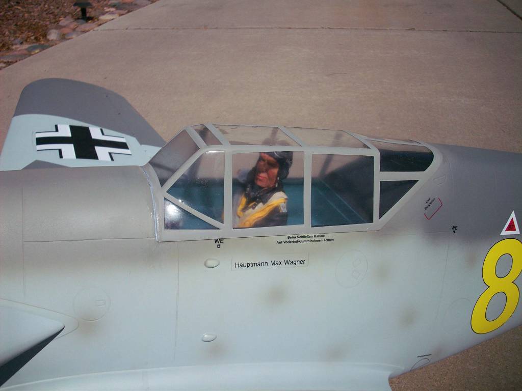

I found a great pilot from this store:
[link=http://www.acesofiron.com/home.htm]Aces of Iron[/link]
Attached is a photo of the pilot I painted and installed in my CMP Pro BF 109.
I still have not flown mine, yet!!!!!!
Bert
