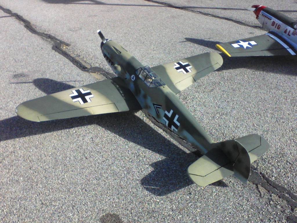

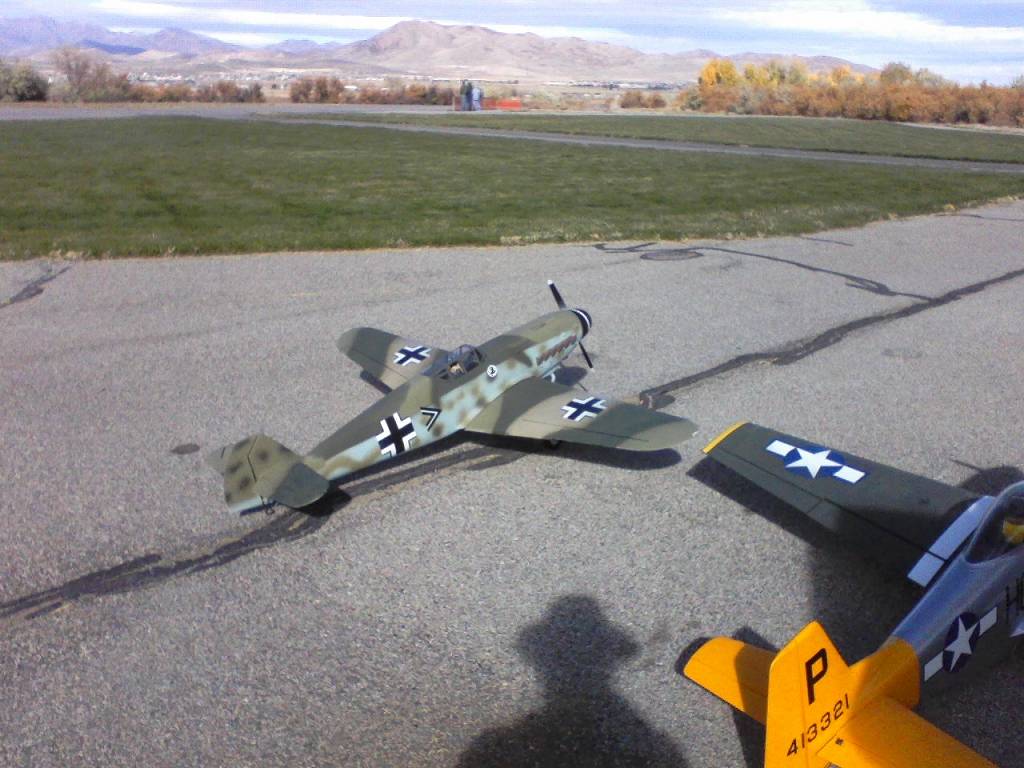

Larry,
I am using a spinner from Dave Platt. Fiberglass cone with an aluminum back plate. It is slightly smaller than the original one but it works well. I had an OS 160 in mine and thought it was way too fast, plus I had issues with it running inverted. ( 2 deadsticks). I ended up putting a Saito 150 in it and not only does it fly well it sounds better than the 2 stroke. This plane was too fast with the 160 in it for me lol.
I didnt like the paint scheme it came in so I did the desert camo for awhile. I get bored easily so I went with another scheme this Fall.
