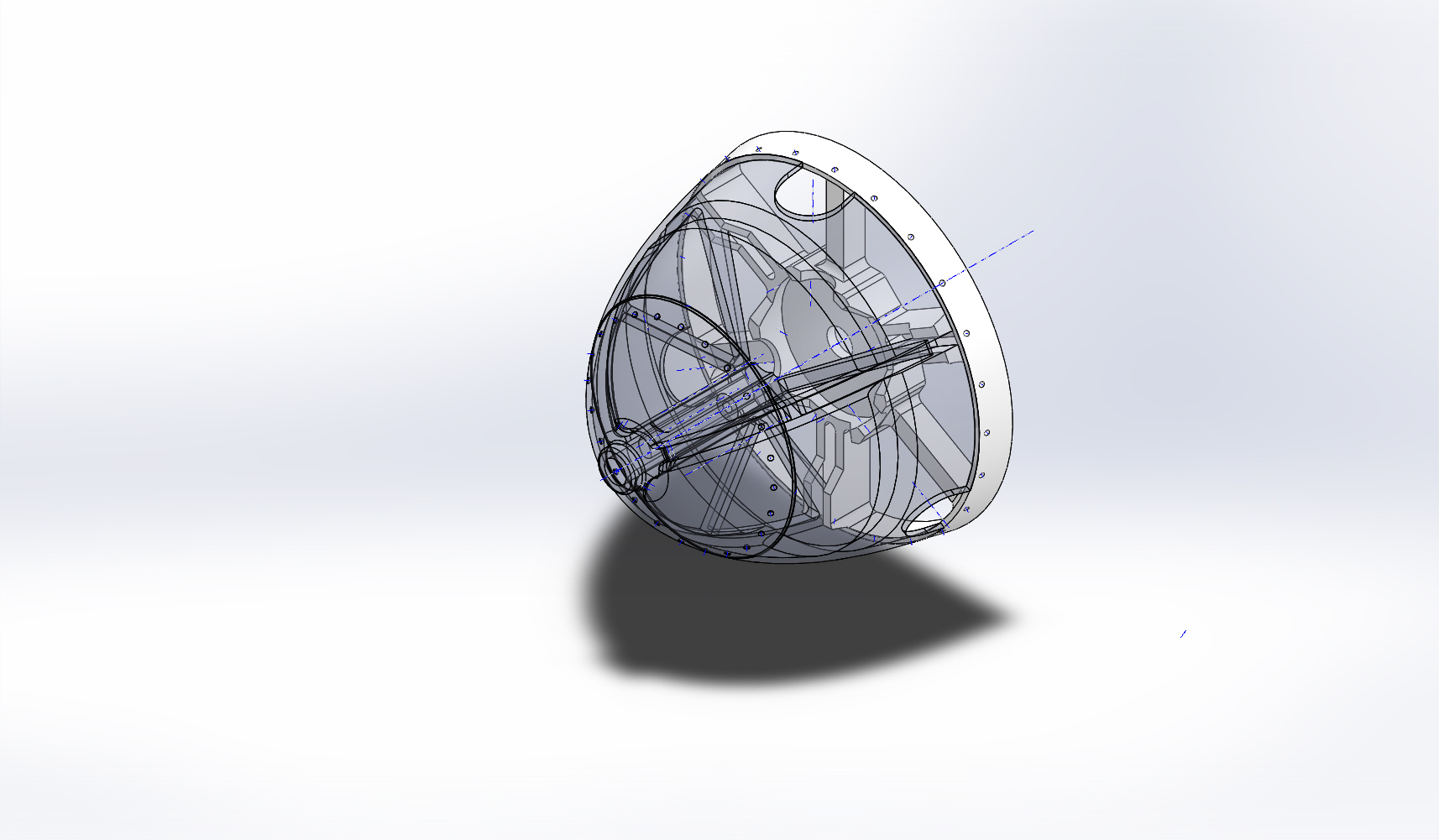

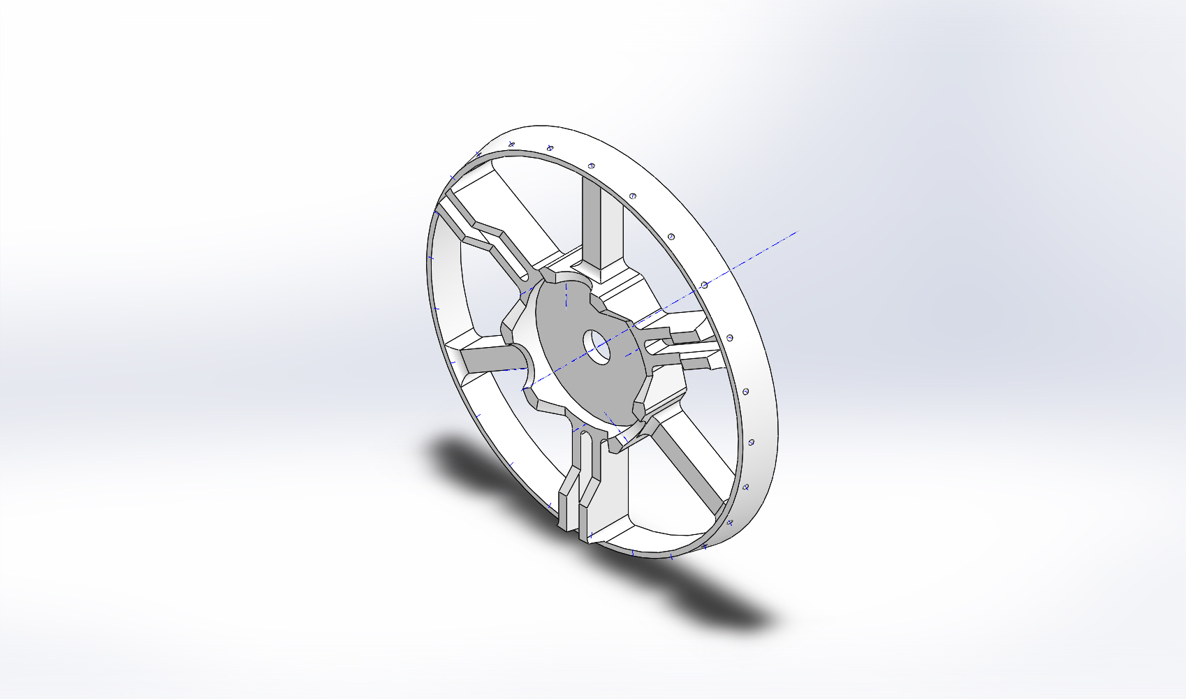

I have a 3 bladed prop spinner drawn for 3D printing , but I have not been able to print it out yet. Its designed for Ramoser 3 blader 16D hub. PM if interested in printing one.

Forgot the pics.
Name:	Bf 109 Spinner 3 Blade v3 No Prop.JPG
ID:	2103147   Click image for larger version
Name:	Bf 109 Spinner Base v3.JPG
