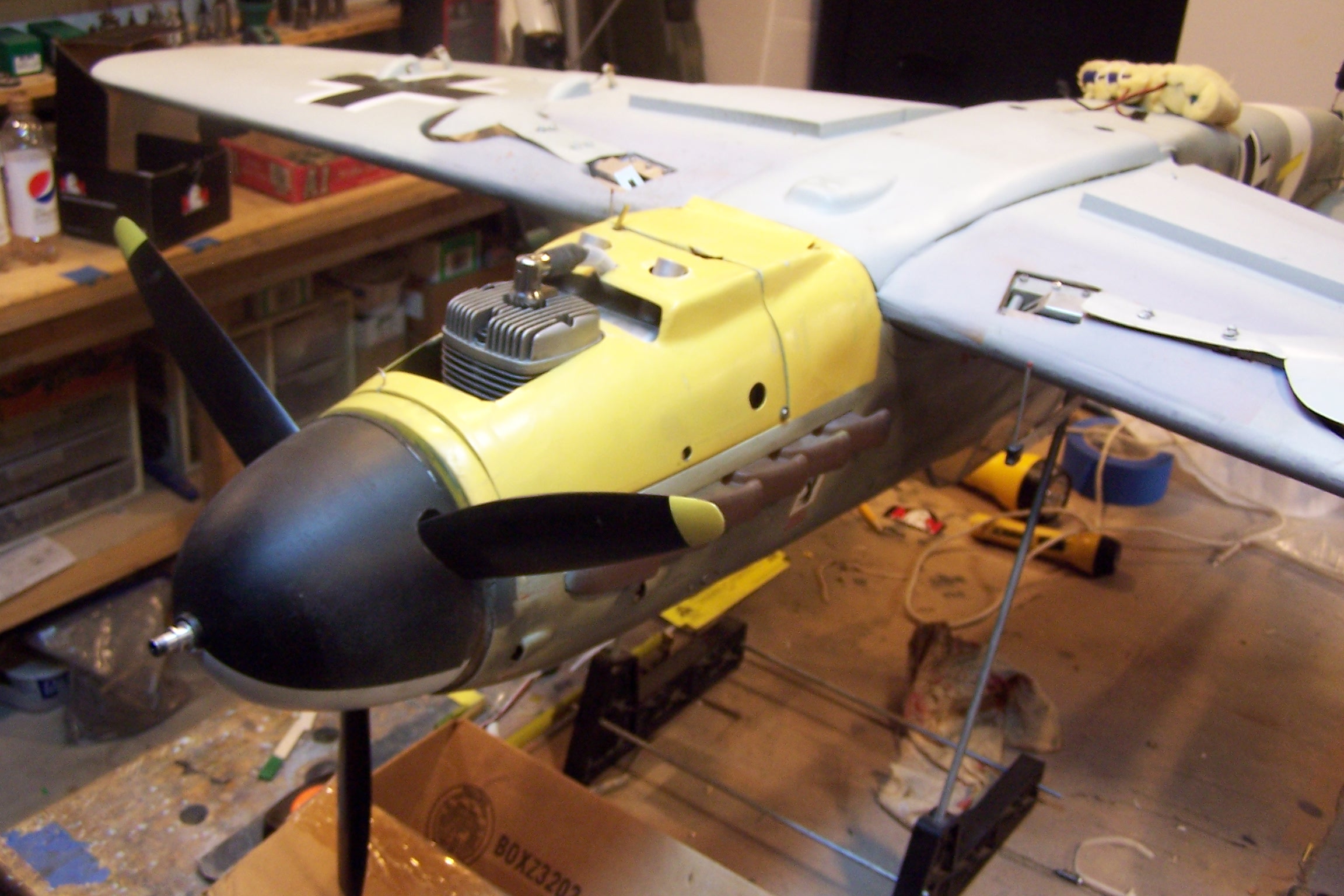

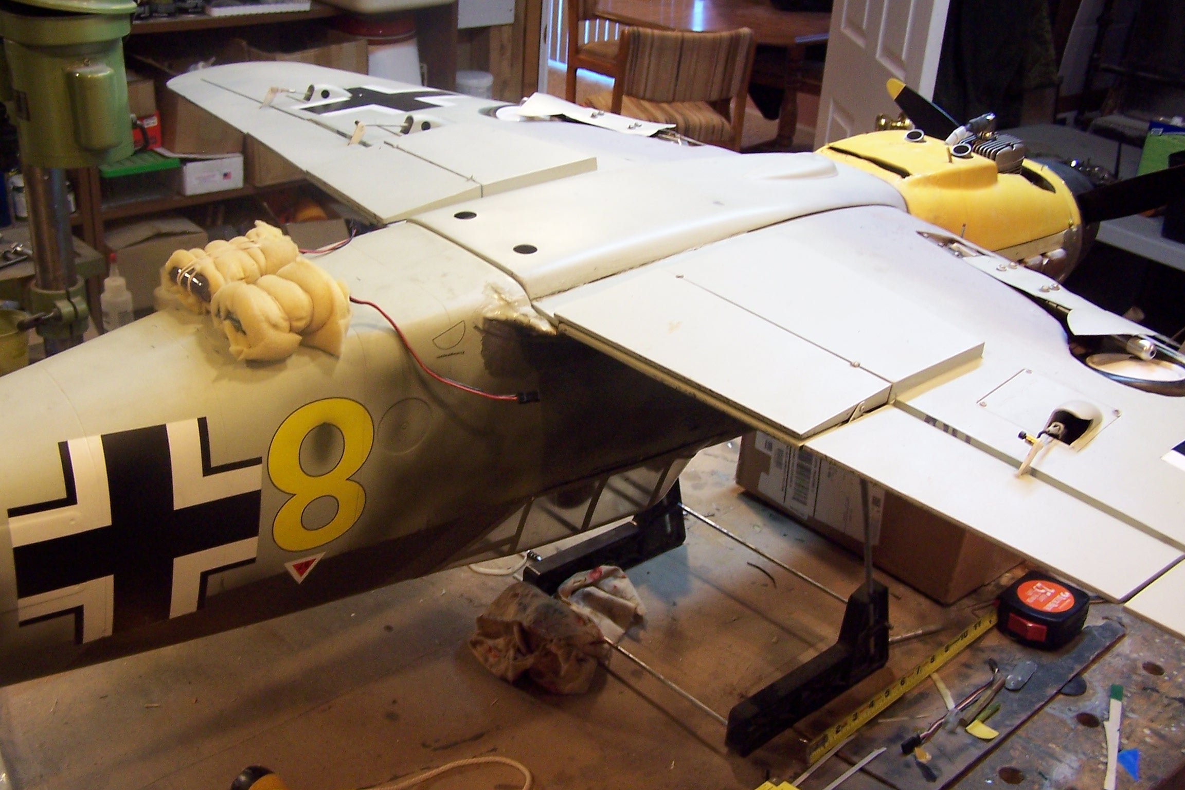

I'll try again with the pictures.

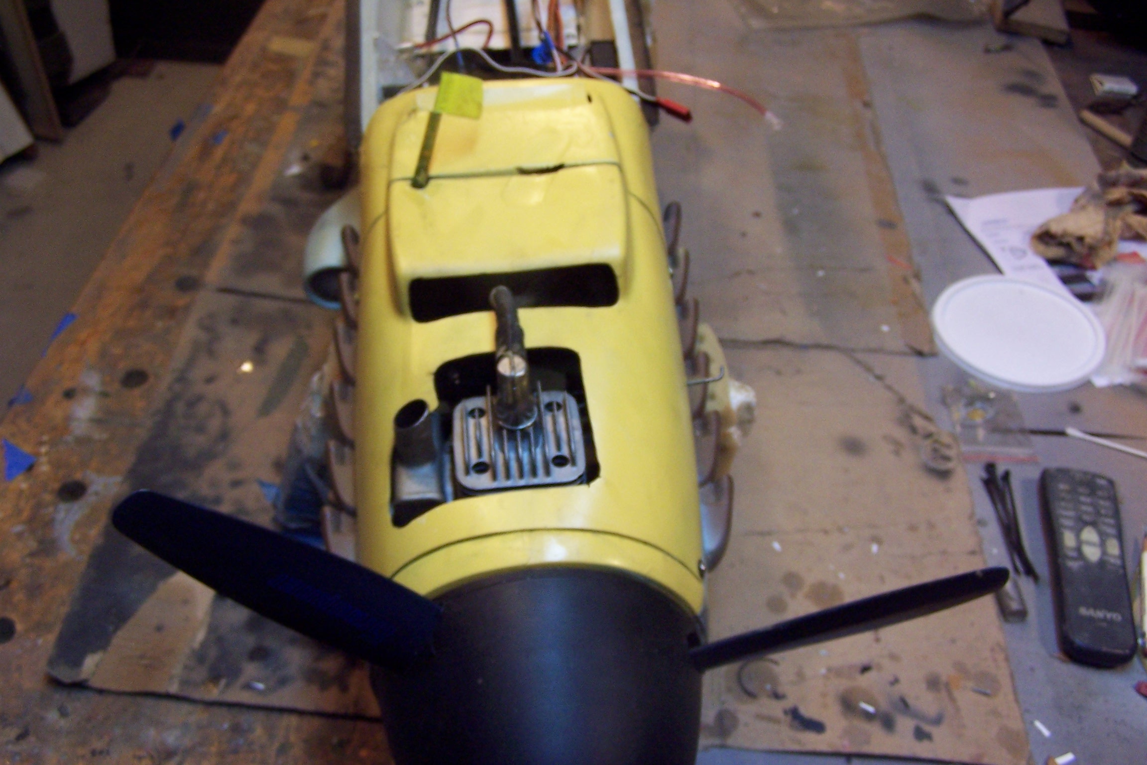

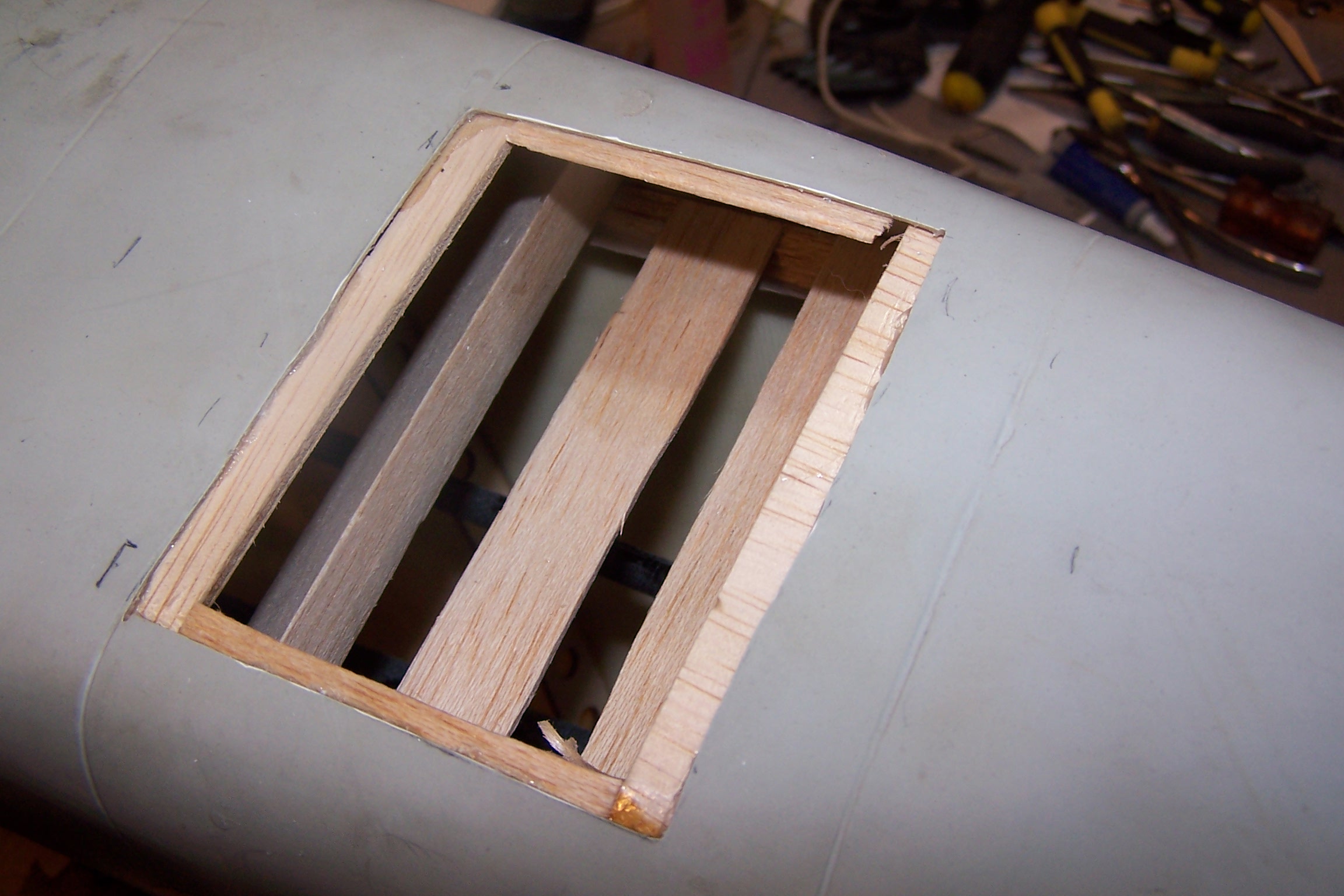

I'm going to do a little more work on cowl. Fill some holes, make outlet area opening larger, partially block the lower scoop. Shorter prop bolt etc.

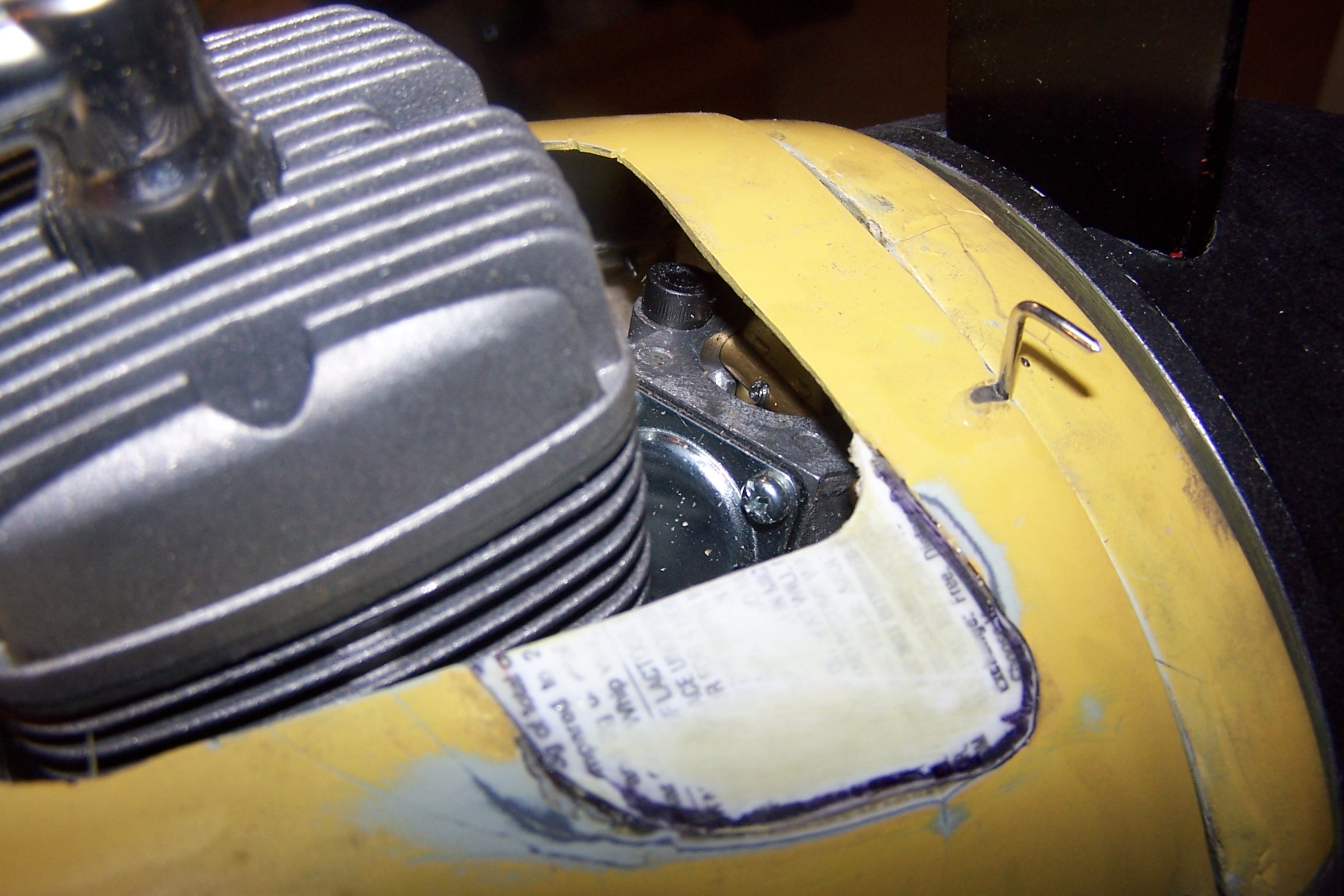

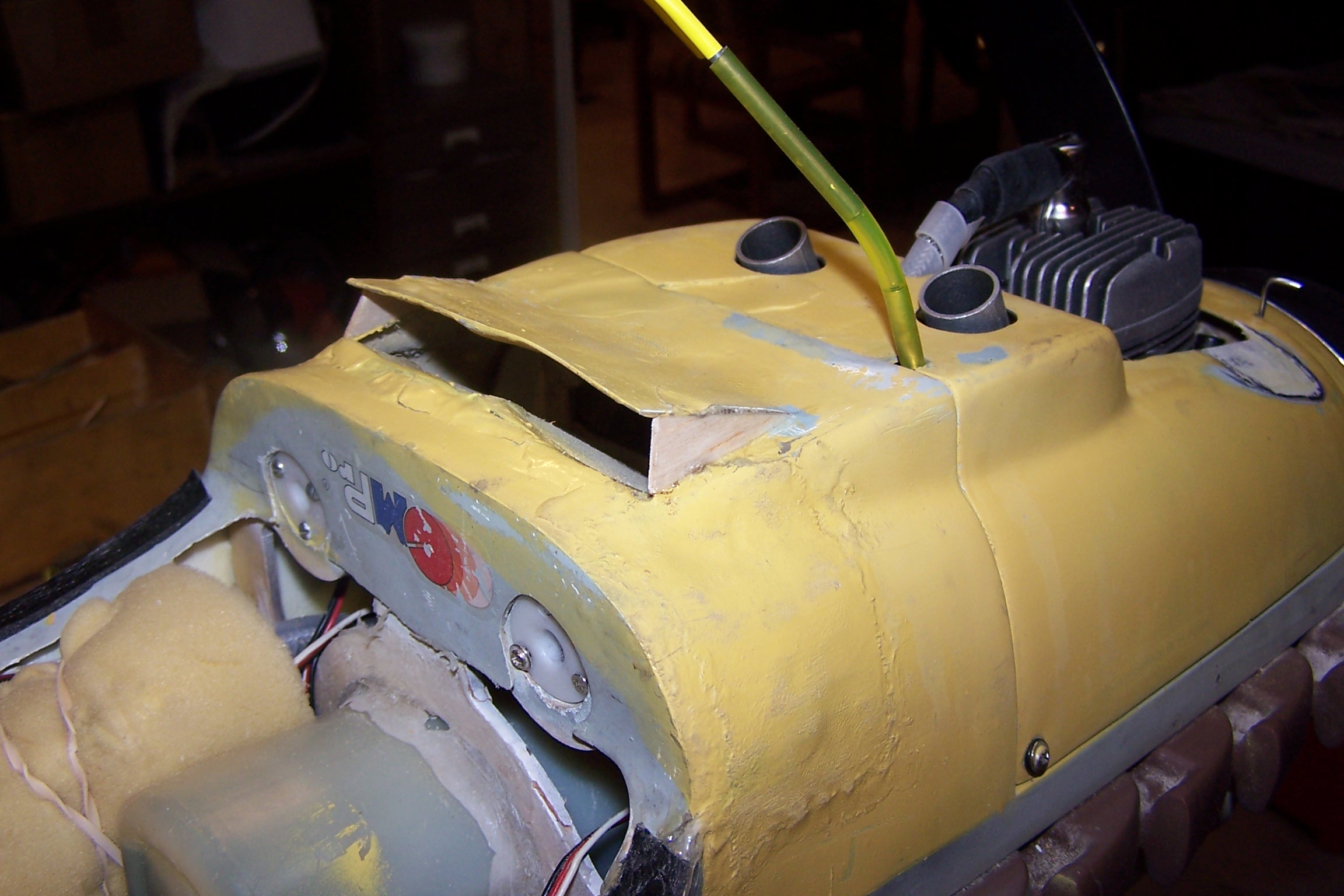

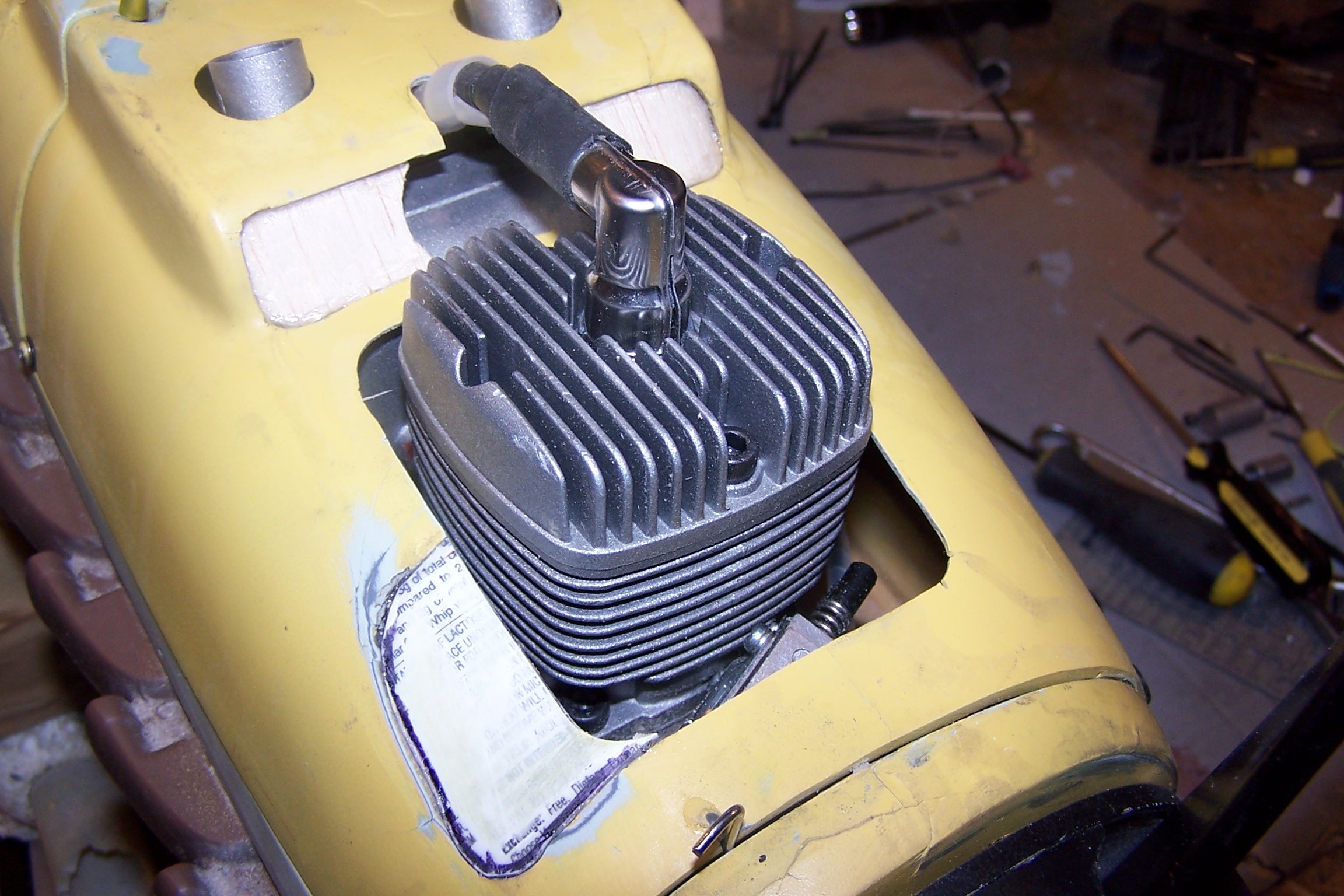

I patched up the opening for the DLE muffler. Opened up the exit area and partially blocked the lower scoop. I hope this will be enough for cooling. Thought about a scoop below and just behind the spinner, but don't want to create a high pressure area right at the carb, which might cause it to lean out too much in the air. A club member lost a giant scale Mustang with a front carb that way.

I ran the NGH for the first time today. Good idle, response and top end. Didn't tach and not sure If it will pull the 18-8 RCGF prop. I'll have to see.

Hey RBean
On my Moki front carb gassers I attach a shroud to protect the carb vent from pressure variations created by airflow
Any thin metal like soda can will do
The 109 likes speed, therefore I would recommend a prop with 10" pitch at or over 7500 RPM

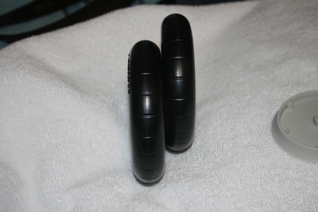

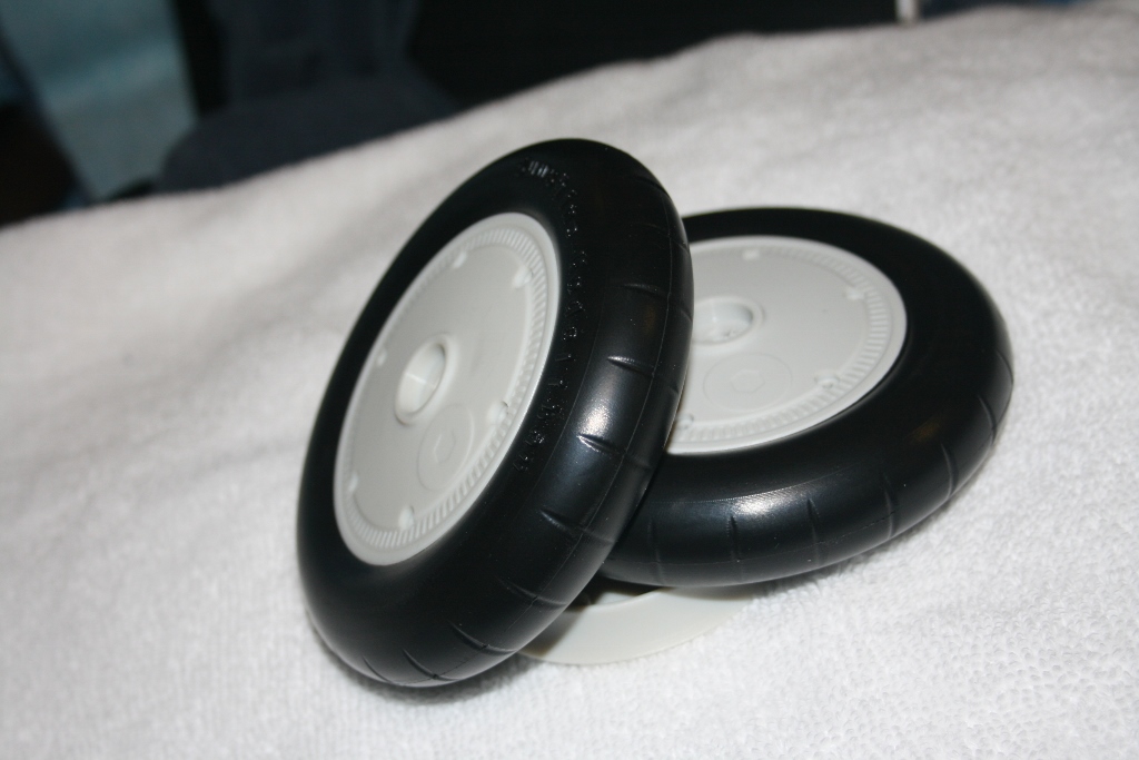

ok got some wheels from Germany(sunshine modellbau) 50 Euros a set. These have proper rubber rims (closer to Williams bros) with the right tread. These are scale to this model at 119mm although 105 mm might fit better . FYI
https://www.sunshine-modellbau.de/in...uerprofil.html
