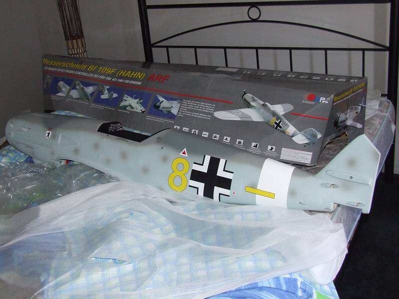

Hi guys i just joined up today,
I just recieved my cmp 109 kit and im thinking of putting a saito 200Ti inline twin in it.I sat the engine in there and it fits ok length wise but it needs a bit of a trim to get the crankcase in,Il upload some picks and see what you guys reckon,any help will be greatly appreciated.
cheers Grahame

A Saito 200 in line would be wasted on this model unless you turn a scale 3 blade.. Just my opinion. Mine flies nicely on an OS 108. See youtube CMP 109 for short flight.

I liked your 109 steve it looks great on you tube,how come you think the 200ti will be wasted?you mean under powered or just not good in this model?
thanks Grahame

Grahame -he means too much power .
This plane is light and if its flying on a os 108 ,it will fly nice on a 140 4 stroke

That motor will fine Death. It wont be wasted. The sound of that twin alone will make you glad you installed it. Yes the plane will fly on a 140 size 4 stroke...but....
Everyone please understand.....my electric powered one has a motor in it producing 3.5 HP with the 18x12 prop on it. This is MORE then a saito 220 single cylinder. The power is definitely NOT at all wasted. It can fly nice and fast, but not to a point where it visually looks like its flying too fast
So...Death...with that 200TI, it will allow you to spin a more scale size prop then a 4stroke 140.
A 140 can spin maybe a decent 16x8 2 blade...I have a 180 that still can only do a 16x8 2 blade after 2 gallons of fuel....but with your 200ti you could spin an 18x8...or a 17x10.
So dont let ppl tell you the power will be wasted. Its all in one's perspective. Sure, this plane can be flown with a measly 14x10 size prop, but does it look right? No.
