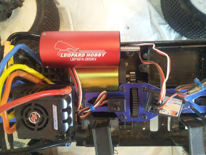

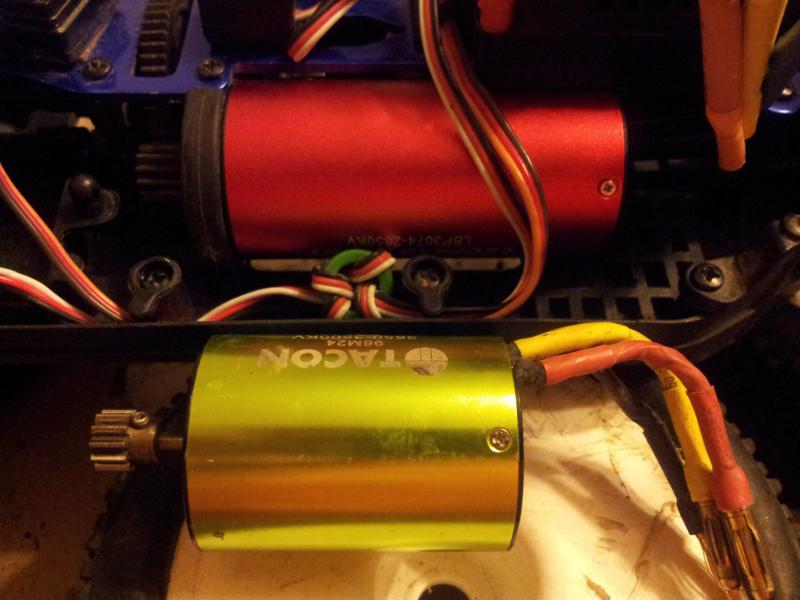

Here's how you stuff a 3674 motor into a Caldera: about the largest brushless that will go in with only minor trimming.
Put up the rest of the pictures here.

Killer job PetRock! hope you don't twist the wheels off

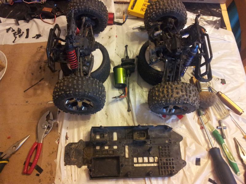

Hmm... don't know why the gearbox bearings failed yet, but a 50% larger motor probably didn't help
Bearings on the front center driveshaft gave up on life, allowing the shaft to deflect and the gear mesh to slip: metal shavings everywhere!
You can buy complete RedCat gearboxes for $15-$20, so it shouldn't be too costly to fix.

ORIGINAL: PetRock
[img][/img]
I never have less than two complete sets of diff gears for my sons Caldera on hand. They're not the best in the business.

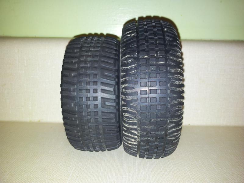

i need to replace my tires should i just replace with stock?  i see "PetRock " posted some tires but do you have links to the products?

> ok i need some help i need to upgrade my caldera minimal effort. i'll buy all the commonly
> broken parts "PetRock " posted and i got a new servo.
I wouldn't go out of my way to get everything up front: you could wait until you break something then just add a couple extra items on your order to save some shipping. But if you're planning to keep the Caldera and put lots of miles on it then it can't hurt.
