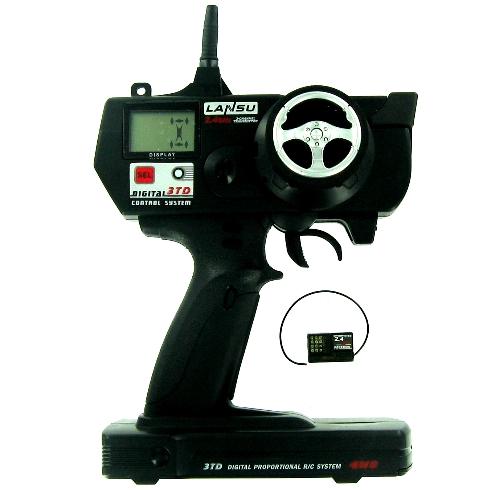

So been trying to bind my Lansu 2.4 3ch TX to a seperate redcat racing 2.4 RX and it wont bind. I have the sumo crawler and want to use the same TX on a different vehicle using
redcat 2.4 3 ch. reciever to get the steering modes.I've gone through the binding process and the receiver will bind with the original Lansu TX but not my Lansu. Any thoughts?

Essentially I want to bind my Lansu 2.4 that came with my sumo to another 2.4 3 ch RX.  Not the dsm, the other 3 ch RX that comes with the
Lansu if you were to buy it seperately.

The receiver in this pic.

does the lansu Rx have bind plug, or a button?
Old 12-16-2011 | 10:23 AM
Joined: Jul 2010
Posts: 3,148
From: West Grove, PA
Default RE: Binding the Lansu 2.4Ghz
It has a button.  Hold the button on the RX, turn on power and it quickly blinks.  Hold the red SEL button on TX and turn on power.
That is the bind procedure.

Guess what I'm really trying to figure out is can the Lansu 2.4 bind with any other 3 ch. redcat reciever other than the original one it
came with?  If not Redcat really dropped the ball on that one, especially since I was told by someone at Redcat that they will
be selling the recievers by themselves.

Just got off the phone with them and it doesn't look good.  I was told they've never tried to cross bind any Tx's and Rx's since everything
comes RTR.  I then asked why they would be possibly be selling the RX's by themselves if you can't bind the TX to anything other than
the original RX and was told that may be why they don't have any RX's yet from China.  Maybe they found out you can't bind so no RX's to
the U.S?  Too bad.  I wanted the steering options on my creeper without having to get another TX laying around the house.

The binding info was in the manual, and it does bind ONLY the original RX that the TX came with.  You can tell this by putting the RX in bind mode then turning on the TX(not in bind mode) and nothing happens, but once you get the TX into bind mode the reciever light goes solid.
If you try this with the same exact TX but ordered seperately it will not bind.
