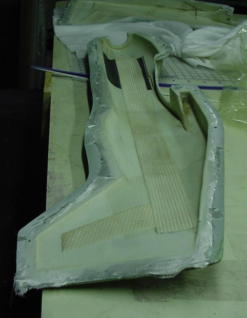

Fuselage in bag and all set for the evening.
Did you trim the excess fiberglass flush to the parting line while it was wet before vacuum bagging it?
Also is there any problem with the bag sucking down at the firewall? That seems like a long pull.

Didn't cut the glass. It hangs over and then I can trim it before joining. I've got it down now where very little is hanging over.
Not a problem near the firewall. Hardest part for it to pull down is the scoop.
Hopefully, this will be my lightest fuse yet. I used only 11 oz of resin in layup and the best combination of glass/composites that I feel will work. We'll see. Probably won't even join the fuse till later in the week. I have three midterms in my engineering courses this week. Gotta lay off the models.

Layup from outside surface inward-
primer/3oz/misc reinforcement around wing mount, tail, firewall, & other areas/aeromat/3oz
Basically it's two layers of 3oz with carbon near the firewall, and areas of reinforcement. There's a strip of glass near the stab area, some on the fuse near the te of the wing, etc.

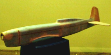

I pulled the plug and wing out of storage back at Christmas. Even took some pics of it, I will post them if I can get them developed soon.
The plug is fairly symmetrical. I have some tools that will allow me to check that for sure.
I think a q500 fuse might also be a good experiment for learning plugmaking and layup because of the relatively simple shape.

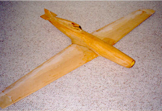

Just had to put up some pics of my plug. Carved it from solid balsa, and then resin'ed the heck out of it. The wing is from another Qmidget (15sized).
Ya'll take care......
