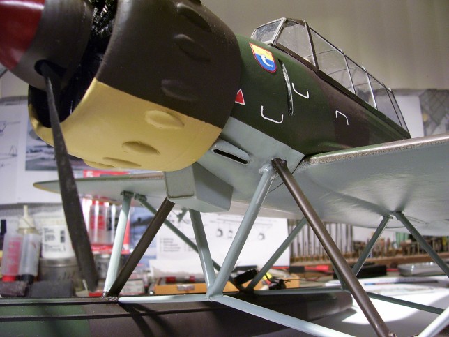

I've always wanted to try the Rufe conversion. After this project, you can pick up another Zero kit and build an AR196 conversion. The fuse really isn't too far off, with a bit of reshaping.
The dunkings really do stink. I had this one off the water and in the air, although it was a bit tough handling on the less that still water so I pulled up earlier than I should have. Almost saved it, and with an absolute perfect recovery, I may have been able to. All works after a quick dryout, and have yet to try it again.
ID:	1828259   Click image for larger version

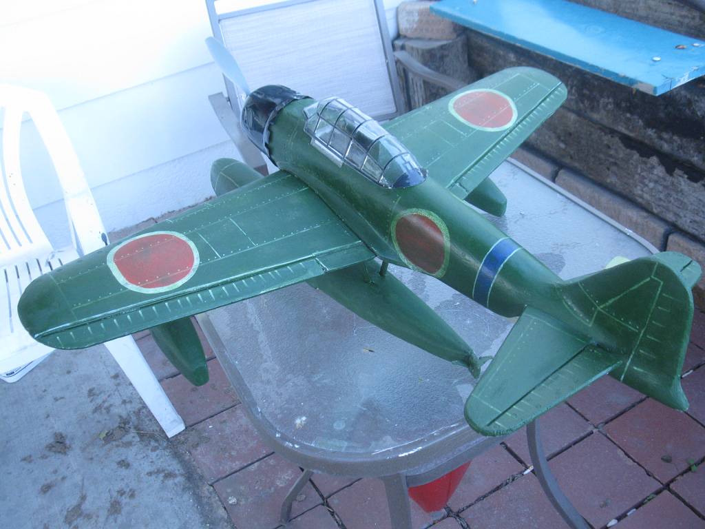

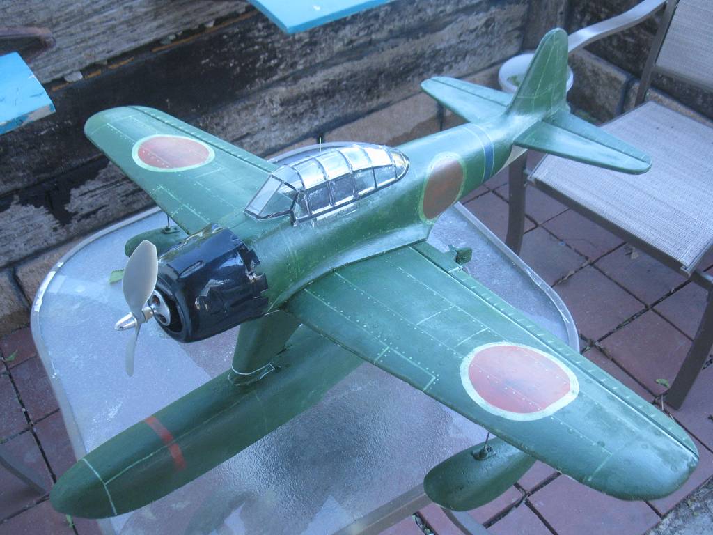

I really like these GWS birds, so it was a no brainer for me to buy this from Scaleonly4me and give it a try. Haven't flown it yet, but here's what it looks like after I filled and painted it up. I also glassed the bottom of the float to help it maybe get it to unstick from the water
ID:	1888726   Click image for larger version

very cool,, best of luck with sea trials
