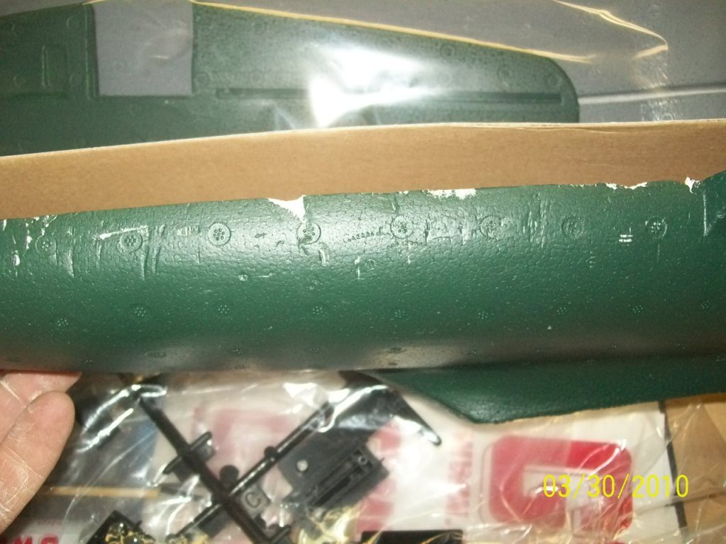

OK, I've never done a build thread but what the heck here goes
The Subject? a Nakajima A6M2-N,, Yes a Rufe a real small Rufe. Actually it will be a kit bash from a GSW Zero kit, with scratch built floats
I ordered the Kit and flight pack a few days ago and the FedEx Babe dropped it off today, the box looked like it was packaged well but upon removing the parts for inspection I noticed a little damage on the fuselage and the sticker sheet looks real bad,, I'll be emailing the vendor to see what he says about replacing the decal/sticker sheet,, the small dents in the fuselage halves I can live with since I'll most likely repaint anyway,, we'll see.
I plan to built the main and tip floats so the are removable so I can fly the plane at the park or where ever too,, we have a nice little fishing pond in town and a small electric float plane should fit in nicely.
Stay tuned,,, or not

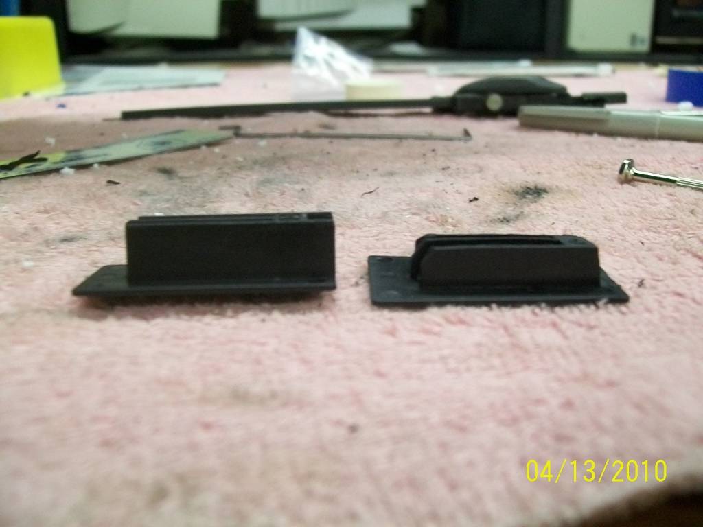

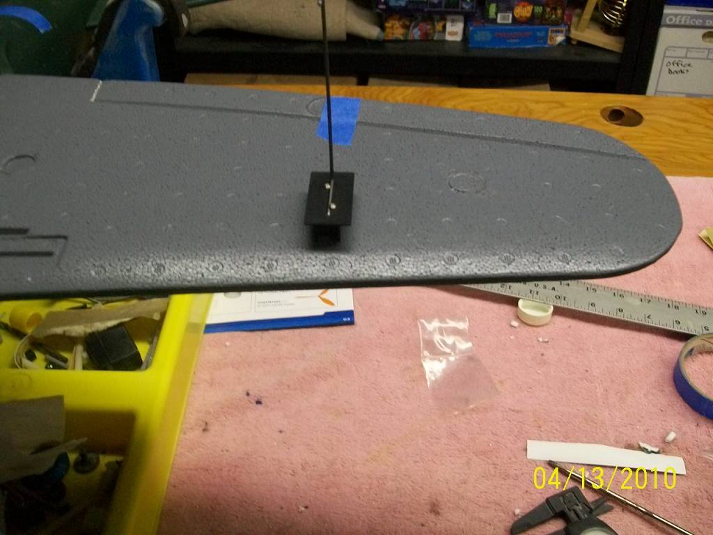

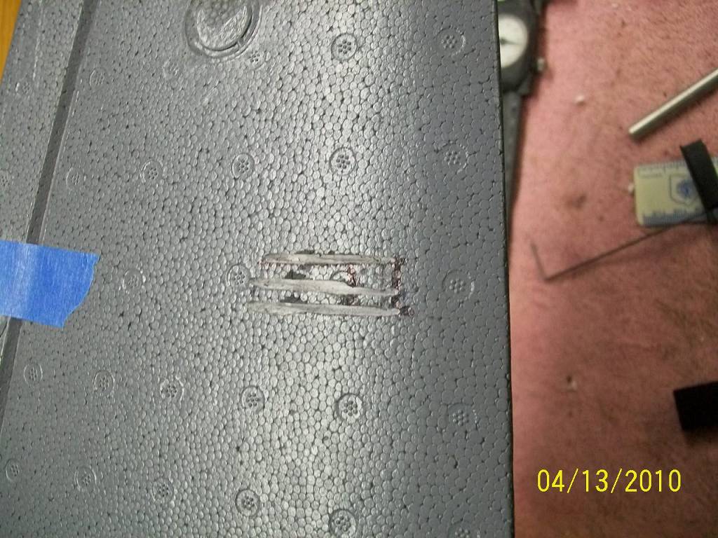

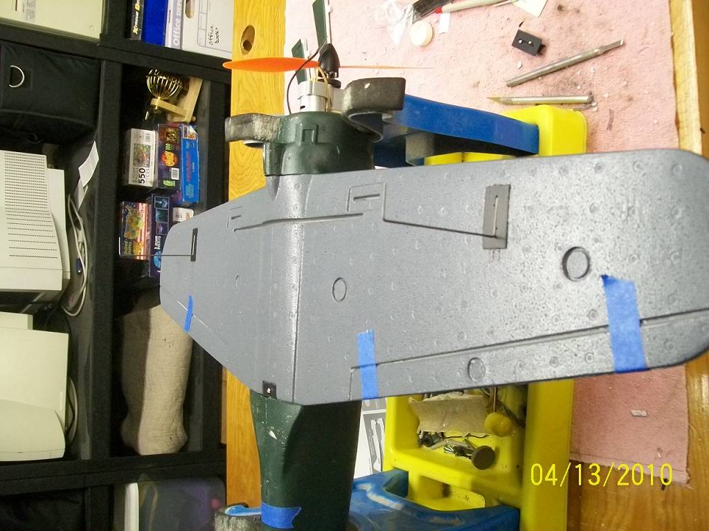

Weather was too nice over the weekend to play in the basement, but last night I started the airframe assembly, I won't post pics of that, but tonight I did get a chance to start the Tip float attach point.
I used the stock landing gear block and wire, it took a little patients to cut the foam without making too much a hack job out of it.
I narrowed the depth of the block so I wouldn't have to go so deep in the wing, I'll epoxy them in, the wire will some how get sandwiched inside the foam tip float. and be removable with the 2 stock screws. I'm thinking this block/wire will be plenty strong enough after all
Tomorrow I hope to start shaping the main and tip floats

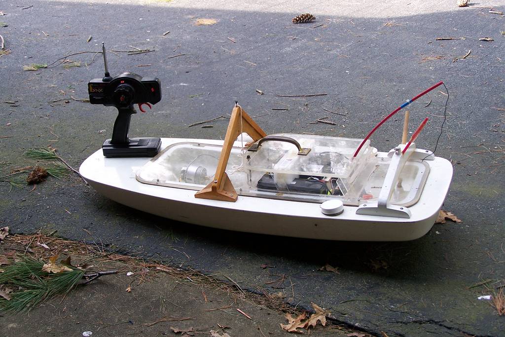

while hunting color schemes, I ran across this which looks to be a Japanese YouTube type site
http://www.themessagemovie.com/%E4%B...0%B4%E6%88%A6/
Seams I'm not the first nut to try this (not like it thought I was)
After seeing this one I think I'll get my RC boat ready too

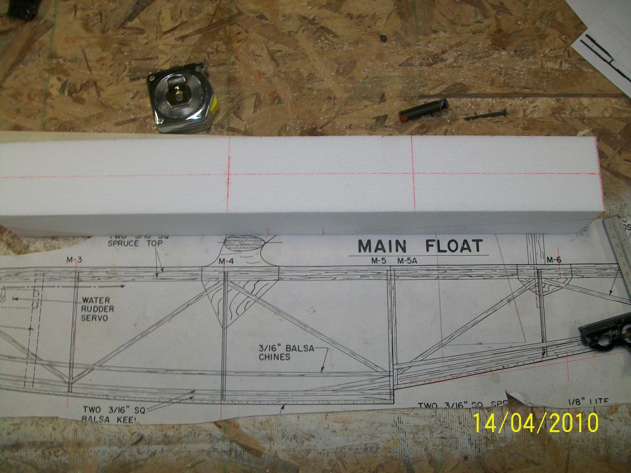

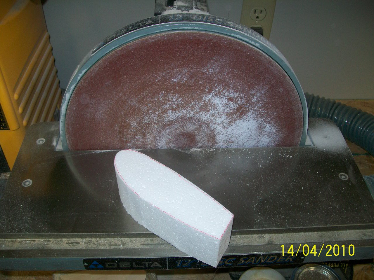

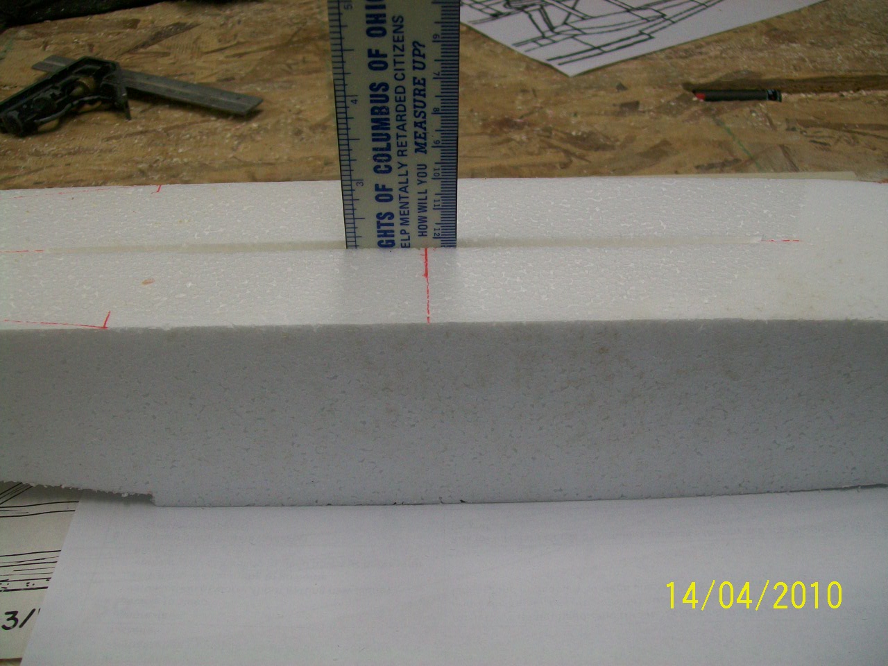

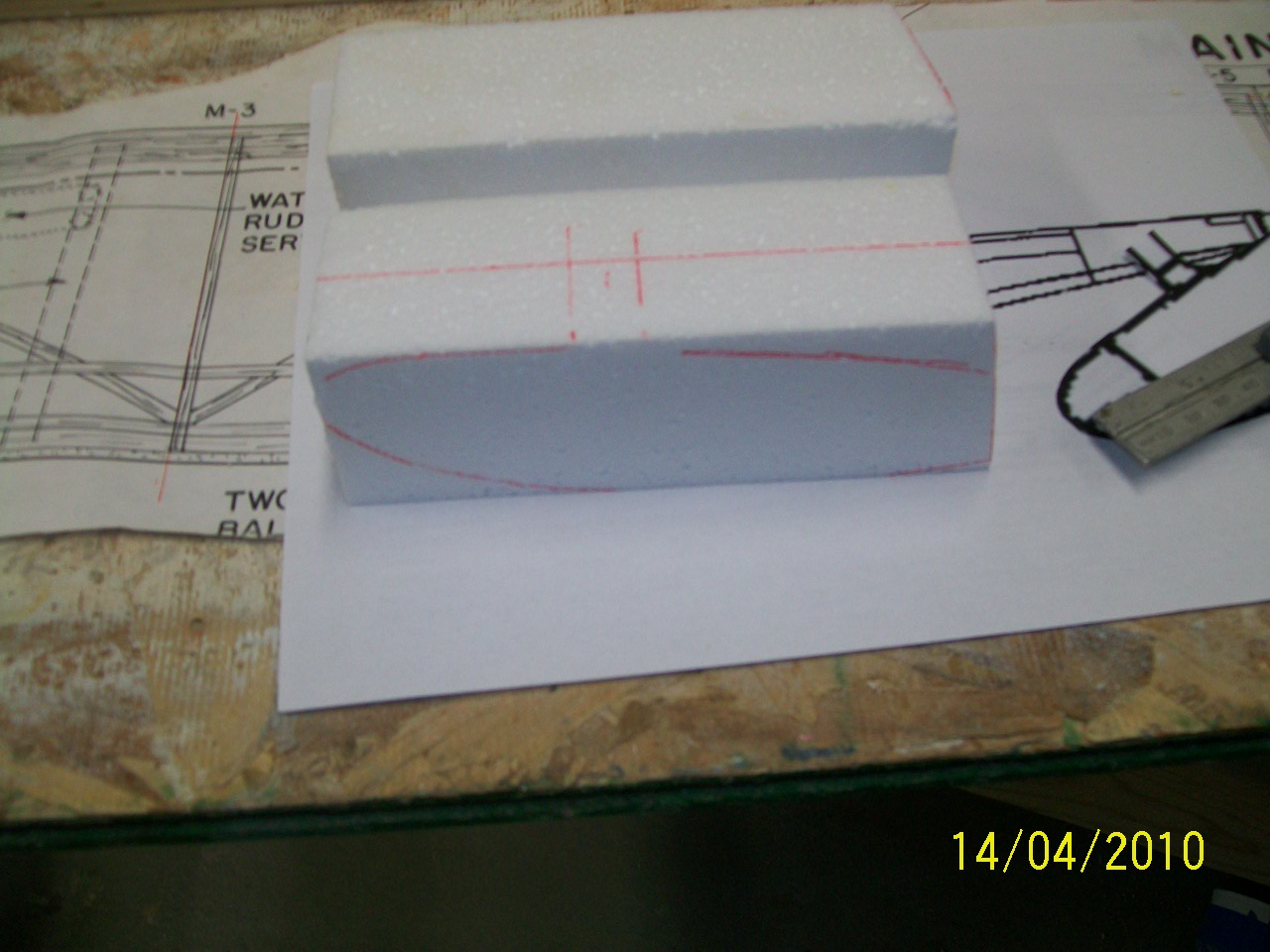

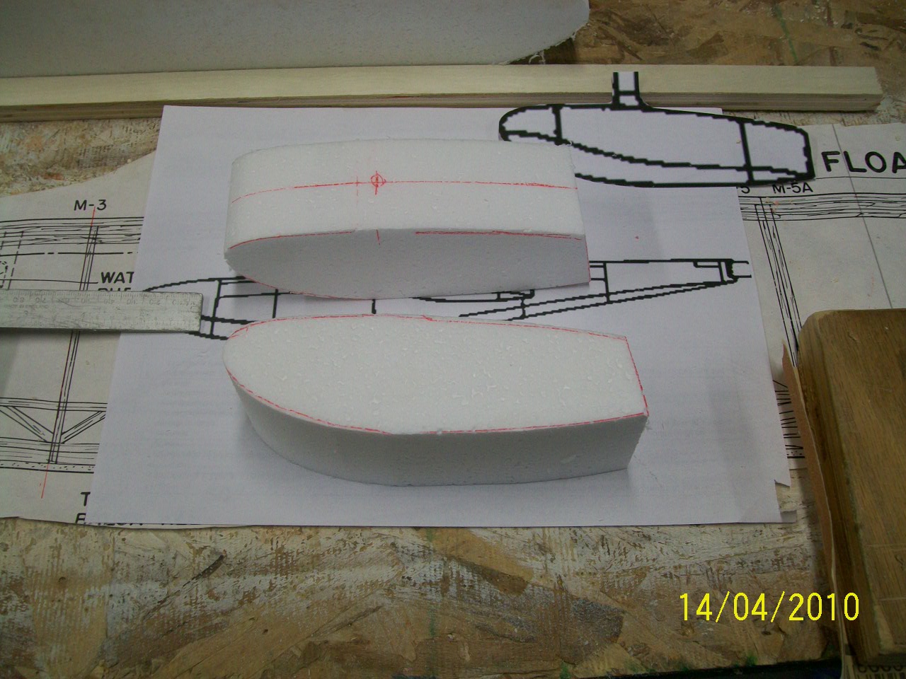

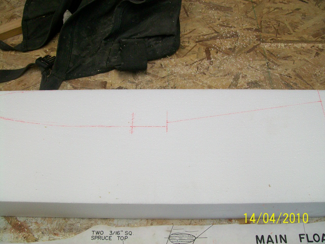

Worked on the float,
Based on my math, the main float is 22.5" long,, about 3"x3" at the thickest point before shaping. The plans I worked from are RCM Rufe conversion for the Top Flight Zero, those are 41" long, so I had to subtract 45% from every measurement. I first I transferred the profile (side view) measurements and shape onto the block,cut the foam 3x3x22.5 on my table saw,, then, cut the after-body with my bandsaw and rough shaped the nose with my disk sander. I then plunge cut a 1/8" wide slot about 2" deep with the table saw. The main float attach piece, 1/8 light ply, will get glued into that slot. Then I will add foam and shape.

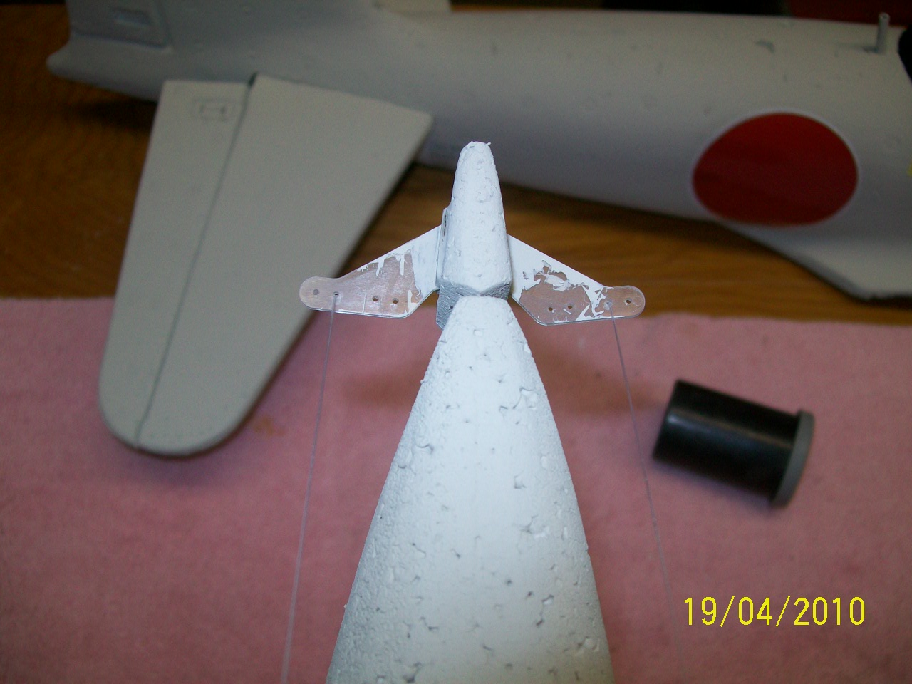

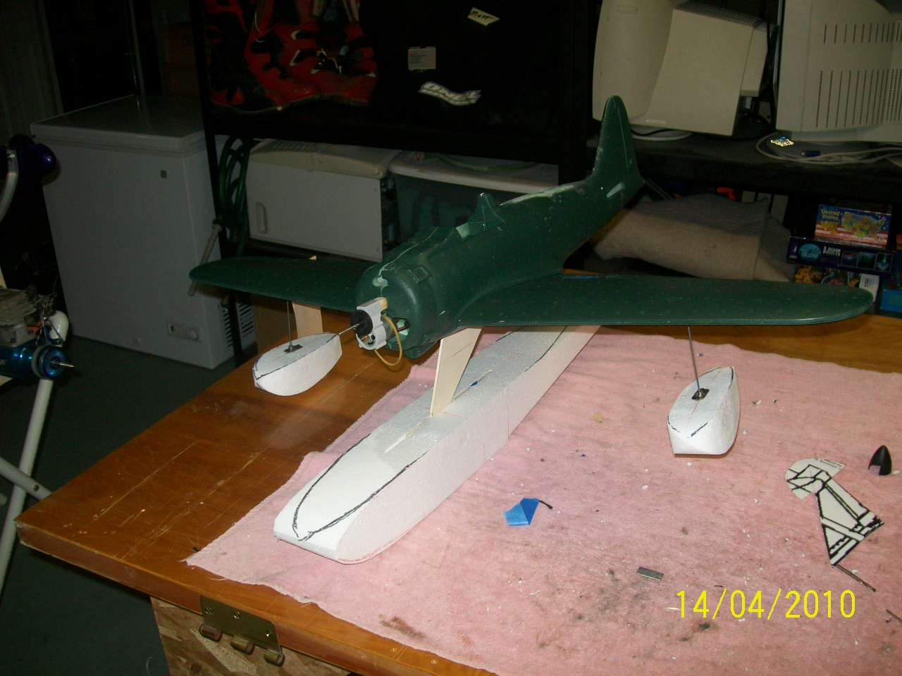

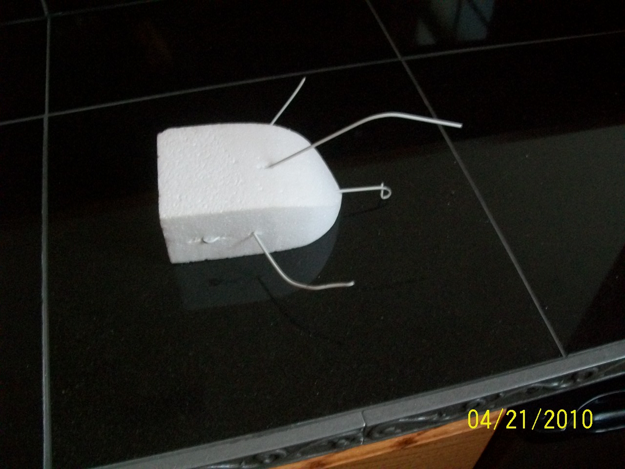

Next the tip floats
I cut 2x2x6" blocks and was able to blow up a 3-view picture to get the shape, I rough shaped with the disk sander as well.
Now on to attaching to the wire?
I decide to solder a wheel collar to a piece of flat brass and then that go screwed to plastic tube (the inner pieces of Nyrod),, I've used this method to attach to foam before and when you epoxy those in it's very strong. The hard part is tapping the nyrod to accept the wood screw, I find warming the screw with a cigarette lighter helps a lot (no I don't smoke,, but have one in my field box)
I may need to re bend some new wire pieces as the stock landing gear wire may be too short (one broke at the bend when I tried to straighten the 90 deg. bend) Also I still need to clean up the brass mount prior to painting. I'm not going crazy with the fit and finish on this, so forgive the sloppiness.
I'm using the wheel collars, so I can adjust the tip float height, once I fine tune that I'll wrap the wire with balsa or maybe a flat straw???
A quick mock up to get the idea of what it will look like
later

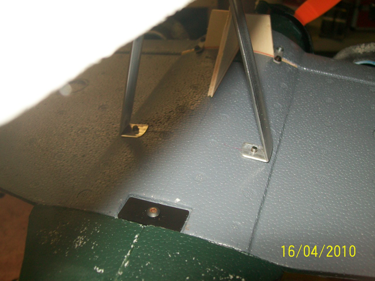

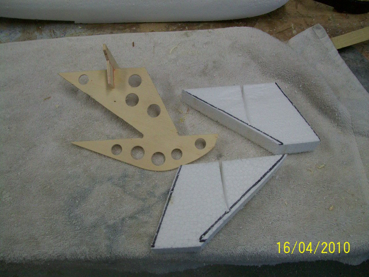

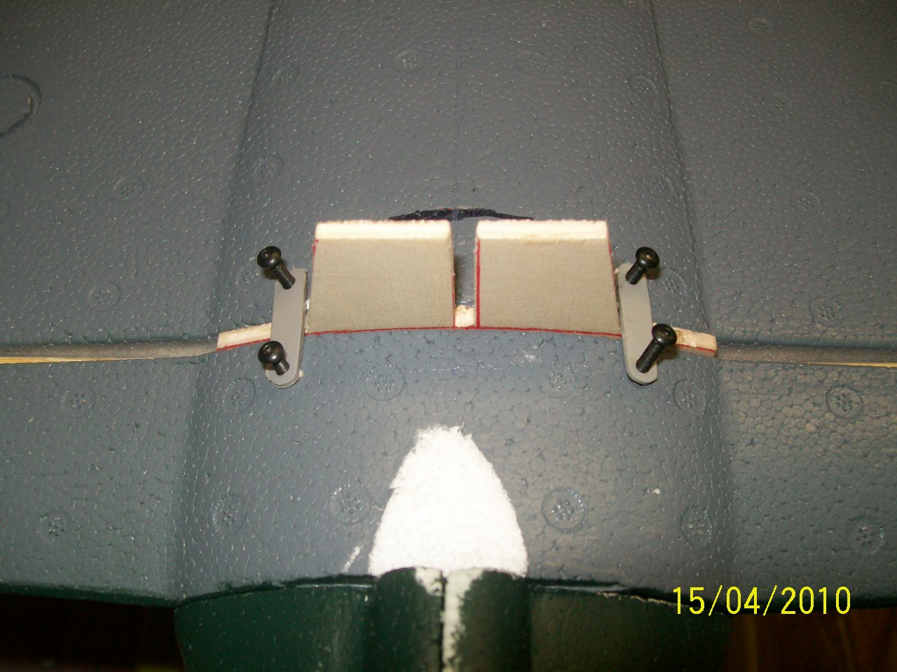

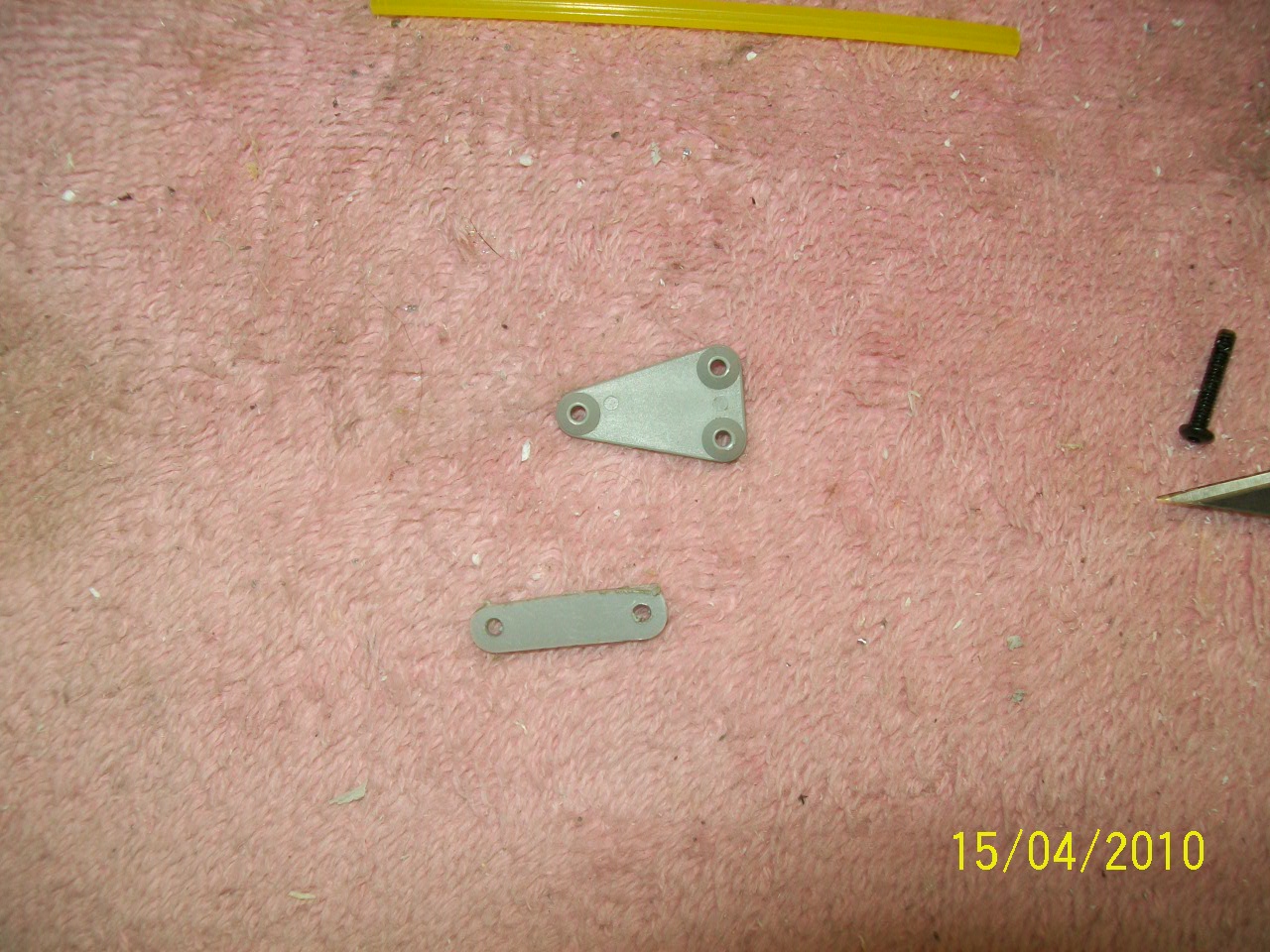

I did find a little time to shape the tip floats and work on the front main attach point.
The 12" disk sander I bought last year came in real hand on this project,, I couldn't imagine shaping these all by hand
The zero uses a bamboo dowel that acts as a spar so the wing is slotted for it, I made a lite-ply piece that will fit in the slot and cross join the main float brace. I then made a couple straps out of left over control horn backing pieces, used the nyrod in the foam method again,, the epoxy is gluing as I type.
Tomorrow I'll work on the rear braces and do some finial shaping of the main float and front brace

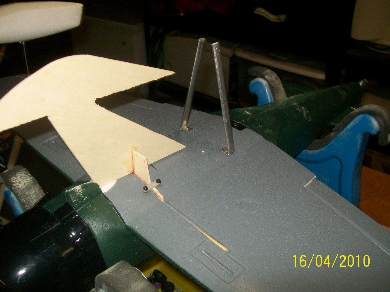

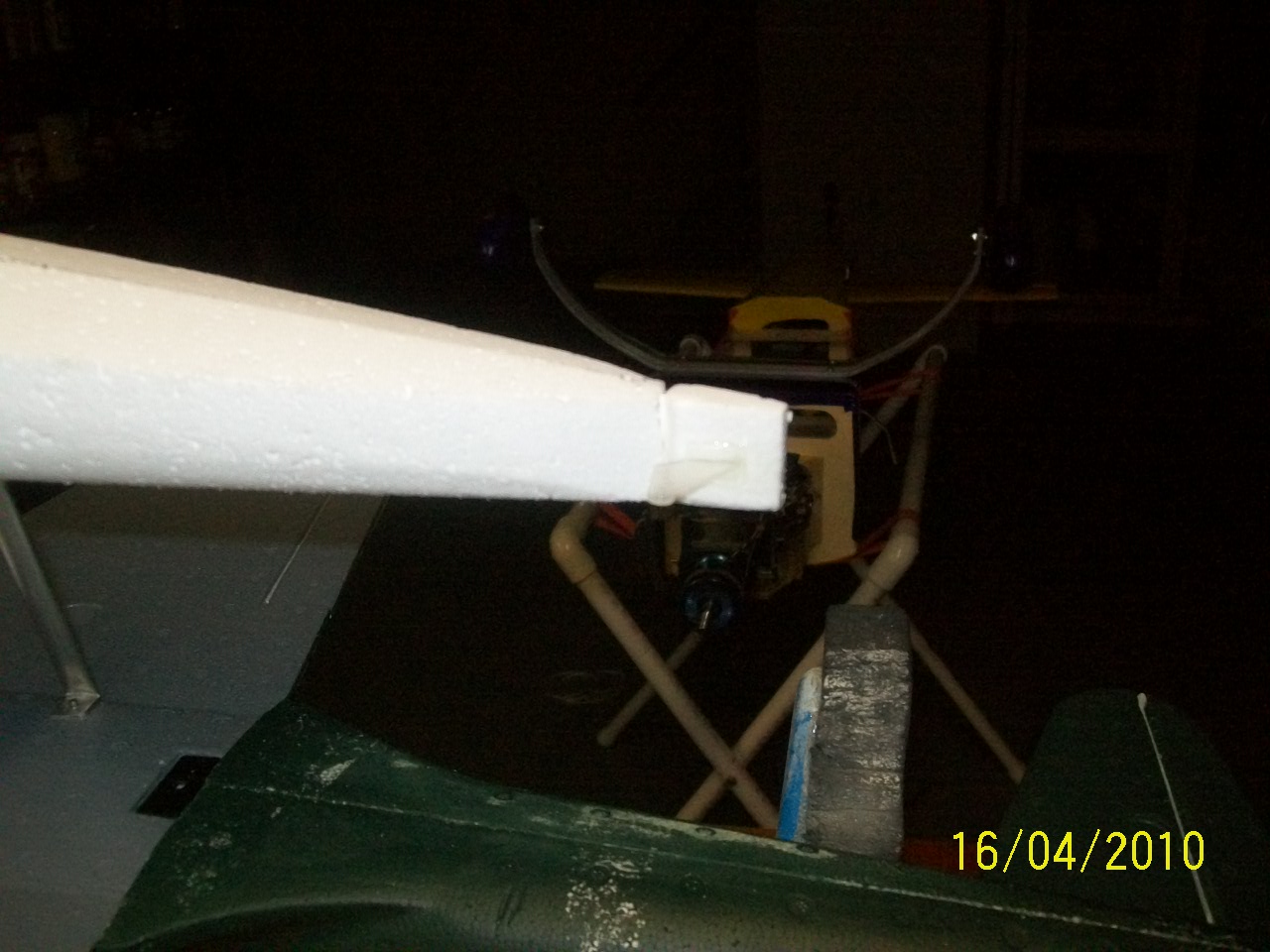

Old 04-16-2010 | 10:30 AM
scale only 4 me's Avatar
My Feedback: (158)
Posts: 10,420
Received 54 Likes on 52 Posts
From: Avon Lake, OH
Default RE: A really small float plane build thread
You're all laughing at me huh,,, good

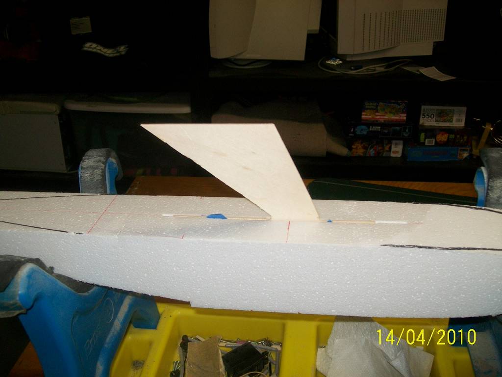

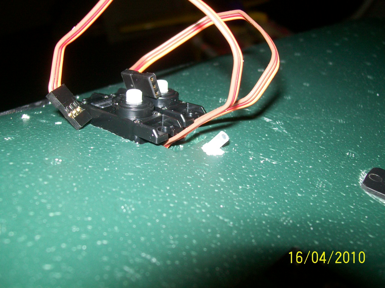

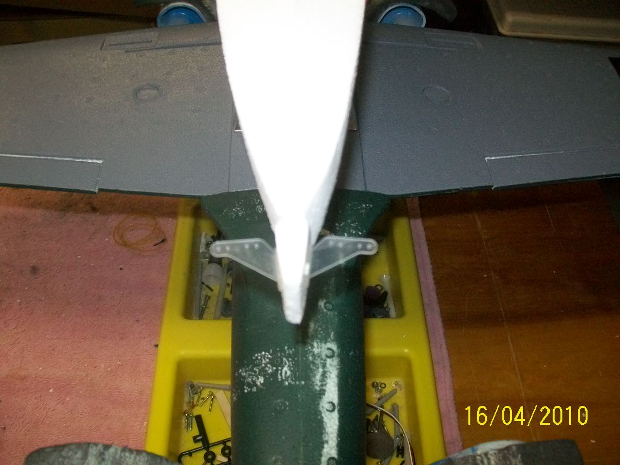

The rain gave me a little time this morning to start the rear main float braces. They are made with some 3/8" streamline tubing I picked up the other day. Bolts comes through the top of the wing,, I just tapped the aluminum to receive the bolt,, Simple is good. The hardest part was making the holes straight in the foam float without making the holes too big. They will just get epoxied in once the float is finish being shaped.
I'm liking the proportions so far

Worked on shaping the main float, drilled a few lightening hole and glued up the foam to add the shape to the front float support. It came out OK, but I have to keep reminding myself this isn't a scale contest winner, the foam is tough to sand to a real smooth finish.
I made a water rudder and ran a plastic tube through the front support, My idea was to run fishing line through the tube and connect to the aileron torque rods to control the water rudder.. I'm hoping the pull pull will work well, the fall back plan is to mount a servo in the float,
Everything is gluing up as I type,, I'll do more over the weekend, A few more hours of rigging and painting she will be ready for the water

Airframe is ready to fly, I haven't hooked up the water rudder yet, that is the last thing before it's ready to take off from the water
I was curious so I weighed the float (before painting) they only weigh 2.5 oz. That suprized me,, Figure another .5 oz. with paint only adding 3oz. is great
I'm going to take it to the pond and see how it sits in the water to see if I need to make longer wires for the tip floats. More than likely I'll madien it tomorrow without the floats to set the trims
I decided to go with the all INJ Grey scheme,, The paint I used just happens to be the paint I used for my garage, it's amazingly close to INJ Grey
Well the fishing line through the tube didn't work well at all,, too much friction , so I drilled through the wing and went straight from the servo horns to the water rudder horns, these seems to work just fine.
Basically I just tied a knot and ran the line through the water rudder control horns, the line runs straight as possible to the horns, where I have it going through the outside hole in the servo horns, then it wraps around the servo horn screw and that screw secures the adjustment. Simple but seems to hold and work well
I'm hitting the water/park later today,,, Maybe Hitting is a bad choice of words

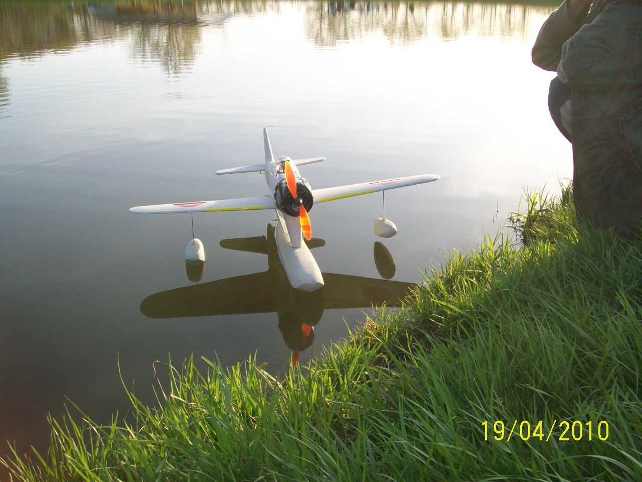

Thanks for the kind words,,
Well it looks good on the water,
I think the tip float heights will be OK, The bad news id the GWS receiver didn't range check at all, I can only get about 8-10' away With the antennae out??
I'm not sure what the problem is there
This kinda suck because the Ebay seller never got back to me when I emailed him about the damage durring shipping, I'll have to Email GWS directly and see if they can help
I'll switch to a Hitec receiver I have and try again,, maybe tomorrow

I did get me RC boat going and build a retrieval buoy thingy,,,
Of course I'll never need it because I'm just that good

Thought I'd post a picture of my friend's (who passed away) retrieval boat. He too made a buoy to snag his plane. A large 13 1/2' span PBM. The boat is powered by a geared prop drive with two 12 volt gel cell batteries. The hull is a custom (I believe) fiberglass hull. The prop and rudder are enclosed in a heavy screen weed guard. I haven't seen it run but I might end up running it to try it. It is one of the many items in my friend's collection that is for sale. I will start posting more items here on RCU soon.
