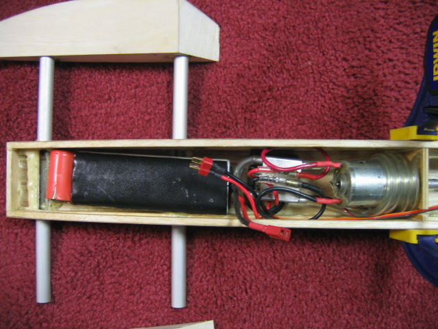

For my second project this summer, I will venture into this area of boating. I have built a few airboats and am now going to attmept to build an outrigger from the predator plans. I will be using balsa and plywood, and will probably end up making my own hardware. I am only 15, so I have a lot to learn, especially in this area of RC. I plan to power the boat with a plain-ol' 550 motor, then stick in my Mamba Max 5700kV once it comes from Tower Hobbies. I worked my butt off to get it and my bugdet will have to wait awile to be fully recovered. I hope to finish the build in a two week timeline... then again, I am usually pretty bad at following them, so we shall see about that. I will post some pictures every step of the build, and would like some input as to how I am doing.
Futaba 2pl radio / reciever
Futaba s3010 HT servo
7.2 v 3000mAh NIMH battery
550 motor (brushed)
Dynamite Tazer 15t ESC
plastic prop from some old boat
- hope this one isn't going to sink

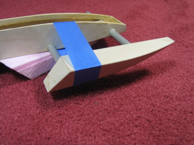

What do you mean by angles of attack and strut settings?
I figured that going light would help - the same applies to most things (cars - airboats - planes)
the frame is very light - 3/16 balsa skinned with 1/32 plywood. The transome is 1/4" plywood.

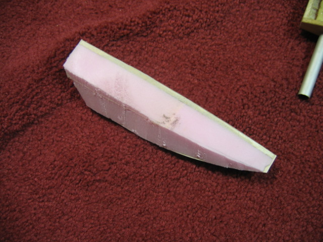

Should I really make the sponson insudes out of foam (the pink stuff?) if so, should I use it anywhere else in the boat?
Thank you for your informative answers!
Join Date: Sep 2003
Location: Vilnius, EuropeVilniaus, LITHUANIA
Posts: 140
RE: Predator Outrigger Project
You don't relly get the weight I was talking about..
regarding angles he means that sponsor angle to a water is quite critical to these boats - it must be a certain angle and not less or more or it will perform not at its best. The strut angle can regulate how mutch vertical forse you want to get, the ideal is when strut angle is about 0 degrees with water, than most of trust is where you want it to be.. best way to arrange best strut angle is to test it in the lake..

The angles I refered to are the sponson planing surface to water angle. With the boat set at its running attitude the sponson bottom should be at about 4-5 degrees up.
The strut settings do a lot. I will dig out some interesting articles for you soon. In summary is this: Changes in strut depth will alter the AoA of the sponson and therefore the behaviour of the front of the boat. Changes in the strut angle will raise or lower the stern and determine the behaviour of the rear of the boat.
Depth = front
Angle = back.
To demonstrate this I played a lot. With the strut too deep the front ran very wet and therefore could not get best speed.
This shows up even more with a vintage style shovel nose hydro. If the strut is too shallow the front gets too much air and lifts too high.....blowover time.
With the tail shaft angled down the back hopped all over the place losing thust, this is where Fiend refered to 0 deg being optimum. Mine is 0 deg on the hydro and the rigger.
Depth = front
Angle = back.

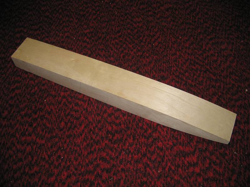

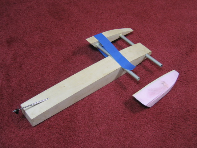

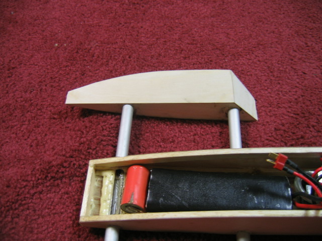

here are some pics of progress - got back from work today late so couldn't get much done. hull weighs 80g so far without electronics - they are just a mockup in the picture, not the real ones that I am using.
I am currently wondering whether to do a straight shaft or make my own hardware (flex shaft). I will use the straght as a backup if (or when) my setup fails, assuming its not in the middle of a lake

I'm not going for any speed records so I guess honda will fit the boat well!
here are the pics:
