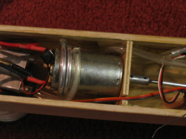

It looks like you are using plastic tubing to cool the motor-does that work well? I don't bother cooling mine but I only run 6 cells.Nice job so far-the compartments are cramped on the Predator especially once the deck is on.I built a little platform over the stuffing tube to mount the receiver.[8D]

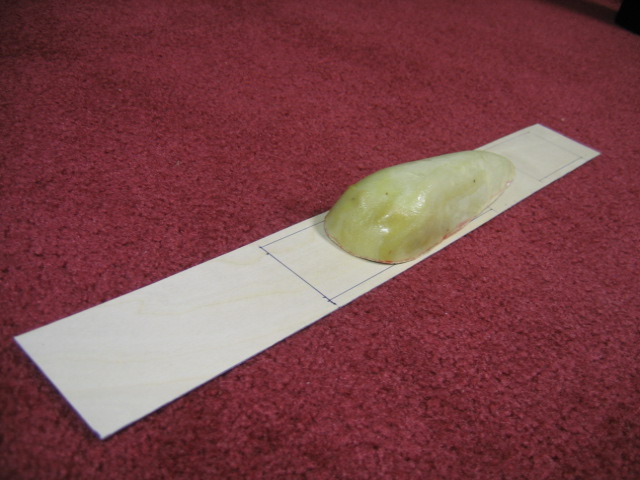

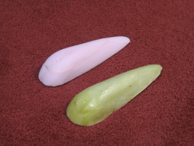

well, the only way to know is to find out! BTW, its clear PVC flexible stuff (from an aquarium cleaner), and it lets a lot of water through it. as far as cooling is concerned, I will probably also end up running 6 cells and the motor's previous boat didn't have any cooling for it (it has an internal fan though)
about that ford bashing... with the price of fuel these days, I think I might as well stick to Honda
back on topic... I experimented with some fiberglassing today (first time), but since I only had epoxy, I used an old undershirt for the material. I think it turned out fine, I might add some pink insulation foam to it for a bit more stiffness - OH, forgot to mention, this is going to be the canopy...
I also attached the other sponson and put in all of the electronics, now all I have to do is make a rudder and linkage, primer and paint, then test it on the water!

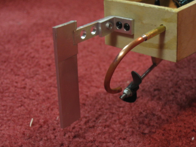

Hmm... I haven't really been worrying about weight with this project, but I did do a weigh in out of curiosity...
so far with everything except the rudder and steering linkage, the boat ways in at 1pound, 15ounces (about 870g)
The ballance is right behind the sponsons, and the boat feels and looks very nice now that both sponsons are on and aligned. Then only thing that I am a bit worried about is the floatation of the hull. I can't realy envision how its small displacement will keep some 2 pounds afloat. Am I just overreacting or does it realy have any flotation issues? for those that have built the boat, where would be the normal waterline for it?
Now I am making a rudder - I just want to know what dimensions work well (I am also running a standard servo, will it be enough torque? its futaba S3003)

Water line on the hull has no effect to performance. When on plane the water line will always be similar. A boat that sits deeper in the water does not mean it will be slower.
Rudder - Around 2-1/2-3" x 1" will work well.
40 oz in or greater will be more than enough. A standard servo is a bit large but will work.

ORIGINAL: sportygreg
I do not think the plastic tubing will conduct the heat between the water in the pipe and the motor (I use the aquarium tubing also for my plumbing to my motor coolers)
Try using aluminum pipe around the motor it will work better

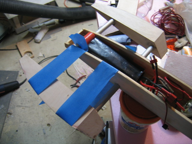

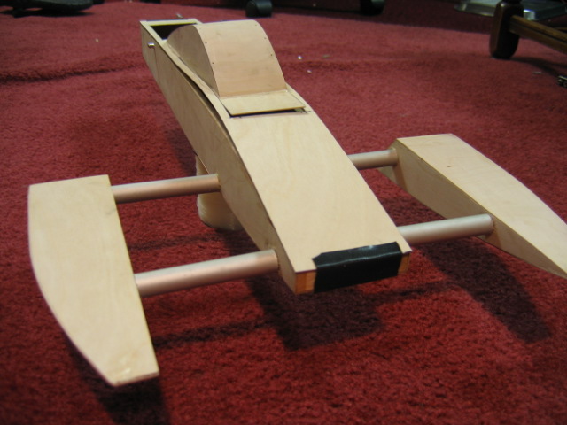

Well, Ive found some time to work on the boat, reconfigured the cooling system a bit, had some fun bending tubing (I actually learned a lot!)
I stabilized the stuffing tube a bit, mostly for looks. Decided to ditch the glass-shirt cowl, went with a plain ply and balsa one instead. The rudder was by far the hardest to make, it is fairly close to a true wedge, that took a lot of elbow greese (a plain ol file is all I have to shape metal)
next I need to make a stand for the boat and glue the top deck on. then its preping and painting. I have decided to say goodbye to the honda stickers and will use leftovers from my T4. Team Associated should realy start making boats!
but before all of that, I have to connect the rudder linkage.
