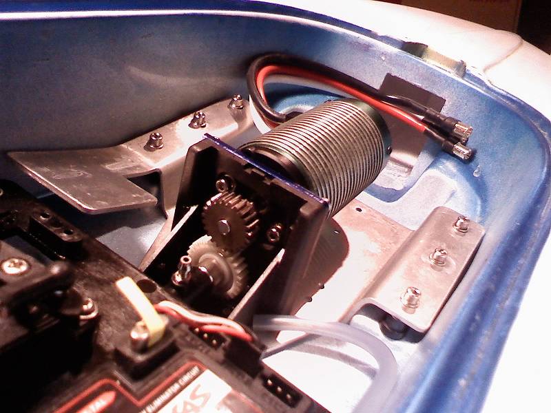

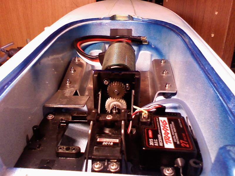

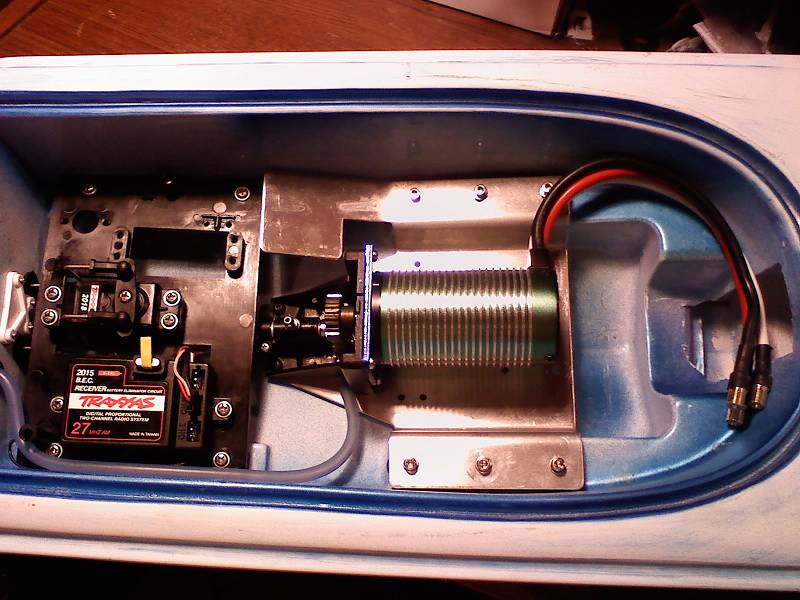

well i got alot done this weekend, havnt started testing yet but here are some update pics. i will get paint worked out after shes a runner.
#32
Wow, samich..............................what is that 24pinion and 32 spur............i've always wanted to stick my monster system in a boat (its in my 3905 now) But OMG.............................i think the min voltage for the monster sytem is 14.4v, you might want to check it..................you may need to go 4s, but gear down, have some mercy, BTW i am predicting that you will shred, destroy, liquify your u-drive on the first run, but i hope not. Keep us posted, i would love to see a vid.
P.S. - castle states that the monster 2200kv on 6s is equivalent to about 6 h.p. !!!!!!

Castle is a little of on their statements
#34
They could be overstating it some, but i'll tell you, they are EXTREMELY powerful, i run my e-maxx on 6s with the 2200 and i've broken lots of stuff on it, its mostly aluminum now, with steel shafts, but i cant think of another motor with more power for $150 bucks.

its funny you say that, i took mine out of my 3905 for this project. my intent was to see how things go and determine if i should buy another mamba monster system or go with a 1/10th scale castle system. maybe around 4400kv on 2s. on a side note i try not to show any mercy to any of my rc's. as for the 6 hp on 6s i believe it. my emaxx will do backflips spinning big joe 40 series tires on 4s. on 6s it just starts breaking things. and its a 23/28 gear combo your looking at in the boat. i may go to a 18/28 depending on what happens during the first few test runs. as far as liquefying parts goes i have the castle link on my side. im going to program the esc's traction control feature so its not such a brutal hard start.
honestly though the trx .15 marine is rated at something like .49hp. even if my mamba only made 1.5 or 2hp the performance of the boat would double if not triple. i was bored so i decided to mix it up alittle. after all thats what this hobby is all about.
i should start testing this weekend, i will try to post a video if i can. i still haven't decided on a prop yet. i think im just going to buy a dozen different plastic ones and see how far i get. after i find a good one i will switch over to metal.

you should get 50+ mph
I would'nt worry much about gearing just prop
start with a small prop and work your way up checking temps every minute or so, and slow on the throttle

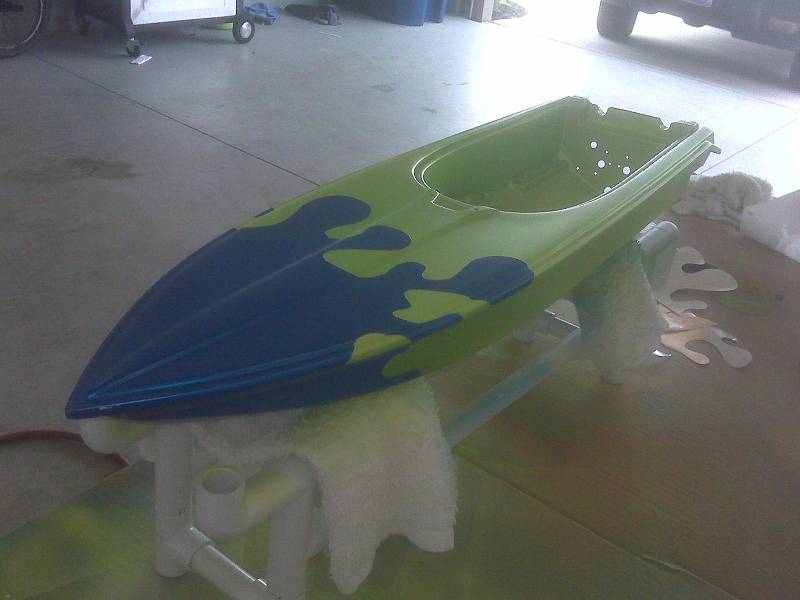

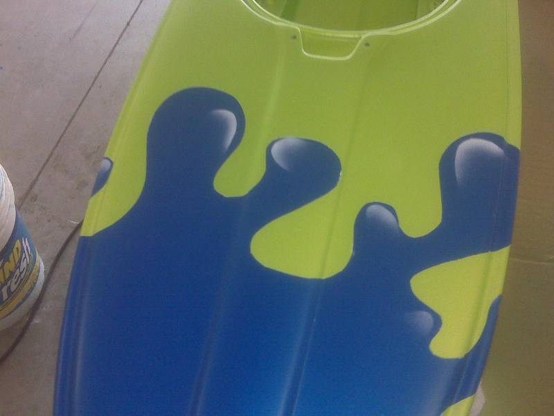

honestly im still trying to figure out the whole prop situation. but the 447 and stock villain prop are supposed to be close to the same and the stock villain prop is what im using as a starting point. so if all works out i may be using a 447 or 450
heres a little teaser on the paint job, this is the hatch covered in 6 layers of autoair lime pearl covered by 6 more layers of lacquer clear coat. its not the greatest pic because i took it with my cell phone but there will be more to come after its all put together.

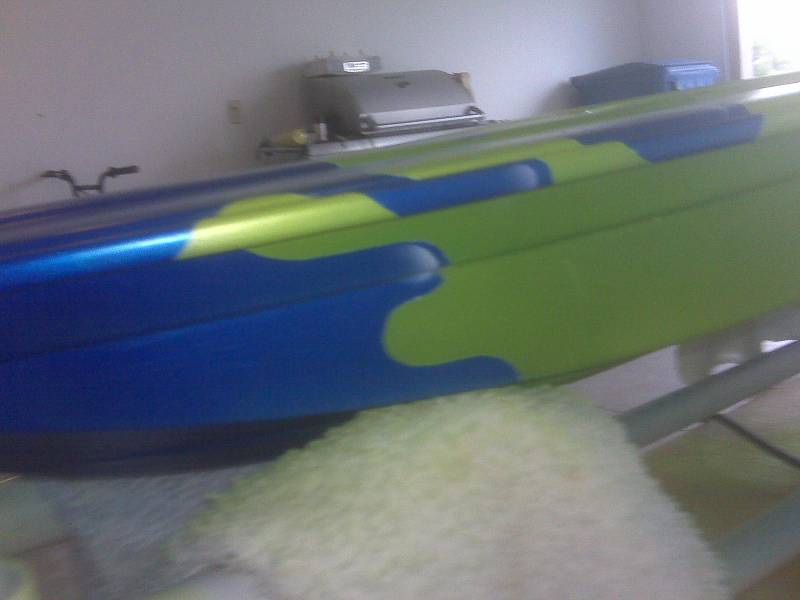

well here's a little update, paint is on and tonight after work im going to shoot the clear coat. if the clear goes on and is set up in time i should be on the pond as planned Saturday. what do you guys think of it?
#49
Thats Awesome..............................i'm jealous of your beautiful hotrod.....................i'm eagerly awaiting your 1st run results!!!!
