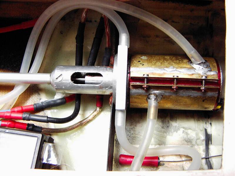

Hi Christo,
Outrunners don't have much aircooling in a narrow hull like a rigger, though the build in fan will help.
If you have the time and resources, make a watercooled motormount, so you can at least cool away the heat from the stator.
The picture shows a commercial version, but you can make your own out of aluminum strip and drill a hole to fit an aluminum tube, where the water runs through,
Let me know if I should provide a pic of that.
Regards, Jan.

Hi Christo,
Unlike some forum members, I actually read the opening post and look at the pictures, so I know what I'm talking about when I reply...
The motor in the picture I posted is an outrunner, but without the cooling fan your T-Rex motor has.
The chrome plated ring between the motormount and the motor is tha part that's being watercooled.
I know of (very)large outrunners that have watercooling channels in the stator, but this motor is too small for such cooling.
If by short runs you mean under a minute (or two) you should be able to get away with it, provided the ambient temperature isn't already high...
I know myself; if the boat runs well and fast, I don't want to stop and before I know it I'll have to retreive a smoking boat...
Personally I wouldn't risk running without at least watercooling the ESC and motormount, but, it's your boat.
Regards, Jan.

Hi Christo,
I added two pictures of a custom made mount in my son's Monohull.
It's made out of 6 mm aluminum strip, with a Ø 3,3 mm hole drilled through the top.
These holes were widened, 10 mm deep, to Ø 4 mm and I glued in two pieces of 4 mm aluminum tubing with Locktite.
The KB 36-60-09L 2700KV motor, used in this set-up, tends to run rather hot, so every little bit helps.
The water through the mount comes directly from the ESC, and it cools down the front of the motor considerably.
I have the same set-up in my boat, and my motor, with just the cooling jacket, is hotter after a run, so I'm preparing the same for that one.
Regards, Jan.
