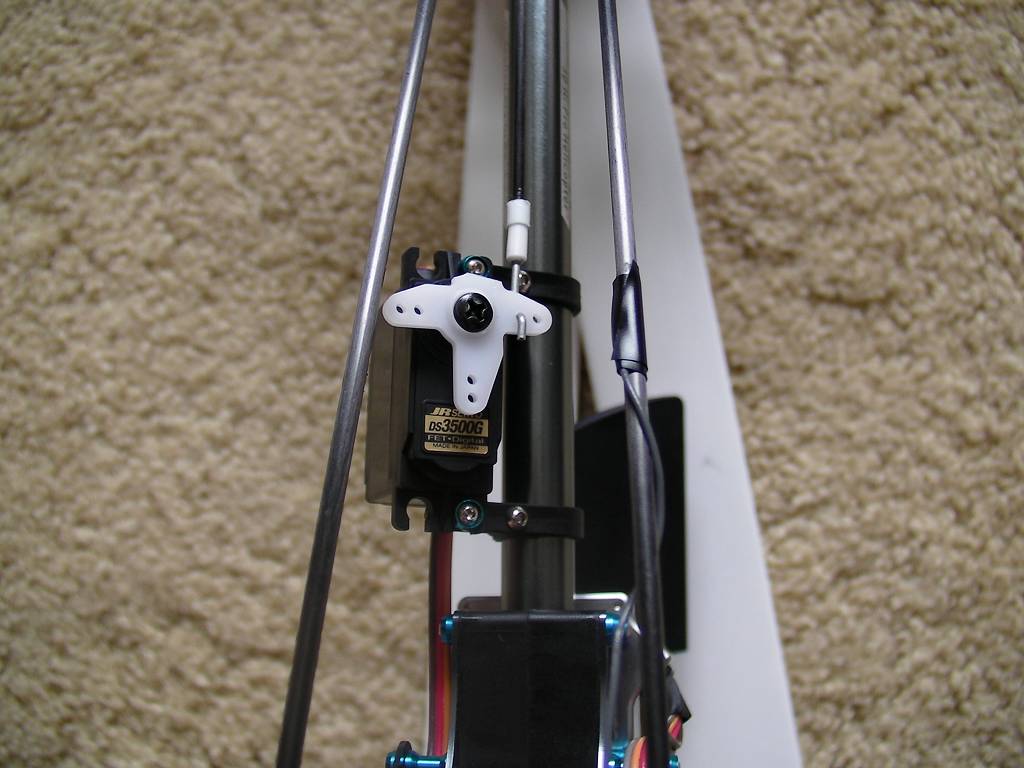

It turns out that I think the belt was too loose and was slipping causing a momentary lose of power to the tail. I tightened it up and it works better.
The gyro I have is supposed to be really nice but I can't seem to get it to perform really well. I have the gain set to 62%, 51% being the beginning of HH mode. The tail is a little loose but it still occasionally will start to wag a little. If I turn the gain up it holds much better but when it starts to wag it's worse.
I have a DS3500G servo on there so that should not be the problem.
I did have to use the hole closest to the center on the servo horn and turn the travel limiter on the gyro all the way down to keep it from binding.
Any ideas?

tail wagging is caused by too much gain. I'd turn the gain down a few clicks and try re-adjusting the tail rod link for better centering. That's what I had to do to get my Pro tunned in. Pain in the ***** but it's solid now.

I know wagging is caused by too much gain, my problem is that if I lower it to where it stops wagging then the tail does not hold very well. If I quickly increase the throttle I can get the tail to swing like 45 degrees.
I have the servo set up so when it is perpendicular to the tail boom the slider is in the center.

Even with the slider centered, is the tail push rod at 90? You might have a slight off centered slider to get the push rod link at 90. That should solve the problem. I know on my 450 with the slider centered it had a good drift. Once I set the push rod link to 90 everything was locked in.

The rod that goes from tail servo to the tail push rod. Is that 90 with the slider centered? This piece on your tail assembly.

I attached some pictures of my setup. Doesn't the push rod have to be 90 because the tail push rod angle is not adjustable. It's just one molded piece.
EDIT: One other thing. With your gyro where do you have the travel limit set and where does the push rod connect to your servo? It seems like I should move it out one hole but then it binds and the travel limiter won't go that low.

I'm running the Align 750 gyro. When programming that I can set the travel. What gyro are you using? My tail set-up looks just like your in the sense that everything is centered and 90. On my Pro the tail servo is housed inside the rear of the heli. I didnt do the boom mount like others and just left it the way it came. The 750 gyro doens't have a "limit" pot rahter a set button you push then you move your rudder stick left and right for how much you want it to travel.

I have the 450SA so the tail servo has to be mounted on the boom.
The gyro I have is a G500T from JR. Having a limit pot seems really stupid to me as it causes problems like this. I think the problem is that this gyro may be intended for larger helis where the limit pot is enough.
I went flying for about an hour today and they gyro works pretty well just not as well as some people say they can get theirs to work. It some cases during flight it will drift a little to one side and others it will wag a little. It holds in FFF but not that well in quick throttle changes. If this gyro is not intended for this size heli it is strange that it would be pictured in the TREX manual.
