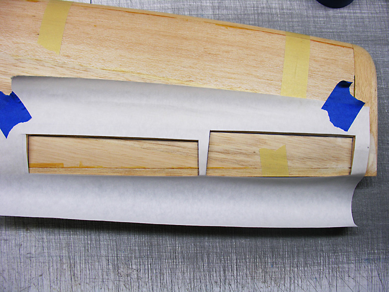

Lay out and join your 1/16" sheeting, four pieces. Mark each one.
Take the four sheets and the two foam cores to your local Formica cabinet or counter top place.
They have absolutely the best contact cement on the planet. They spray it!
Walk in, ask for who is in charge. Explain what you need. In fact, no explanation is necessary, they do hundreds of laminating.
They will spray and sheet those puppies for you, and I'll bet you won't even be charged.
Laugh? Sure, all you want, but I've actually done this.
These cores were sheeted over 15 years ago. Pulled them out of the box, I had them in storage. Started working on them agan.
