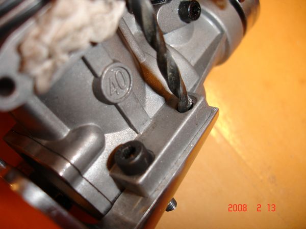

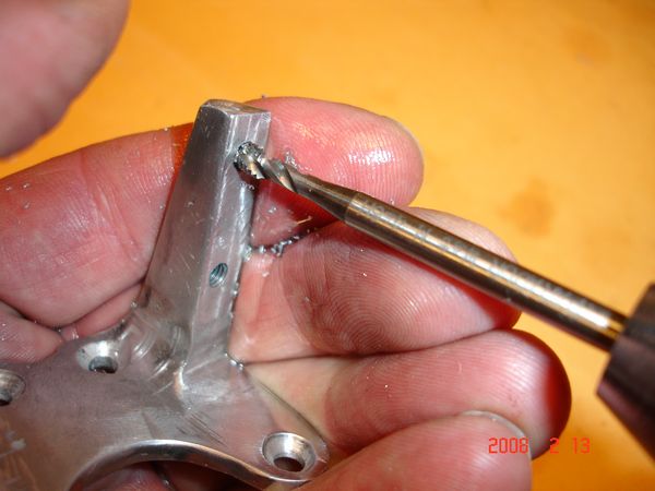

Hi!
All you have to do is to glue the engine to the mount using Ca medium glue and use a long drill and tap one of the holes! Then remove the engine ,which is easily done, and screw the engine firmly to the mount .
Then...drill the other three holes (the engine still atached to the mount) and tap the holes.
3,5mm -4mm diameter screws are adequat to use for a .72 Engine.

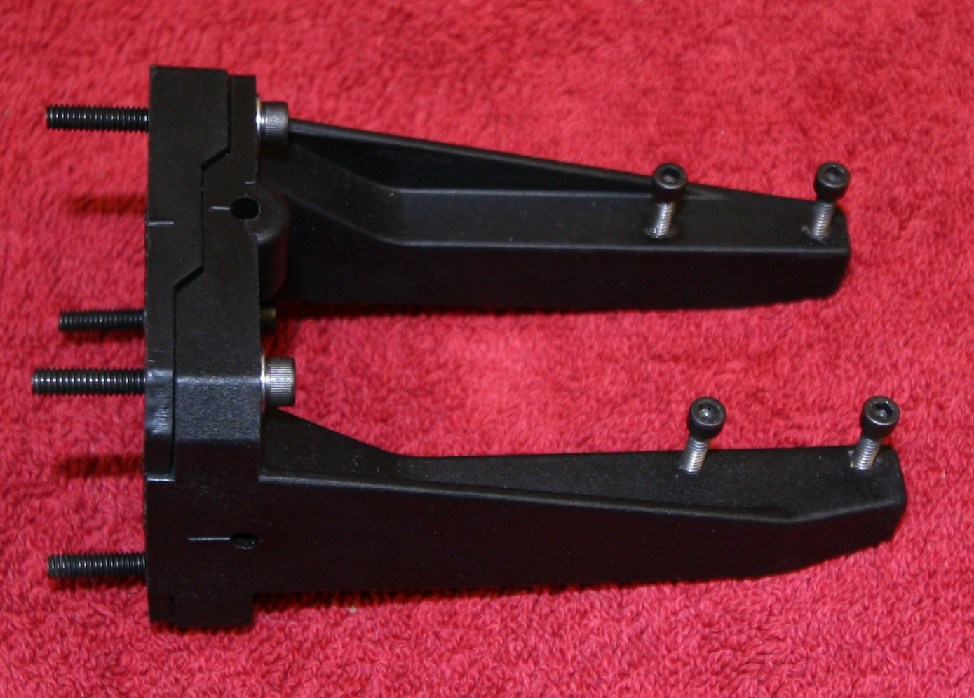

Originally Posted by tailskid
And remember if the drill gets into the way of the engine, invert the engine and drill threw the bottom of the mount!
I have used this procedure before with really good results. I have included a photo of one example; however, you need to check to make sure that the clearances on the top of the mounting lug are the same as on the bottom. On many engines, the intake passage from the crankcase to the intake port of the cylinder will cause a small offset in the location of the mounting holes. It's hard to see in this photo, but the screws on one side of this mount are closer to the edge than on the other side.
It's probably not a problem for a four-stroke, but it is on many two-strokes.
