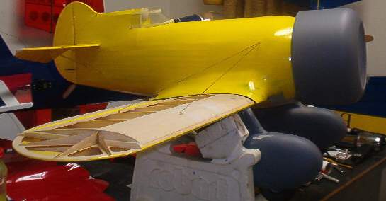

Forget what I said in the previous post because I looked at my big plane and I couldn't see them and there is only three layers of Plastic Paddings Clear coat. The reason for my post earlier was that when I airbrushed I could see them but I think that the clear coat fix that problem now, still need to try it but no problem.
Zpat
Nice color, did you glue the stab on before you started covering ?
And how about those fisheye hooks?
I need to order new servos before I do anything else, then total weight with only two servos and no covering was 835 gr, engine OS .46SX with original muffler 470 gr. So I hope that I stay withiÂ*n limits.

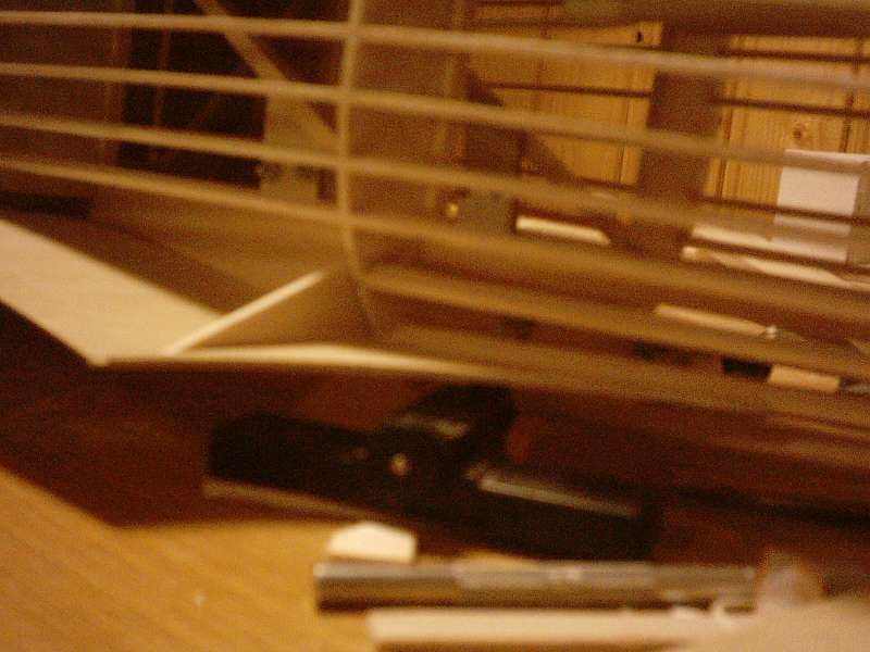

You have WF1-3 and WF1-2 are glued to fuselage and the question is around the WF3 that are like a wedge and you have WF4 that are a piece of liteply 1/8 thick.

Measure back 1 1/4" from the front edge of the fillet base.This is where WF1 gets glued. WF2 lines up with former F3 and WF3 gets lined up with former F4. WF1-3 get glued to the fillet base and the side of the fuse. They should force the fillet base to lay flat against the wing. The wing should be attached to the fuse when you are gluing them on. There is a lite ply wing fillet part that gets glued to the back edge of the fillet base. This piece gets glued to the back edge of the fillet base and the stringer that lines up off the back of it. After WF1-3 and the trailing wing fillet part is glued in place, you need to glue a 1/32" lite ply strip to the side of the fuse. It starts at the top of WF2, runs down to the top of WF3, and ends at the back edge of the trailing wing fillet part. You then need to sheet the wing fillet in 3 pieces. Start at the front and sheet between WF1 and WF2. The sheet gets glued to the fuse, follows the contour of the former, and finishes at the edge of the fillet base. The sheet should only be glued to the front half of WF2. The second sheet starts at the back half of WF2 and goes to the front half of WF3. It gets glued to the lite ply strip that runs between WF2 and WF3, runs down the contour of the formers, and finishes at the edge of the fillet base. The third sheet starts at the back half of WF3 and goes to the end of the trailing wing fillet part. It gets glued to the lite ply strip that runs between WF3 and the end of the trailing fillet part, runs down the contour of the former, and gets glued to the curved edge of the trailing fillet part. You need to wet the sheeting so that it doesn't crack when you form it to the contour of the formers.

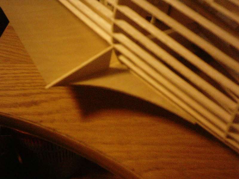

Okay, So WF3 has a shape of an triangle and get glued on former 4 and not against wingsadle and along with former 4 because if I place it inline with former 4 it extends to much.
See pictures

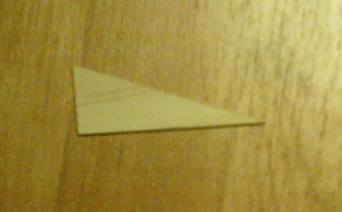

Here is a picture showing that WF1 if 15 mm behind former 2.

My precut WF3 former was contoured to match the shape of the fuse where it gets attached at former 4. The top side was also concave like WF1 and WF2. It was long enough on the base side to go all the way from the fuse to the end of the fillet base, just like WF1 and WF2.
Adrian's manual says to glue WF1, 1 1/4" (31.75mm), from the front of the fillet base. Is that about the same as 15 mm behind former 2?

Looking at your picture of WF3 laying on top of the fillet base, I didn't see what WF1 or WF2 looks like. Are they all triangle in shape? If so, then Adrian must have modified his plans to give the fillets a more scale like shape. My kit came with precut pieces for WF1-3. They were all shaped to fit flush with the fuse, flat on the bottom to lay against the fillet base, and concave on the top.

You have the fillet base already glued to the fuse wing saddle formers.
Old 01-11-2004 | 02:46 PM
  #123
Joined: Nov 2003
Posts: 88
From: Green Bay, WI
Default RE: Scale Gee Bee Z question.
I can see it in your second and third picture.

Okay, then I know that but problem is that WF1-2 are shaped after fuselage with no problem at all. Maybe not glued in a 90 degrees angle but in that area. 15 mm behind former 2 is a straight measurement and WF2 is in line with Former 2. Problem is that WF3 is a triangle and Okay I can modify it to have the shape of Former 4 with no problems. Al I want is to get this done, Rear wing fillet sheet 1.5 mm thick goes from WF4 and to WF2 in one piece.

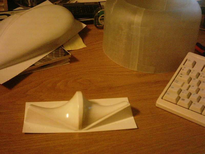

Today it finaly came. My plastic parts have manage to swim over the Atlantic.
One stupid question like always. I think it's the wingfillet but I'm not sure on how to cut it. There are some edges that I think is where I should put the knife in.
