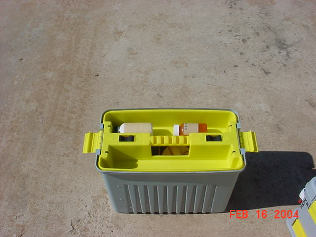

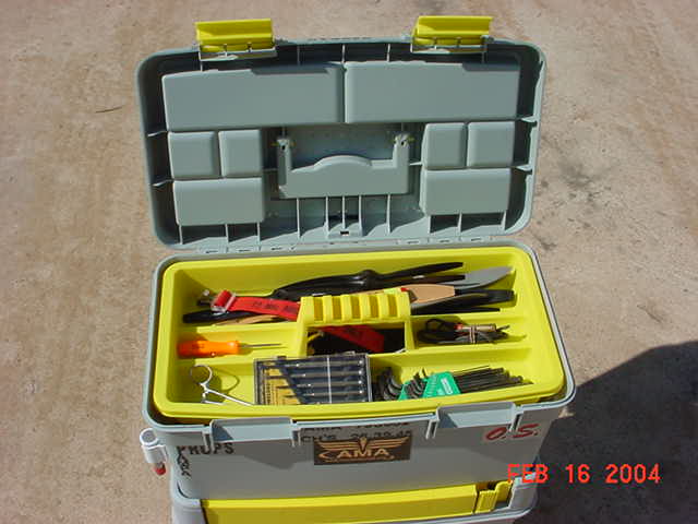

Plenty of storage areas.

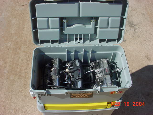

Room for 3 transmitters, the bottom tray locks in so you can carry the bottom when seperated. Plenty of room for fuel, battery and extras.

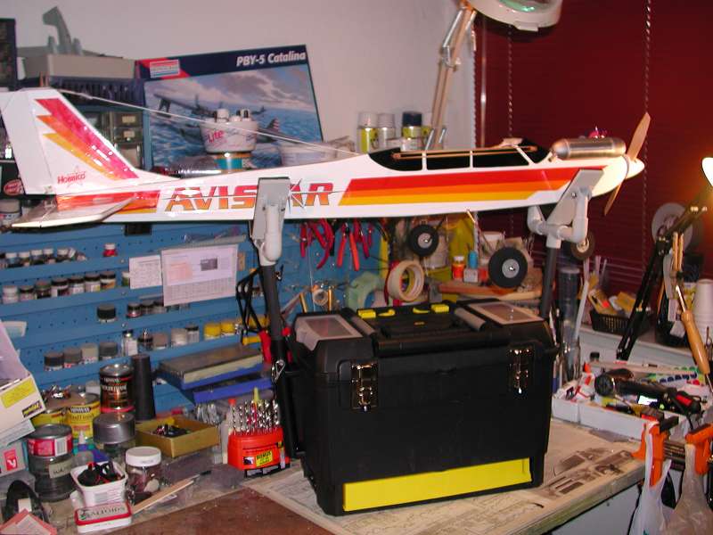

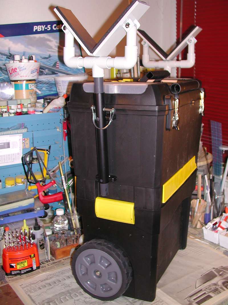

Finally finished my Stanley/Billy Hell inspired flight box by adding the cradle to the top box... Adjustable up and down in 2 inch increments - What would we do without PVC and pop rivets!
Just need to attach the fuel line and tank vent and it's done!! Now if the rain will stop, maybe I can get outside to try it out!!
Cheers!
Jim

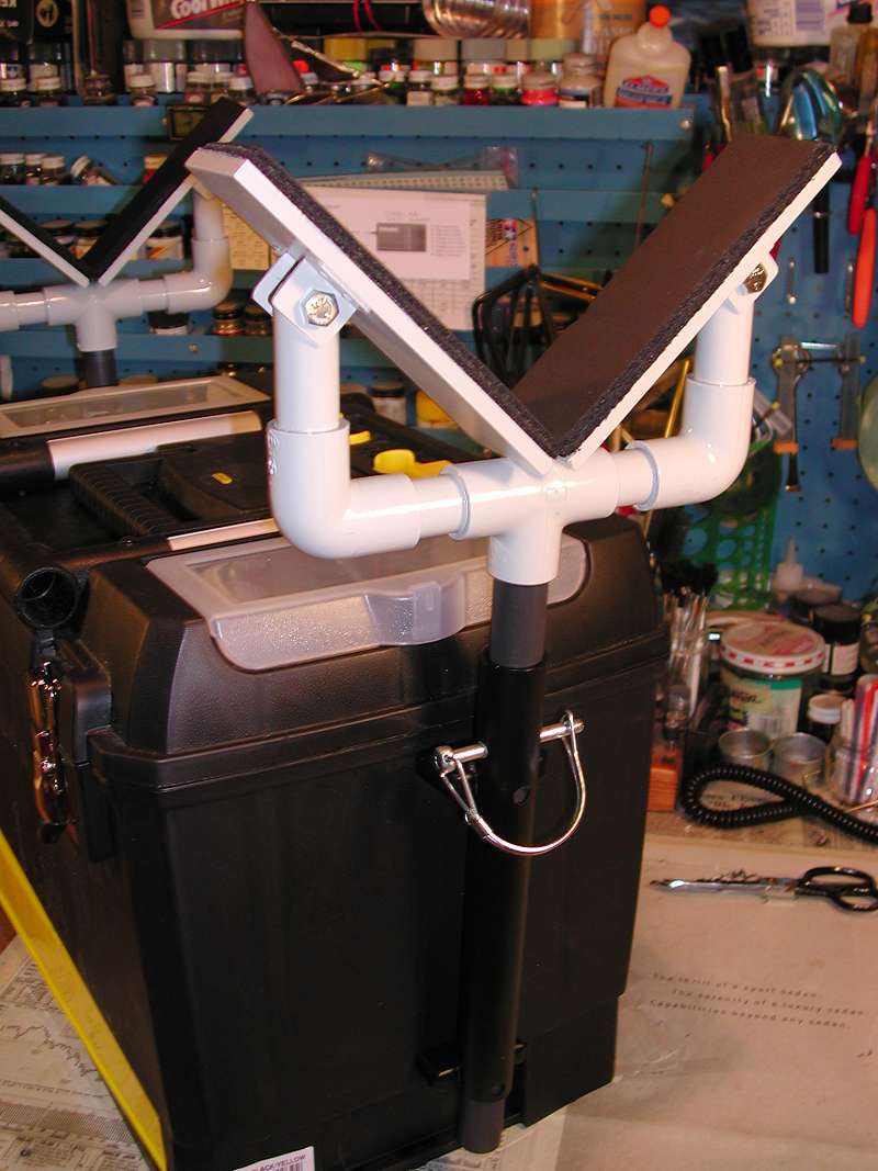

Johnny -
Thanks for the kind words....
Yokes
I used about 10 inches of 1/2 inch PVC tubing, two 90 degree elbows and one "T" for each cradle. Yoke was assembled with PVC cement, but the upright tube is press fit, in case I want to do something different...
Upright Tubes
Used 12 inches of dark grey 1/2 inch ID x 12" long Schedule 40 PVC sprinkler tubing for each upright (so I didn't have to paint it ).
Support Tubes
Used 1" OD x 9" PVC for the support tubes on the box that hold the uprights. Match drilled the upright tube and support tube to allow the cradle to be moved up in 2 inch increments, held in place with a 1/4 inch diameter spring clip.
Made the support tube attaching cradles out of 3/8 thick plywood, attached thru the box side with #6 flat head machine screws and nylon locking nuts on the inside of the box (holes on the side of the support tube are for access with a screwdriver).
Fuselage Supports
The padded fuselage supports are attached to yokes with 1/4 inch bolts and nylon locking nuts. Would use #8 or 10 phillips heads or pop rivets if I were gonna do it again - easier to tighten in the limited space than hex head bolts - just happened to have some 1/4 inch hardware laying around...
For the padded fuselage supports, I cut 1/4 inch hardboard into 2 x 6 inch pieces and cut 1/2 x 3/4 x 1/16 aluminum angle into 1 inch lengths (pop riveted in place), and attached two layers of 1/8 inch x 2" wide black neoprene self adhesive pipe insulation tape for the cushions -
Materials cost was about $11 - biggest single item was the neoprene tape - $6... If you have some foam around, could do the whole thing for about $5.00.
Exploded pics below -
#1 is a yoke assembly - 2 required
#2 is a fuselage support pad - 4 required
#3 is an upright tube - 2 required
#4 is a support tube assembly and attaching cradles - 2 assemblies required
HTH
Jim

I put my panel on the side of the box. The reason being that when I have my box stored my charger connections are out of the way and not likely to get broken, also when I get around to putting the plane cradles on everything will be on the same end as the engine. Well, at least I have a reason why I put it there now.

ORIGINAL: J Harper
To protect the fuel pump and mini power panel from trunk gremlins and size 12s, I cut down an electronics project box to act as a guard around them... see post # 384..

ORIGINAL: Jimmbbo
Smart. [sm=thumbup.gif]
As much as I love the design of the Cermark panel (still not sure if it's worth $70), a couple of things bug me.
The exposed and vulnerable glo charger.
The design of the banana jacks leaves exposed contacts that I can just see shorting against the side of my truck.
The fuel pump switch getting bumped "on".
These wouldn't be major issues on "conventional" flight boxes where the panel is angled upwards or contained inside of a larger box.

ORIGINAL: RichLockyer
ORIGINAL: Jimmbbo
Had the same concerns about the Hobbico mini panel... Am considering adding a hinged clear panel over the whole thing, but that may end up being overkill...
I'm sure you have thought of this, but if the pump is below the fuel level, priming will not be necessary...
