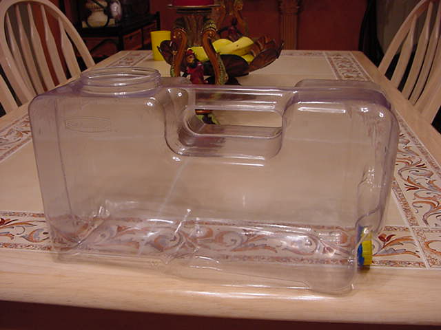

Mine did not have a spigot. Mine is just a 1 gallon "jar" with a big round lid at the top. I did use RTV Blue to seal the lid, but I only fill it to a couple of inches below that. That's plenty of fuel for three good days of flying. I didn't want to pack it in there, especially after I read about the probs you were having. Also, I'm not at all convinced it was the RTV that did it. Maybe you had some kind of residue in there from the manufacturing process. Maybe your fuel was tainted from the factory. Maybe you are right on the money and the plastic doesn't hold up well to nitro fuel. I just don't know so I'm not claiming to. All I can say for sure is mine "appears" to be the same kind of plastic made by the same company and I have not had any problems. I think I will try that test I was talking about if I have some RTV laying around. I'll post results when I get them. Later!

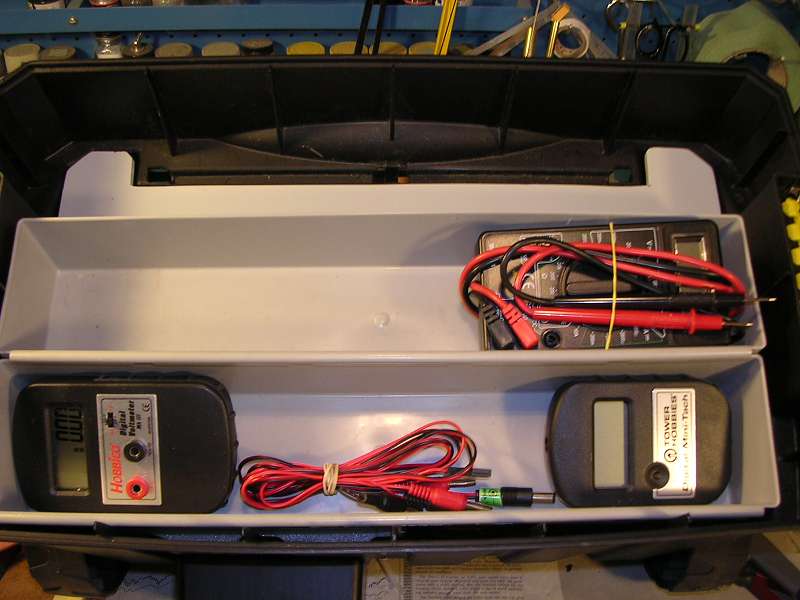

This is the "Wall Mart" box that I am working on........
Pic #1 is of the top lid. I have installed a Cermark Plus power panel with an analog volt meter for comparison....(Old Engineers like Analog meters...can anyone say Simpson...?) Should have cropped those toes out of the pic....hell I go barefoot and in shorts year round in the shop...ask me how I know Exacto knives always fall POINT first....!

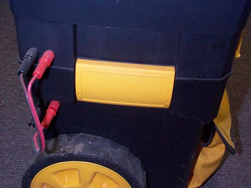

Pic #2 is of all three components separated...bottom has a 35 amp/hr battery (talk about overkill, but everyone wants to charge their stuff on it) and a one gallon fuel jug. The foam keeps everything in there tight...! The top holds two transmitters, and a ton of room for other stuff, and the tray which you can load up also. I had to put a small notch in the tray handle to miss some of the wiring, but it does not create any problems.
Pic #3 shows the underside of the lid and some of the wiring. The two wires that are not connected go to the fuel pump, and will be soldered to the banana plug tabs for the fuel pump connection. This allows me to keep gas in the internal tank and glow fuel with an external pump through the banana plugs. The switch controls both, and the gas is just recycled to the internal tank when I am pumping glow fuel.
Pic #4 shows the jumpers from the top to the bottom or base for the 12 volt power. There will be another set added for the pump leads. I am going to also add one more set for a Triton charger. The yellow bag on the front holds the starter, and a bunch of other stuff.

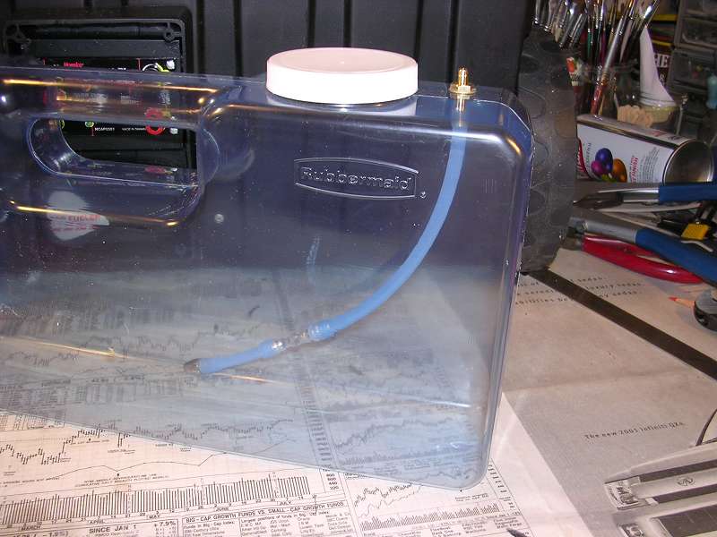

My RTV test is underway. What can I say? I have an inquiring mind and just wanna know. This is pretty scientific but I'll try to break it down for you. I put some RTV blue in a clear glass then filled the glass with Duratraxx 20% nitro fuel. I didn't want to waste my airplane fuel. Then I covered the glass with plastic wrap to keep the fuel fresh simulating the closed Rubbermaid "fuel cell". I did not use a lot of RTV. I tried to approximate how much might have come in contact with the fuel in the Rubbermaid container spigot plug. After very careful calculations, I think I have the proper amount. Good thing I have a scientific calculator... Anyway, this test may take some time. I don't know how long because I don't know how long it took for whoevers' fuel cell to cloud and get stinky. This is what scientists refer to as an "unknown variable". I will give updates as the test progresses. But be warned, breakthroughs don't happen over night... usually...

I was able to get a good seal on the holes in my Rubbermaid "fuel cell" without any goop, so this could work as a sort of "control", fuel plus Rubbermaid without RTV... Let the games begin!

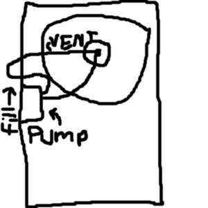

I am not using a fuel cell im using the jug the fuel comes in. Heres a pic i drew of what im planning on doing. I have a fitting that i think can fit into the dubro piece and im gonna have a piece of fuel tubing go thru a hole in the box and ill just plug the fill line into the fuel tubing from the vent ( the piece at the end of the fill line was made to slip into fuel tubing. So does this look ok?

When I was using an electric pump (before it crapped out after hardly any use... gggrrrr....), that's exactly how I did it. Worked fine for me. I did use one of those long lines that's coiled up for the actual fueling line. It's good cuz you will need some reach, but it coils back up so it's convenient. Here is a clicky:
