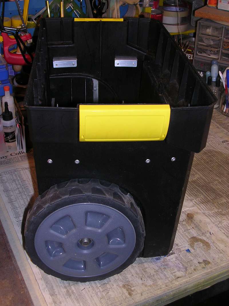

After starting on the B&D box, was wandering thru Walmart and saw this Stanley Mobile Work Center... $25...
I like the overall quality of the B&D better, but I was having problems getting everything I wanted to fit into the bottom B&D box, and the Stanley had more space in the bottom, so I snagged it and took it home...
The top section has a single internal tray, two small tool compartments on the lid, and a unique rotating parts bin. The bottom is completely open, with a tool pouch on the outside.

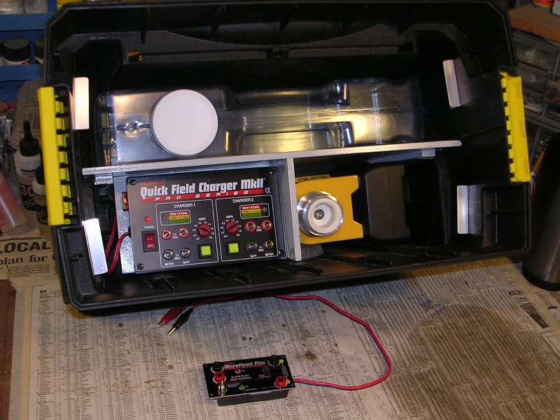

Wanted the fuel cell, battery and starter in the bottom, and wanted the quick charger inside to keep it from gettting banged up.
Found a tall, thin 1 gallon Rubbermaid jug that fit PERFECTLY, picked up some 1/4 inch hardboard and started hacking and pop riveting (What a marvelous invention! ).
Made a three-section partition for the fuel cell, battery and starter, with the charger in a separate compartment above the battery. Will have enough room to put on a false celing (floor?) for additional storage... Maybe props, voltmeter, tach... ???
Still working on padding and securing the components and the locations for the miniature power panel and fuel pump, wiring and plumbing..

Will cover the fuel cell, battery and starter with the false celing/floor, with a hinged portion for access to the starter and charger/battery compartments....
Have to go to work to make a couple of bucks to support this project - will get back to it in a couple of days
Total build time so far about 30 hours - about 10 planning (and replanning when the plan doesn't work ) and 20 measuring, cutting, building and painting...
