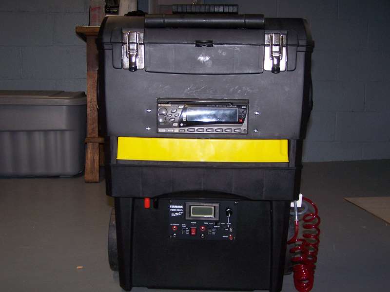

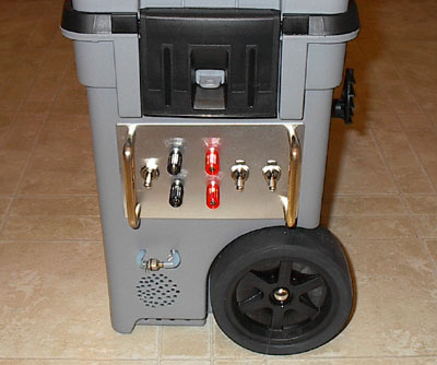

I was working on the box until 2:30am this morning and went back at it around 9:30.... installed a small fan in the bottom to vent any flammable gasses from the bottom and help keep the charger cool. I installed a tamiya connector on the fuel pump so I can completely detatch the lower tray if I need to, installed all the hot wiring. I need to get some angle aluminum I have at work to make little stops to keep the battery in place, and I also need some sort of fittings to mount to the side of the box for the fuel entry/exit. I have both a hobbico and a dubro fuel cap set but I didn't realize the "return" portion of those sets arn't like the supply with a fitting on each side of the nut, so I need to source some other fittings to finish that up.
here are some more pics:
http://img.photobucket.com/albums/v4.../fieldbox7.jpg
http://img.photobucket.com/albums/v4.../fieldbox8.jpg

well, I pretty much finished it up today. Not sure that I'm set on the fueling probe lines but its okay for now. I soldered the probe and can fitting together on the dubro cap kit to make a sealed fitting. the cap on the jug is a mobil 1 one quart oil container cap, which I decided to use because it doesn't have letters molded into it.

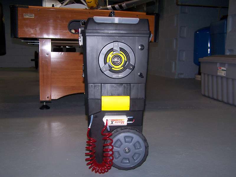

and.. here are the other pics. (edited to add pic with tail holder on side)

Box looks good but I would be concerned you would have the potiential with the fuel in the bottom of creating a bomb. If you get a fuel leak, a spark, with the fuel in the bottom you have fire.
Be careful

Saw yours previosly (sp?) I got one at Lowes $27 I am using a 1 gal paint thinner can on its side for fuel in the lower section.
Its on its side over the axle ---can't put but 3 quarts in the can to keep the level below the cap but didn't have to cut the tray.
I have a wooden partition between the can & the battery & pump on the front side to isolate fuel/ sparks.

the box is made by "MasterCart" I picked it up at Lowes.
I saw the stanley boxes with the rotating parts bin and canvas bag on the front at wal-mart and went over to lowes to see what they had instead.

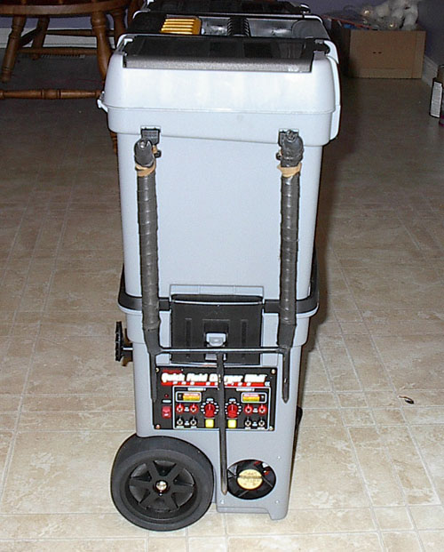

the fan is to vent any flammable vapors from the bottom of the box, and there are some holes drilled in the bottom to drain any possible misshaps. The battery is actually vented via a piece of automtoive fuel hose to the exterior of the box, which isn't shown in the pic because I didn't have a drill bit large enough at home for the hose to fit though. I think most atv/motorcycle batteries are setup with that vent system. I made those modifications after reading an article reguarding a plastic field box that had exploded causing injury to a spotter who was trying to move it off the flight line.
I have since secured the battery by riveting some pieces of angle-aluminum to the bottom of the box and I added some truck cap mounting tape to provide a snug fit.

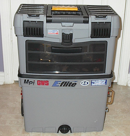

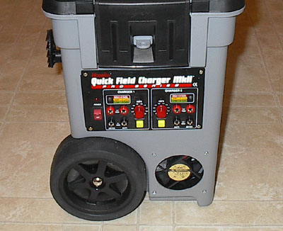

After reading every bit of this thread and being tired[sm=bananahead.gif][sm=bananahead.gif][sm=bananahead.gif], I gotta ask a couple of questions. I bought the B&D box over a year ago and am just getting started with my conversion. I made a floor for the bottom of the box out of 1/4"ply, with a 2 1/2" spacer in the front. This allows the floor to be level with the "step" on the rear of the bottom and clears the front wheel, making the floor level. Granted, I have lost some space in the bottom of the box due to the floor. Due to the issue of not wanting to lose the bottom box storage tray and having glow fuel compatibility problems with containers, I have done the following:
1) Trial fitted two 50oz Dubro glow fuel tanks that have to be more or less centered.
2) From the measurements taken, I have room for a Kavan brass geared electric pump on the right side of the fuel tanks.
3) Ditto for the Hobbico 12V battery on the left side.
4) Power panel to be mounted on the left front of the lower box, fuel dots for the fill and vent to be located on the right front of the lower box.
Questions and Opinions required:
1) With the fuel tanks being mounted side to side, will fuel draw from both tanks?? (Refer to page 14 posts 403 & 404).
2) With proper venting through the bottom of the box, do I need to be concered about any explosion or fire hazard with the fuel and electrics being in the same compartment??
Comments are most appreciated.
