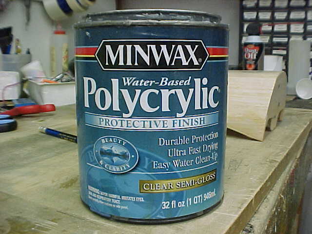

........WhaT type of fiberglassing resin did you guys use?................
I use Minwax water based polyurethane. It's one heck of a lot less trouble than resins or epoxies, not to mention less smell. Get it at Lowes/Home Depot, etc. I've used it on my Herk, the OV-10, and am in the process of glassing the B-24 with it.
Randy
Randy
#753
How many coats do you give it and how easy is it to sand??
======I usually end up with probably 3 coats. I had read about using this before, but was afraid to try it until I talked to a guy in our club who is an outstanding builder. He told me about it and sold me on the stuff. I'm using 3/4oz cloth. Basically you just lay on the cloth and brush on the poly to adhere the cloth to the structure. In the case of a rudder, you would do one side, let it dry and sand off the glass overhang around the edges, then do the other side. After a piece is done, it can be lightly sanded to get off any bumps, then add additional coats of poly to suit. I may hold back a little on the rear of the fuse, such as the underside of the stab, just for weight considerations. The poly sands really good.
Anyway, I then put on a thin coat of primer to show what needs filling, then add panel line tape if you're going to, then more primer. I remove the panel line tape before the color coat goes on.
I primed with Advance Auto "Plasti Cote" automotive primer. Actually, you can probably lay off the coats of poly and go for more primer coats if you wanted.

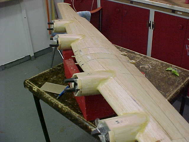

So far this evening, I've glassed the bottom of the B-24 wing, nacelles, rudders, elevators, flaps, horizontal stab, and am waiting for them to dry. I'll go back in about half hour and do the other sides.

I'd have to say this is my least favorite part and I want to get it over with soon as possible. I think I will pick up a can of poly and try it on the ailerons and see how it does. Tomorrow I will glue the stab on and hit it with the primer. What a pain trying to get the stab to fit was. I read all the posts about it and studied the pics off and on for about 2hrs. I think it fits pretty well now. After that I will start cleaning the mold lines up and prime the fuse.

Doing small parts first is a good idea to get a feel for using the poly. I think I'm just barely going to have enough glass to finish. I got 3 sq. yds. thinking that would be plenty, but I'm now down to using scraps to cover hatches, etc. But, I could not even imagine trying to monokote this bird. In my about 20 years of doing this, that's one thing I've never gotten particularly good at. But I can sure appreciate some of the jobs these guys do with monokote or iron ons in general.
Oh yes, while you're getting the poly, get some of the cheap disposable brushes to apply the stuff with.

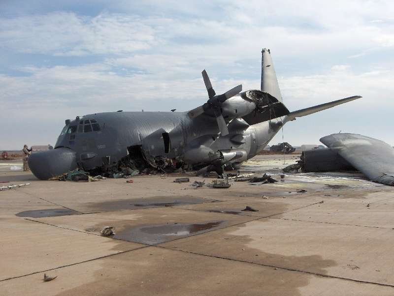

I love C-130's also. I thought I would share this with you
Dave

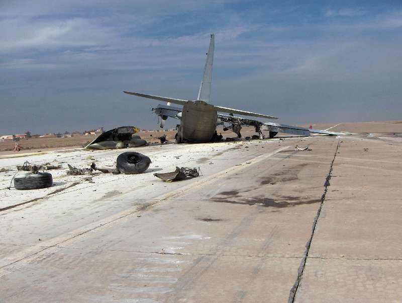

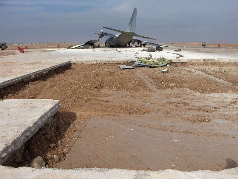

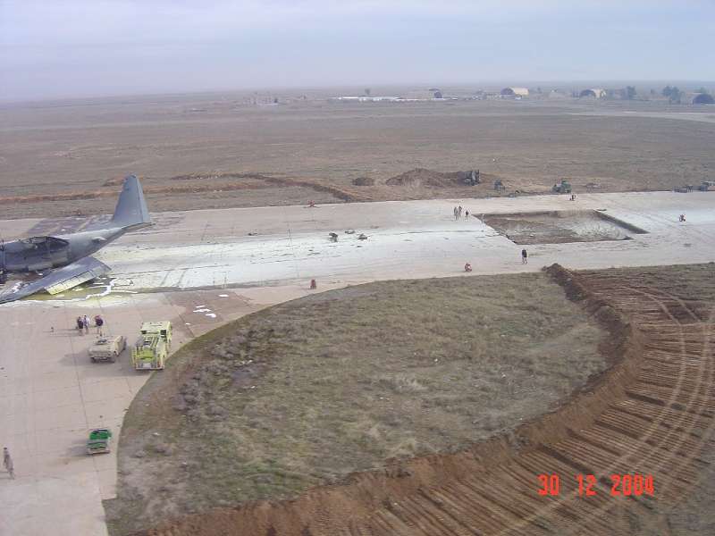

Here's what happens when you don't properly "NOTAM" an airfield under construction.
A lack of communication over in Iraq.
Last week one C-23 Sherpa flew into a US operated airfield in Iraq during the day and saw there was construction equipment on the runway.
Yet there was no NOTAM (notice to airmen). A trench was being dug in the runway, and it was not marked. Its a long runway and they just landed beyond the construction. They filed a safety hazard report that was immediately forwarded to headquarters and the
Air Force wing based here.
Well, it seems the construction continued and still was not marked or NOTAMed. As a result, an unwarned MC-130H landed on the runway the night of the 29th. It wound up going through what is now a large pit on the runway. A few pictures are attached. The MC-130H was totaled. There were several injuries to the crew and the few passengers that were on board but luckily nobody was killed. Quite the set of failures somewhere in the system regarding this improper construction and no notifications about it.

Well I looked for a water based polyurethane today and was only able to find some minwax stuff called polycrylic. Was this what you were refering to? I asked the guy who worked there for minwax water based polyurethane and he said this is the only stuff that he knows is water based. So far it seems this stuff has little to no smell and would be nice if this is it!

Randy have you tried putting baby powder in with the polycoate on the second coat? I have done that a lot , it helps fill the weave in the cloth, sands easy and smells good too. The B 24 is looking good. Rich

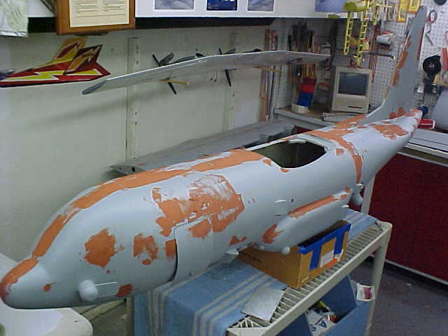

So far I think the polycrylic is working fine. Its alot easier to sand right through the cloth compared to poly resin so you have to be extra careful.
I never noticed anything wrong with the rudder but I didnt match it up to the plan either because nothing on the plans seem to be the right size anyway. I knew it would be hard to get the slope on the top to match so I just cut an extra 1/2 inch off and had a bigger block to work with.
My tail is done and ready for priming and the ailerons are drying but I can go no further until I get the wing tubes so I can match wing sections up and finish sanding. Now I have to make a decision on which paint I will go with. Is there anything that DOESNT work with the polycrylic?
Just today I fit the two fuse sections together and found out this thing is bigger then I thought, wow. I dont know how I am going to fit this in my 182 unless I take the back seat out and fully recline the front right seat. I also found out that it wants to sit on its tail and I pretty much have everything up front already and I dont even have the horizontal stab on yet. I tried putting the wing center section on and it didnt make a difference. Hopefully the wing with engines a little farther forward will set the nose down. I know my measurements are right as far as the main wheel placement goes.

A4 On the polycrilic I use automotive Laquer primer and it works fine. I haven't found anything that will bother the polycrilic. I have been useing it for about 4 years. It is real userfrendly. Tha only problem is on thin balsa sheting 1/16 th. it will buckel the balsa beings it is water base.
On a sheated foam wing you don't have to worry about it.
If I am building a build up fus and wing and it gets thin, I will use Laquer sanding sealer to put the cloth down. Then put a coat of the polycoat on. It won't buckle the wood then. Rich

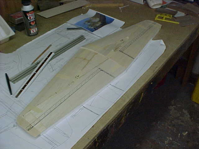

Welcome, Tommy D. You'll enjoy building the Herk. First thing, get a couple copies made of the plans. I cut up a couple cutting out bulkhead patterns, etc.
As far as hinging, if I am tapering the elevator in the center, I draw a centerline on the elevator, cut the hinge slots, and then taper it to the centerline. I find it easier to put the slots in before tapering.
Here's a pic of my stab when it was laid out to cut out the elevtors. The wide mark in front is what is cut out and replaced with the stab trailing edge and elevator leading edge. I'm pretty sure I used what the plan called for.
Pin holes in the fuse! Mine took quite a bit of putty to fill. I was told later by the auto body instructor at school that they make a polyester filler for fiberglass that doesn't shrink like putty and is lighter and easier to sand, but I haven't tried it.
Randy

Oh Randy, what is the lighter non shrink stuff called? If it is glazing putty, well I am using it
I just went back and read your last post. To clarify, did your taper your elevators in the center or taper it like the plans show?
Bill
